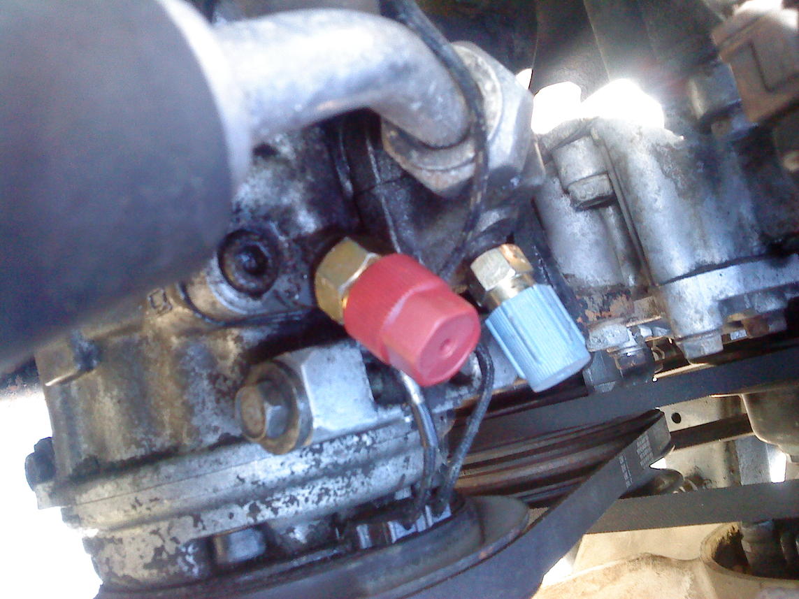

Just converted my r12 to r134 works ok I'm happy with it. My mechanic is awsome a real McGyver. After determining that every thing was working correctly he had me go to Kraigens and get the conversion kit that consisted basically of 2 new brass adapter fittings for recharging the system with r134 (see the picture). So here's the thing, he only recharged the system 80% because the r134 works at higher pressure (I think that is due to a higher boiling point), so now the system is about 20% less efficient and only works well when the truck is moving. I think that I am going to install a ford electric fan and some fillers in between the radiator and the condenser to improve air flow.
