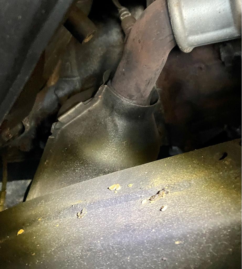

So I got a pipe cleaner about 5ish inches inside the tube and then I couldn't get it to go any farther and didn't want to poke a hole in anything. The first 3/8" came out pretty brown so hopefully it loosens something up in there.
If it was plugged up, water should have come out along with whatever was gunked up in there.
Did you have the metal elbow piece in the drain or was it just the rubber nipple on the firewall? I had this issue in my 4th gen and jammed a metal rod in the thing and moved it back and forth until "stuff" came out.
Just the rubber nipple that comes through the firewall. Should i be pushong something more substantial through it than a pipe cleaner?
Thanks for the tip. Tried poking around and some dark brown debris chunks fell out. Will test tomorrow to see if that solved the issue.
