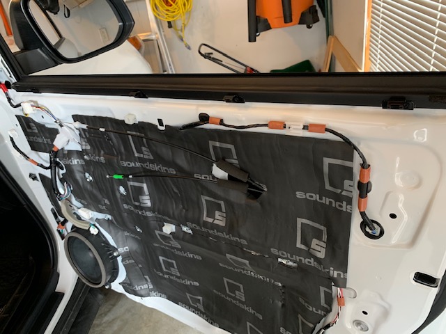

Very helpful description. From the pictures, it looks like there may be room in the doors to install additional storage areas.
There MAY be room in the doors for additional storage, however, realize:
1. The window is UP in these pics. It needs room to move down
2. The holes in the doors are designed to give access to the window and door actuators as well as door handle, etc. Any extra storage would need to consider the ability to continue to have this access.

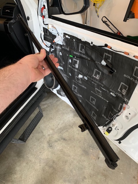

I got mine done today. It took 5 hours to do all the doors and the rear hatch with 80mil Kilmat. IMO a very worthwhile project. Had I remembered that we have a db meter at work, I would have done some before/after testing, but the butt dyno says it's a little quieter going down the road. The big deal is that the doors sound solid now, which was my initial motivation for doing this. Since I only used 2/3 of the 36 sqft, I'll add some to the rear panels and wheel wells eventually.

There is absolutely no advantage to trying to use 1 whole sheet or just a few really large pieces. No one sees behind the door panel and it doesn't make a difference in sound reduction. This product is mainly to reduce vibrations. Using a full sheet is far more important when installing Mass Loaded Vinyl as this is where the most sound reduction will come from.
Make sure to thoroughly clean the inside of the door with isopropyl alcohol.
Not cleaning all of the vapor barrier adhesive will have no affect on the adhesion of the CDL

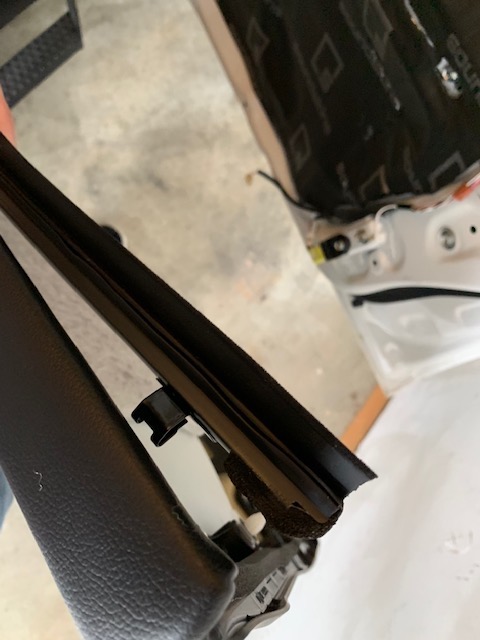

When pulling off the door panel, pull straight out from the window, not up. There is a bar that fits into the window channel that has clips that the door panel click into. Makes it 100 times easier to reinstall.
Agree with all points. I want to call our your last point in particular so everyone is sure to see it.
When you pull off the panel, there is a bar that fits into the window channel that will pull off with the panel, and that is fine. However, it will save significant frustration and swearing if you pull this bar off the panel and re-install it separately from the panel, itself. Be aware, you need to use a fair amount of force to pull off the bar. Just pull straight out and you will be fine. Below are some pics of the bar attached, unattached, and re-installed on the door, before the panel. Once you have the bar reinstalled, all you have to do is push the panel straight onto the door. All the clips will click in place.
