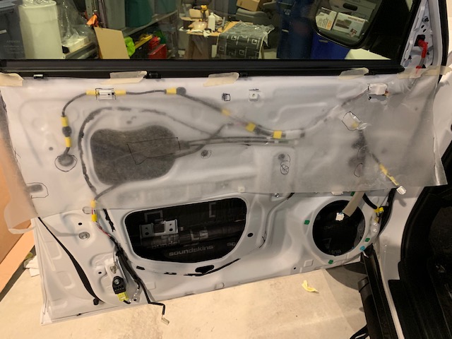

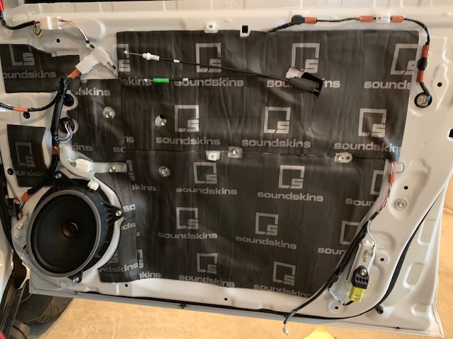

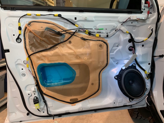

1. Using a large single sheet of sound deadening material on the inner skin (metal that the trim panel hooks to) looks cool but is a giant, time consuming, pain to accurately cut. You'll end up needing two pieces anyway if using the SoundSkins Pro roll due to the 4runner door size. Listening to the online videos, it seems simple enough: make a template/tracing on paper or semi-transparent tape, and then cut the sound deadening material to match. Per online suggestions I tried using carpet protection sheeting (tape) - too sticky to get laid out without crinkles / make a good trace. If you had a second person to help you layout the tape tie might work better. I also tried wax paper with some success, but still had some issues with alignment. When I moved to the passenger door I used several pieces on the interior skin, it doesn't look as nice as a full sheet, but it looks pretty good AND is infinitely easier to work with and quicker. Below I've posted a picture of the completed passenger door - two larger pieces to cover the two larger holes in the door panel. several small pieces to fill in around bolts, speaker, etc. If I have one piece of advice, it's to use multiple pieces.
2. Look carefully at your door and the backside of the trim panel prior to starting to apply material to the inside skin. I made a mistake on the first door of covering a couple of holes for trim clips and I went way to high up on the door with material (1/2 inch from the window). This resulted in me pulling off material to get the door panel back on and really pissing me off because it looked like crap after all my work to use one larger sheet on the driver side.

4. The adhesive Toyota uses to hold the factory plastic sheeting on over the holes is the devil. In a perfect world, all the material should be taken off, but after far too much time trying I just left some on there and sound deadened over it. Not ideal, but I'm expecting / hoping it won't cause major issues.

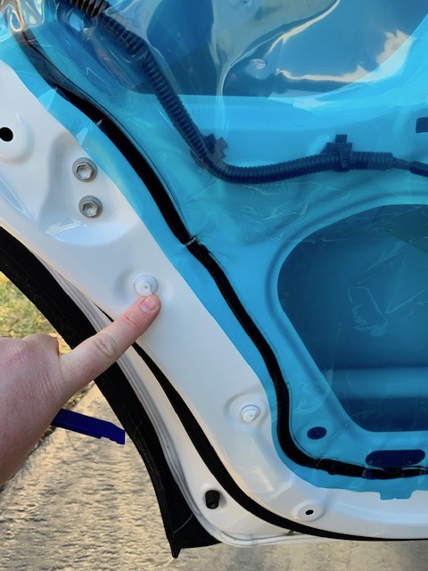

5. The piece of styrofoam held in place with two bolts inside the door is also adhered with foam tape to the outer skin. It can be removed by working it back and forth and pulling it back towards yourself/up. Removing the foam adhesive is also a pain, but not as bad as the devil adhesive above.

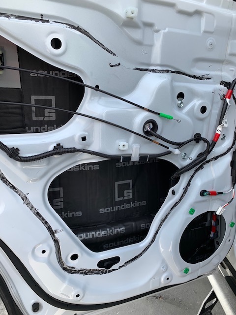

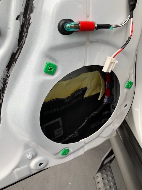

6. When cutting pieces for the outer skin (inside the door), I found it easiest to do five pieces: two pieces going from the bottom of the door up to the cylindrical support bar (meet in the middle of the door), two pieces above the support bar, but in this case I ran pieces the entire width of the door, about 10" high. for the top strip I stopped at the edge of the door handle assembly. Finally, one piece wrapped around the support bar.

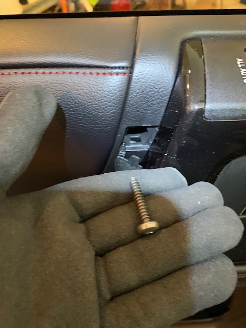

9. When prying off the small square access point on the trim to access the screw, use your screwdriver and put it in the corner, not the middle. It will pop off easier. You can see in the pic below I scratched the trim panel a bit when I tried to put the screw driver in the middle. Still pissed at myself for that one.
10. Make sure all clips are in the trim panel (not in the door) before trying to re-install the trim panel onto the door.

After the front two doors I’ve used about 2.75 rolls. Admittedly, I wasted a bit on the first door. I expect the four doors, plus the hatch will take about 6 rolls. This is in line with what the soundskins web site states- one roll for each sedan sized door, doing both inner and outer door skins, knowing our doors are bigger. I’ll update this thread with actual material usage.

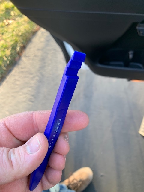

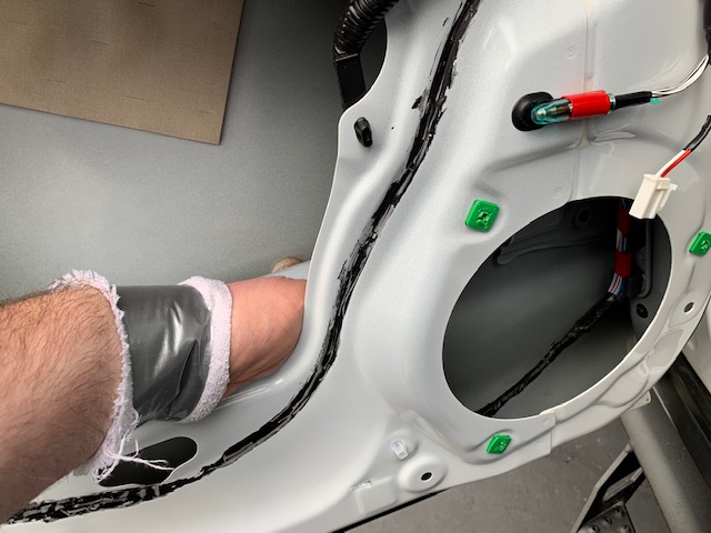

1. The super thin panel tool is THE tool you need to use (pics below) this thing is perfect for getting out the square screw cover I scratched in on the driver side door. Additionally, it's good for scraping off the black devil adhesive that holds the factory plastic on.
2. Don't get over confident after the front panels and start just pulling off the panel like you're starting a lawn mower. I partially broke a couple clips by pulling too fast/hard (pics below). Luckily they still function. You can pull hard, but think of it as pulling just that one clip out, then slide your hand over and pull out the next one and so forth. You'll probably get a couple, and that's cool. Where I had an issue was pulling like the whole panel was going to come off at once.

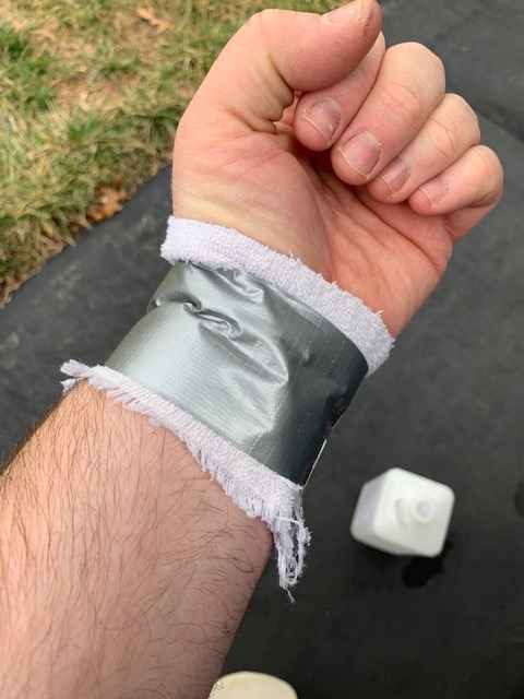

3. The duct tape wrist bands worked well for protecting my wrists.

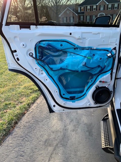

4. The combination of hole opening and door size make the back doors tighter to work in and harder to put material inside of (outer skin) than the front doors.
