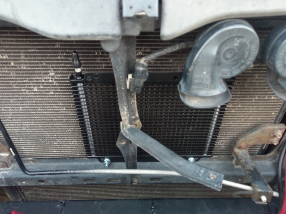

I went full Amsoil synthetic so Im not worried about the fluid getting too cool, but my transmission only gets up to about 135* now with my cooler installed.

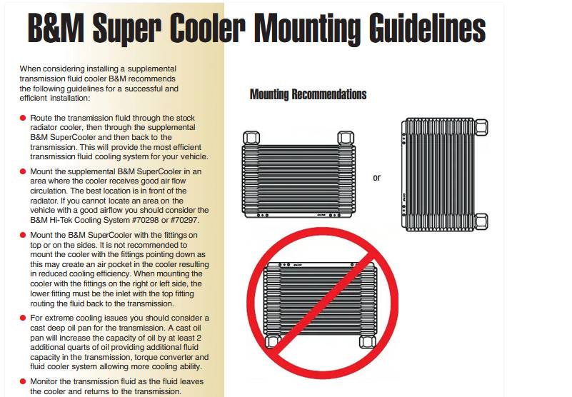

Thanks for the input. Will order some ATF WS fluid and probably do a drain and fill or two while under there. I am familiar with the temperature fluid level check so will follow that procedure. As for the orientation, according to B&M upright is ok, down is not recommended. The upright position makes for a very solid install without any extra brackets by drilling three holes. Very cold weather is not a big concern in the Southwest.

The instructions image shown in post #10 above contradicts that. The 3rd red bullet point says the inlet should be at the bottom in a sideways mount. Perhaps that orientation is specific to that model but that’s where the info came from about which goes where.
Actually, inlet (HOT) is up top, and return (COLD) is on the bottom. This is the principle radiators. As fluid cools it condenses and settles. If the nipples are top, it doesn't really matter.
I agree that is how radiators work. But like others pointed out, transmission coolers are evidently different. I saw it in the instructions posted above but I'd also heard it somewhere else previously. Not sure why.
