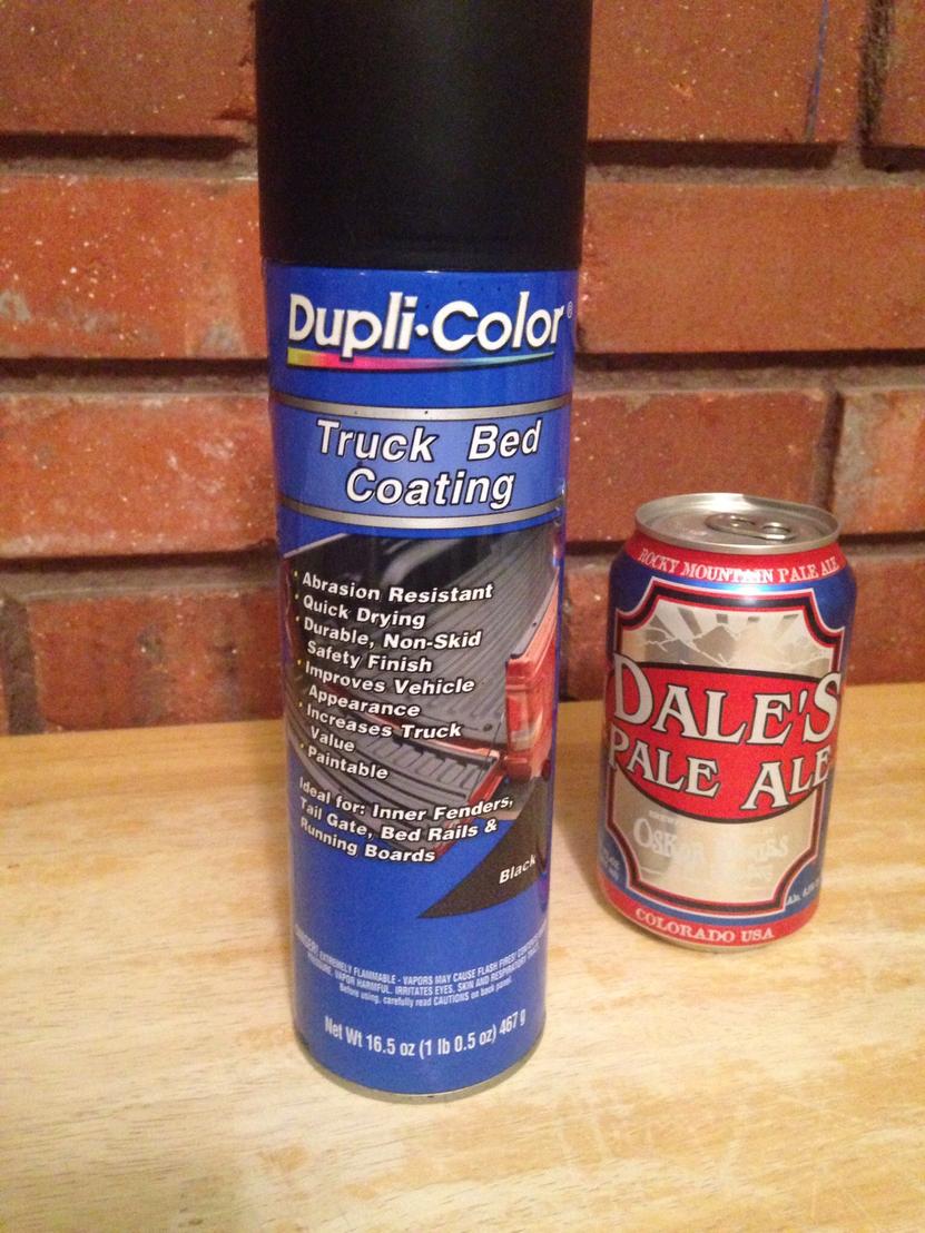

I honestly don't know the answer to the clear coat part of your question. I would guess yes unless the sun fades the bed liner (even if the clear coat resists UV yellowing).
What I do know is this: Duplicolor makes two bed liner products in spray cans - you want the black top / blue can product. It has minimal texture compared to he other Duplicolor option and is much better quality than Rustoleum and others that I have experimented with.
Since it has less texture, it's not as "grabby" to road dirt like others. When applying, you may get heavy drops here or there (especially at the end of the can). They can easily be knocked flat by gently touching with your fingertip when wet.
My last bumper was rattle canned with satin black despite already being black from the bed liner. It provided a better finish look which further minimized the texture of the liner and was easy to keep clean with a quick hose down. I never tried dusting off dirt dry though.

Also, GVL, I'll have mine hopefully installed in 2 wks. I'll see how well it wipes down with a dry towel and let you know. I'll also post up some close up pics so you can see what the finish is like.
Yes, please do. I really don't want a super rough finish so like the sound of the texture you described and would like to see your rig with the new hardware as well.
