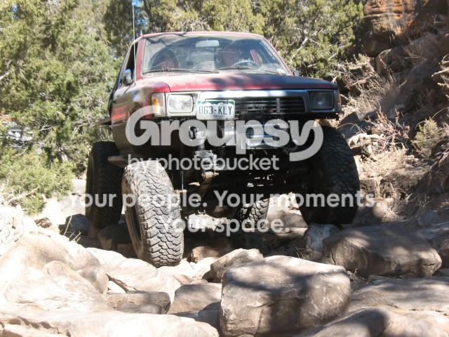

Pics from our Liberty run yesterday. Perfect weather. Randy made it out too.

Then Jerry broke! Sorry Jerry.
~original[/IMG]
~original[/IMG]
all these sick trucks and all I can think of is.................
...cute chick in the 1st gen?! :hungry:
hahahahaha great shots man...looks like a serious pack of some pretty legit trucks
