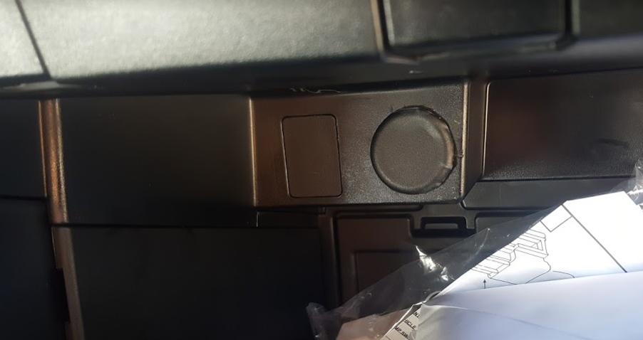

On my 17' I was looking to wire my Dash cam into the glove box but the circle and square things won't budge. What exactly are they there for? Do I just need to pry it out? Is there a USB/Cigarette adapter already in the glove box?
I doubt they're hiding something that's already there but that's exactly what those openings are for. Some models (my SR5 Premium for example) have USB in the rectangular opening and 12v in the round. The round one sure looks like it would pry off but you probably have to cut the rectangular one.

Prior to 2014, they USB hub and DC outlet were in the glove box. They relocated them to the center console and made plugs for the existing holes.
Long story short it's much more cost effective to create plugs than it is to change the tooling to make the dashboard.

On the 2016 and newer (maybe other years too), that plastic thing in the glove box that has the rectangular and circular caps is where the USB and 12v "cig lighter" plugs were in earlier models. Later models have relocated those plugs to the center stack. There's nothing behind those caps in the glove box. You can pry the rectangular cap off. Not sure about the circular one. It's easier to get the cap off by removing the "trap door" adjacent to those caps. You can reach your hand in the trap door and pop the rectangular cap out from the backside.

As opposed to others comments that transferring USB & Plug to the glove box being a "20 minute job" it was not for me. Maybe... if they had taken everything apart prior to this it would have been but if you have never been into the dash before count on taking your time and spending it patiently prying and trying, but be patient. I found plenty of YouTube vids on taking apart the center stack and that was important for moving the wires but in my '17 I still had to do some splicing on the cig lighter wires. The USB port DID have enough wiring to move around to the other hole, but I had to disconnect the holding clips at more than one place and reroute it after pulling the radio head unit out of the way. I was grateful for that as I did not want to splice that many wires into a homemade harness and hope that I did it correct given that there were data wires too.
Long story short, just transferring the components is NOT a quick and easy job.
There is no extra data port to plug into behind the square or round hole in the glove box like you asked.
If you want USB in the glove box, that has data to the head unit you will have to give up the center stack one and reroute it.

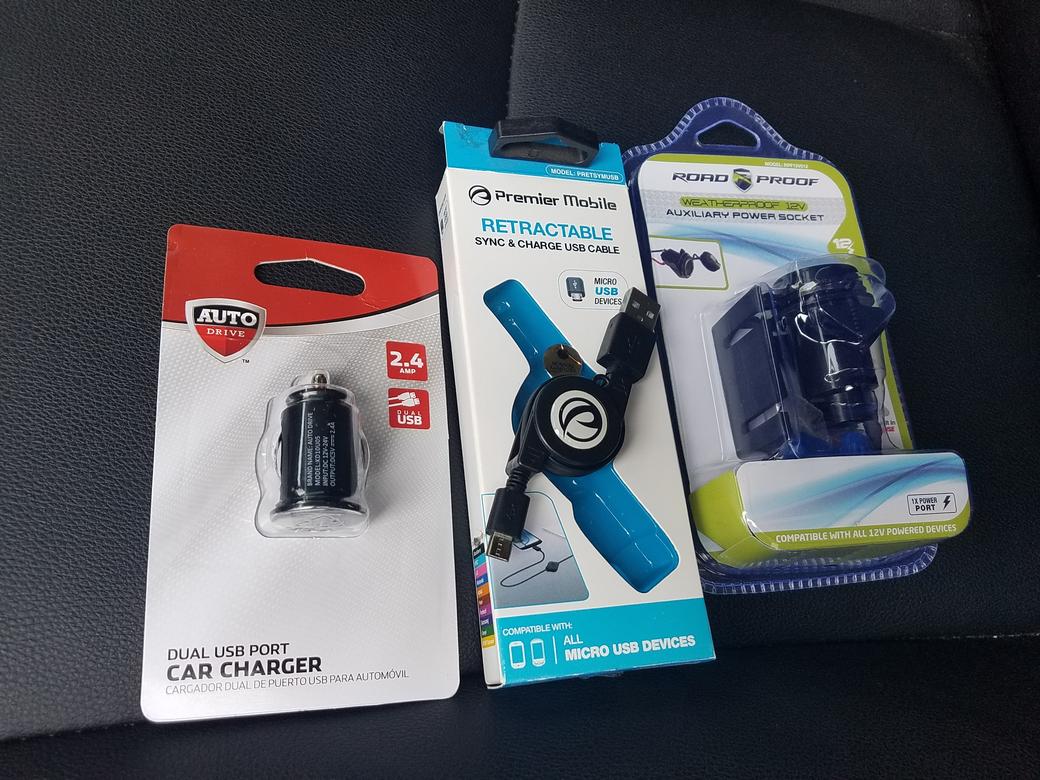

If you want USB in the glove box I would suggest picking up the parts in the attached picture below and punching a new hole into the side access panel that pops out (not the filter one in the rear) and placing the new hole.
Where you will find power to tap into... I'd say tap the present cig lighter wires... but that is only powered if you have the key on. I would not know where to begin to find full time hot on that side of the truck (but I am sure someone here does) other than the "right" way by sending a dedicated home run to your thermal fused hot fuse block next to the battery.
There is NO easy way to pop the round or square blanks BUT... if you take apart the lower half of your center stack first you will see exactly what you are up against by looking close at the round and square actual USB and cig lighter inserts... this will show you where to do your prying.
Hope this helps you out a bit...
Edit: I did not realize the retractable was in this photo... you won't need that. I got that because I also put this set up to the left of my steering column to power my phone hanging to the right of my A pillar in a nice and neat way. Don't forget to send some pictures when you get done!
