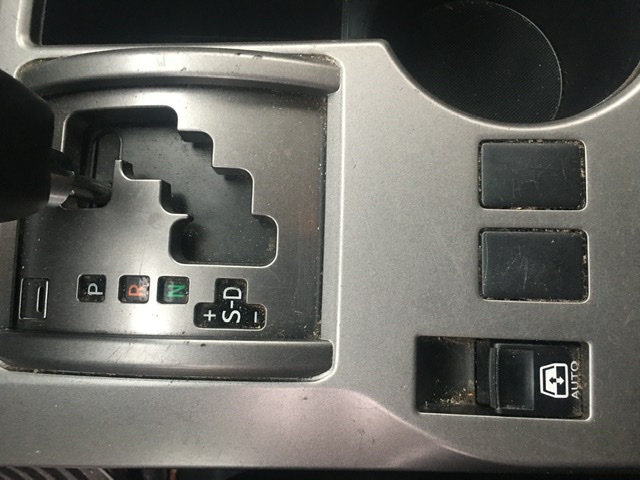

I have two blank spots in my center console right behind the shifter, approx. 1"x 2". I would like to add two dual USB chargers side by side, no audio involved. These would be able to take care of the front passenger and rear seats. Has anyone done this yet? Searched the forums with no luck.
This is the area, trying to find a port that size.

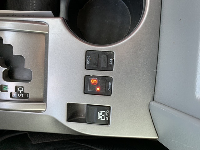

Just remove the blanks lol nothing special
BTW the photo distorted the reading on the voltmeter. It measures pretty close to what my voltmeter in the rear indicates. You’ll also want to add covers to the USB ports so you don’t build up dust and junk in them.

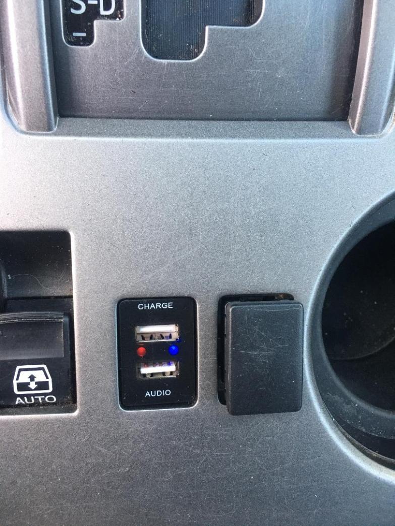

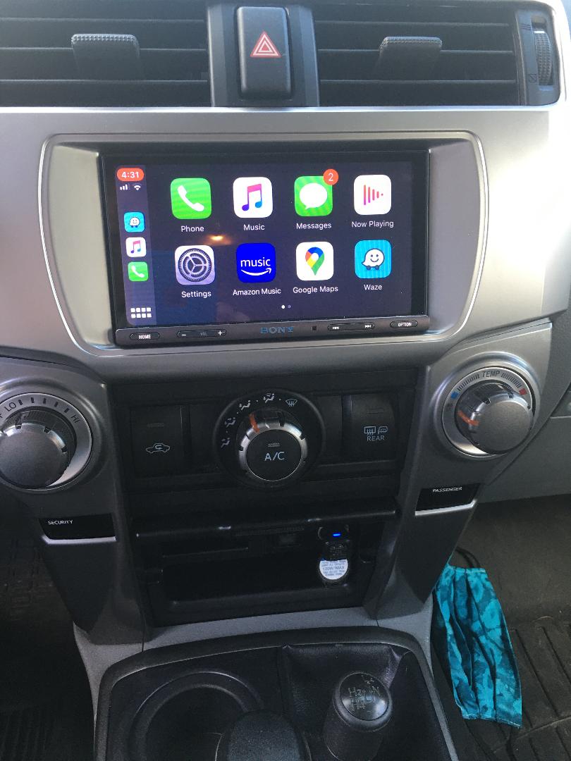

Thanks to blksubykid I was able to get the correct usb/audio port for that blank space. After consideration, I am going to add the same port in the next slot because the Sony XAV-AX-5000 head unit I installed has two USB audio inputs, one for Apple Car Play, the other for Android Audio, they still work as chargers as well. Below is the link to the correct unit. Amazon.com: Cllena High Speed Dual Port USB Car Charger with Audio Socket for Toyota Series,USB Charging for iPhone, iPad, Samsung and More (3.3A + Audio)

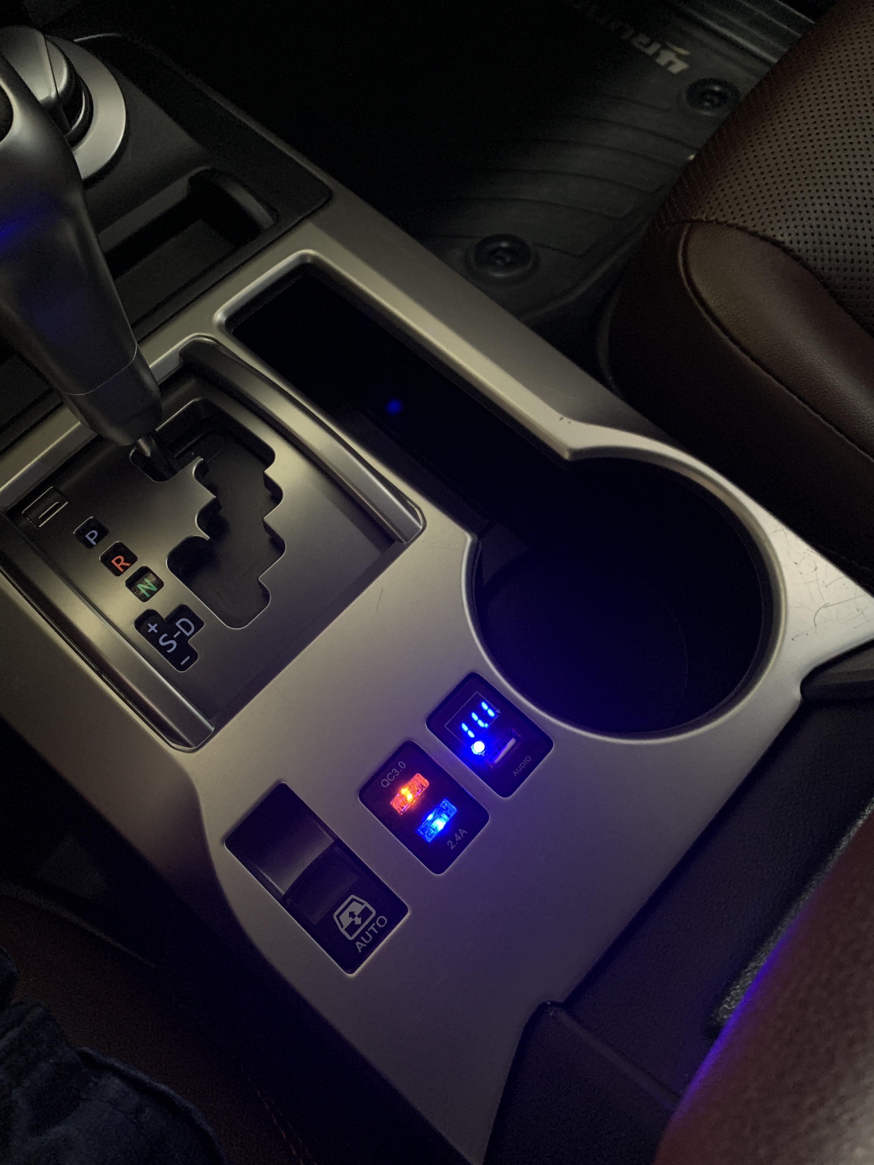

Air on Board is a perfect fit. Switched out one of the 2nd row sockets and one on the driver side dash.
