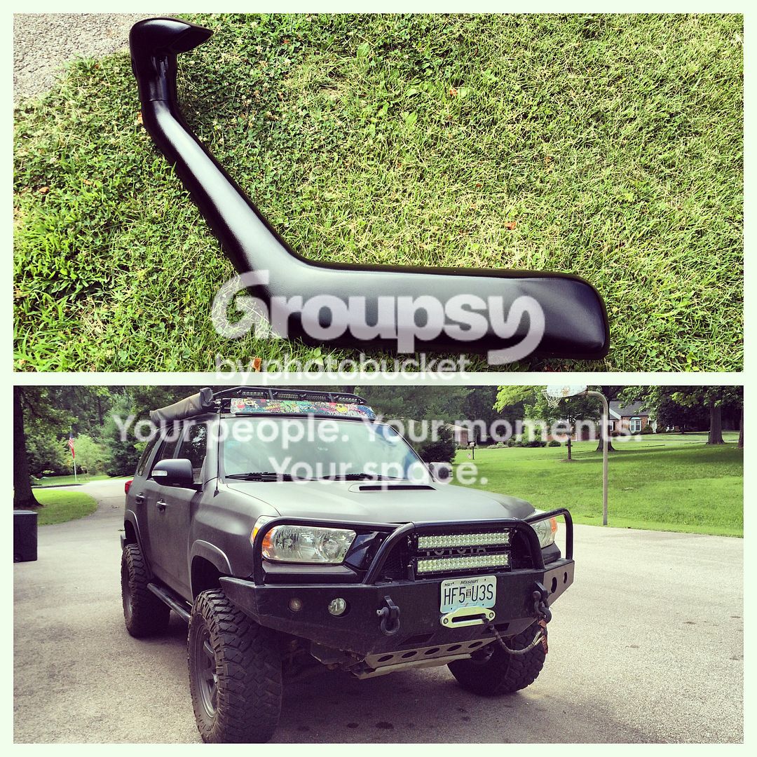

*Little teaser*
Got my FTS snorkel today from [MENTION=64685]TOY2G[/MENTION], thanks again Nathan for putting the GB together!!! Mine came damage free, the box was a little banged up but everything inside was intact. I have an appointment to get the outside line-x'ed on Saturday, going to be drilling the hole next Friday!
Sorry for the crappy instagram pic lol.

Looks like you got yours first, sweet, glad we could all come together to make this happen and get a decent deal on these.
I cannot wait to see it on some more vehicles. They have emailed me several time about becoming a distributor, but until these things have a little mor history, I gotta hold off.
I will say, they are far easier to deal with than my Chineese and Russian suppliers.
So I went to my local Line-X dealer and they refused to do the job. I asked if they could do everything but the backside of the snorkel & they said no. Basically for small things like that, they use a mold, forgot what the actual term was, but its basically a glove of line x.
Think I might just do several coats of plastidip for now. :confused:
