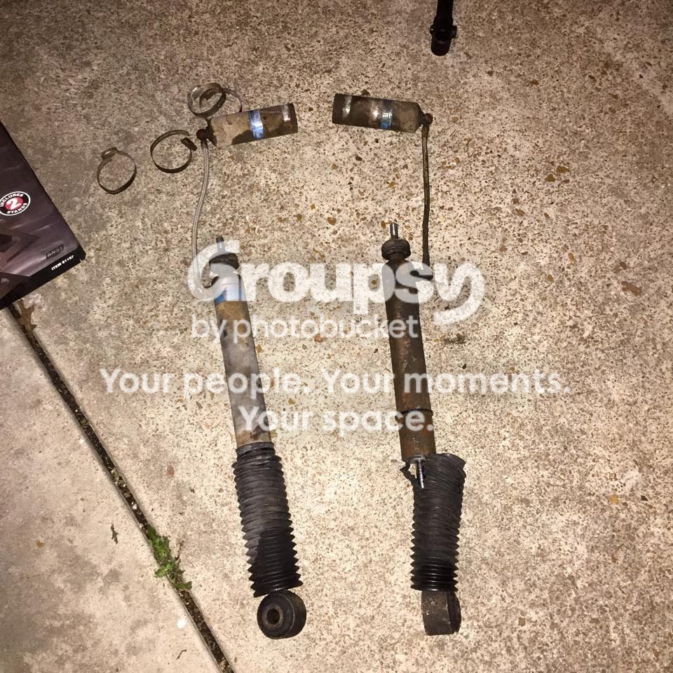

-Replaced my shatty bilstein 5160s after a fight with toytec/bilstein, decided to go with Metaltech Icon 2.0 LT shocks with MT LT progressive springs. I like this setup, but I like the ride a bit better of my old 896s.

How many miles did you put on those 5160s?
Those were my 3rd set. Probably got about 20k out of each set. Word of caution, get extended bump stops if you want to run those 5160s. Toytec stopped honoring my warranty after the guy that I had been working with left after the 3rd year. Told me to talk to Bilstein and they were saying it was installed incorrectly, which is BS.

I had inquired about getting bumpstops along with these but almost everyone said I didn't need them. Which one did u go with?

I never had bumpstops on while I had the 5160s on, which was my first mistake. I put them through the ringer, very harsh desert bombing in utah & very flexy off cambered rock crawling & the shocks kept bottoming out and spewing oil. I would get either a 2" or 3" metaltech bumpstop, I have the 3" right now with my icons.
