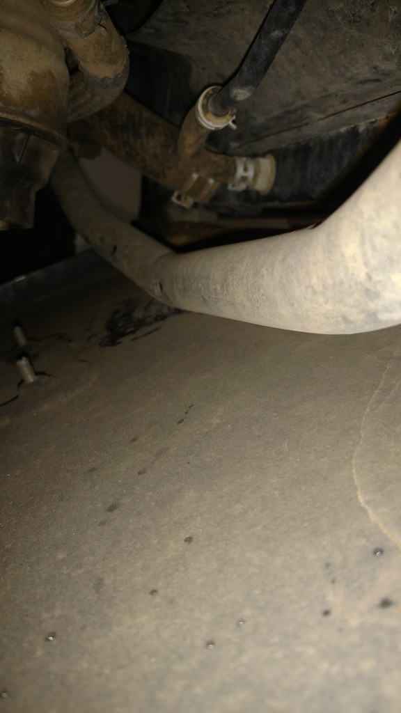

After getting a Icon Stage 6 suspension on my 2010 Limited, and recently loosing the "spacer" that was my RCI bash-plate, because I had a CBI front bumper installed, my front stabilizer bar makes contact with the front skid-plate.
It looks like I can create clearance by installing longer stabilizer bar links and pushing the rears (by the wheels) down, so that the curve between the frame rails gets rotated upward.

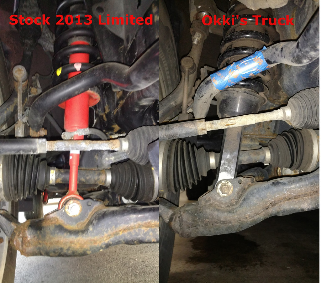

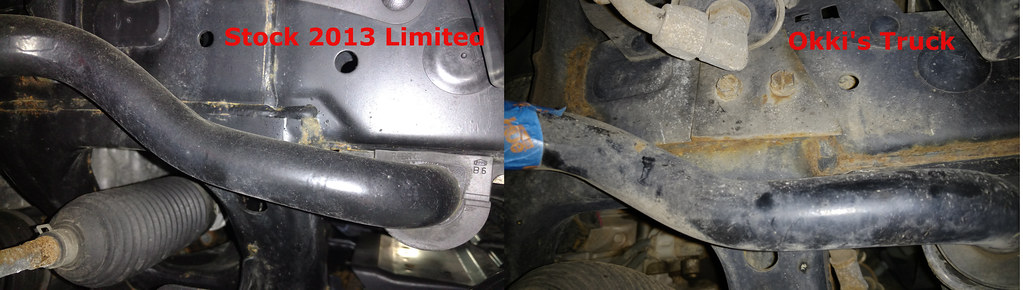

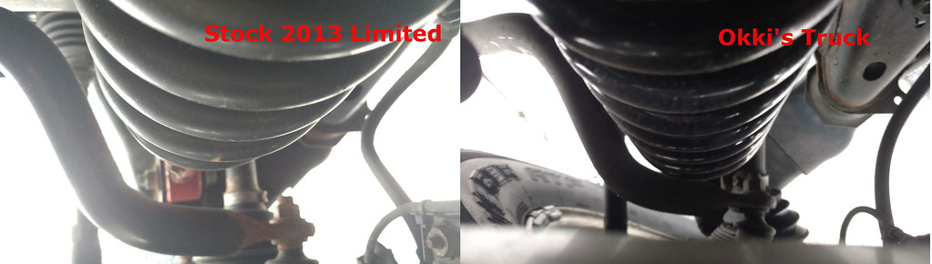

I managed to grab some comparison photos from a stock 2013 Limited at a local dealership. Based on what I'm seeing, I should SHORTEN the front links in order to have the sway-bar in the same position as stock (slightly upward at the coilover). I am already running the spacer that Icon provides in order to lower the bushing by 3/4 inch to keep it closer to the stock angle.
By rotating the ends UP, the curve around the coil will move up and forward, eventually creating more clearance. The droop in the center of the swaybar will rotate down initially towards the back of the truck. Because of the downward angle of the front skidplate, it will create more clearance eventually.
Thoughts anyone? ( [MENTION=98153]MStudt[/MENTION])
Has anyone with a lift shortened their front links?

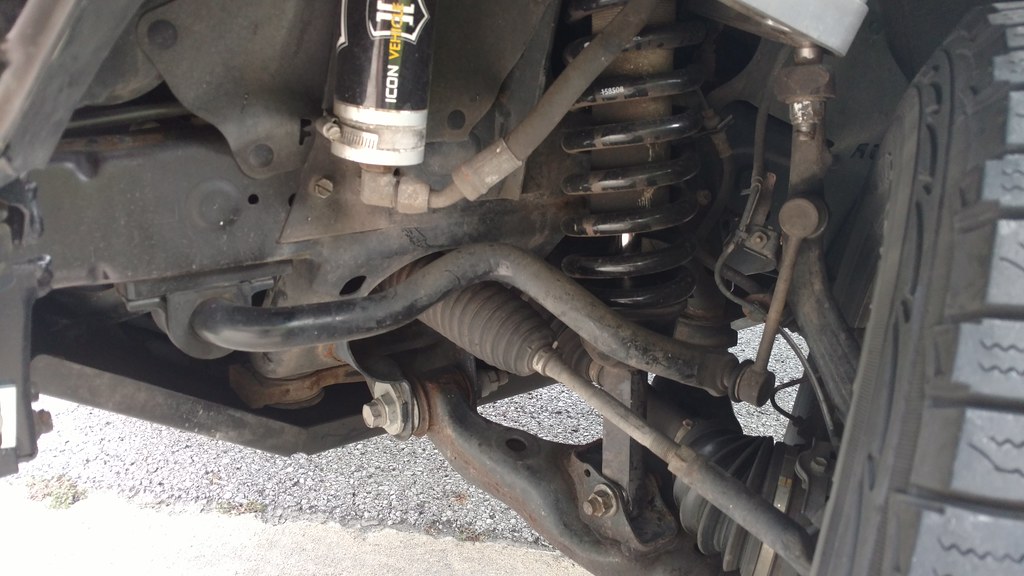

Spacer:
Overview (full outside lock on driver side):
Skid Clearance (viewed from passenger side):

@Okki, take a look at the 4th Gen sway bar. It has a flat section in that area that was changed to full round on the 5th gen. I'm running the 4th gen bar, only because my son and I both pulled our bars for a run and when we put them back on we accidentally got them swapped. I'll go out side and snap a photo as soon as it stops raining to verify exactly where the flat spot is to see if it will solve your problem.
EDIT:
Never mind. The flat section is after the first bend after the bushing, not after the second bend near the end of the bar. It won't help.

Going to tape an old phone under there and try to get some video of the bar moving as I pull onto the curb in front of my house (poor man's go-pro).
It's hard to definitively determine where the noise is coming from while driving. Also not sure if it's speed/terrain driven.
Will do the same thing with the rear sway bar.
I also put some painters tape on the bar to see if it gets craped off anywhere that might indicate a point of contact.
Would like to understand the issue before throwing money at solutions that may not be needed or won't fix the issue (if there is one)

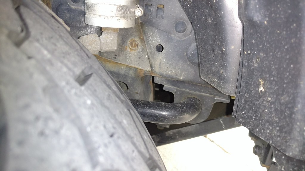

Sorry to bump an old thread but I'm having an issue with my sway bar contacting my driver side radiator support bracket.
For some details, I'm using a sway bar relocation bracket, to move the sway bar mounts down and forward, as well as spacers under my radiator support brackets to drop them down. That said though, because the radiator brackets are offset to the passenger side and not centered on the truck my left bracket and the sway bar are rubbing.
My proposed solution would be to find longer endlinks which will rotate the center section of the sway bar up and hopefully create enough clearance to stop the rubbing with the radiator bracket.
