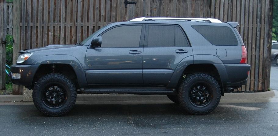

Quick question for anyone with the Toytec Ultimate. What is the number of threads that you see on your shocks?? The reason I ask is that it appears somehow my front is around 1/4-1/2" higher than the rear - and I don't think the installer messed with the coilvers. As you can see in the pic......it makes a heck of a difference. With my lift and new tires, I am about 40 1/4" from ground to wheel-well in the front. I obviously need to adjust, and wonder how much of a difference everyone has between the front and rear of their trucks.

one thing about the toytec COs is they dont start at 0 lift like some others, but give a minimum of 1 in. & come set at a 2 1/2 - 3 in. lift from the factory. i had to crank them down before installing them. heres what they look like at 2 in. front lift. u sure ur front sits at 40 1/2? i took measurments before & after, mine went from about 34 to 36, & i have only 1/2 in. thread showing, the rear sits at 37 1/4. maybe cause mines an 06.
okay since its been a little over 3 months, what are ur measurement for front and rear being that it had pleanty of time to settle.. CANT WAIT TO GET MY WHEELS SO I CAN PUT THIS LIFT ON NEXT FRIDAY!!! :banana:
