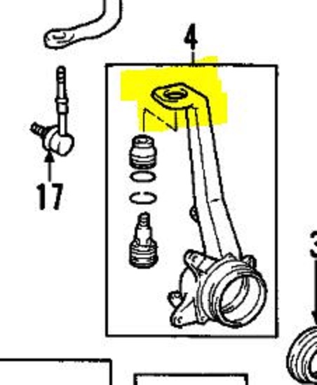

what causes the failure of the spindles?
Age. Metal fatigue. Combine this with over-sized tires, more weight, lifted suspension, etc etc. Mine broke while doing a simple 5 mph drive down a dirt road in death valley. There are lots of stories here and on TW. In my personal opinion the older and more built your truck the more likely you are at are risk. Again sorry for derailing this thread. Just do a search on spindle failure, I'm pretty sure there are a few threads out there.
My point was that the weld-on metal brackets to reinforce the spindle top are can be bought for < $40 for the pair. The welding doesn't take long if you already have everything disassembled. If you wait until you have the failure vs doing it when you replace the front suspension, wheel bearings etc then it will cost you a lot more money and the potential costs of being stranded in butt-f-nowhere, America without easy access to a tow truck. Yes btw this failure type requires a tow truck to get you out. Imagine having that happen on Top of The World trail in Moab, UT.
The failure damaged my front drivers tire beyond repair. Tread on remaining 3 was around 50% so I had to buy 4 new tires and sell the 3 used. My front calipers failed because of complications from brake failure caused by the wheel collapsing. I had to pay for towing (luckily we rented a dolly and my friend towed me), labor to disassemble and repair, a new UCA which was damaged (luckily the Truck Shop gave this to me at cost), spindle welding, new wheel bearings (which were due anyways), new brake calipers (did the Tundra upgrade at this point), alignment, etc etc. All in this cost me about $1,700 to fix plus tires. If I had went to a dealer instead of my local shop I'm pretty sure the repair bill would have been $3K plus tires. None of this is covered by insurance because I was on a non-maintained road out in the desert. And no I was not about to fraudulently claim I was driving on pavement.

Just a heads up .... Really really do upgrade your Spindles while you have the front suspension apart. Don't end up like I did.
