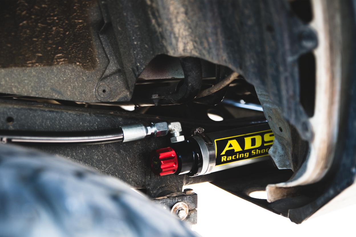

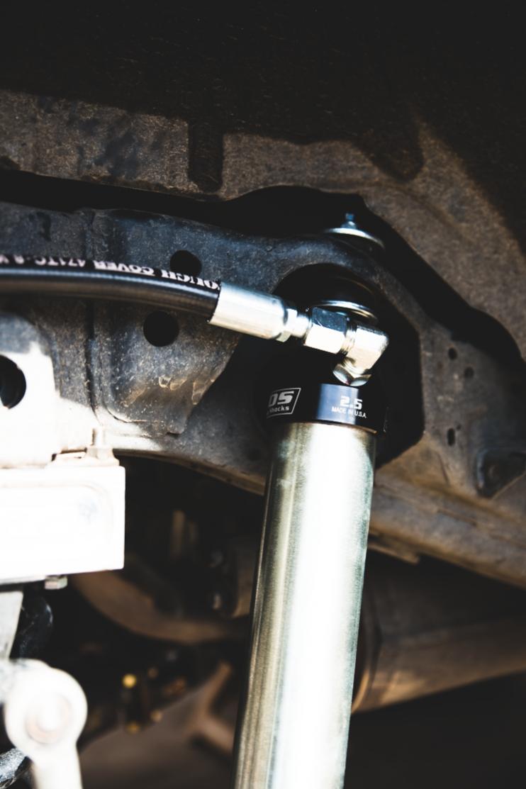

Edit: added some photos from my build and realized I didn't answer your initial questions.
I found ADS through Slee. I have Slee's suspension on my Cruiser and they use ADS to build their shocks. After my experience with them decided to use ADS on other vehicles moving forward. My front coilovers are still Radflo 2.5's with 700lb coils. Rear coils are I believe Dobinsons 701v (whatever their new heaviest progressive is).
