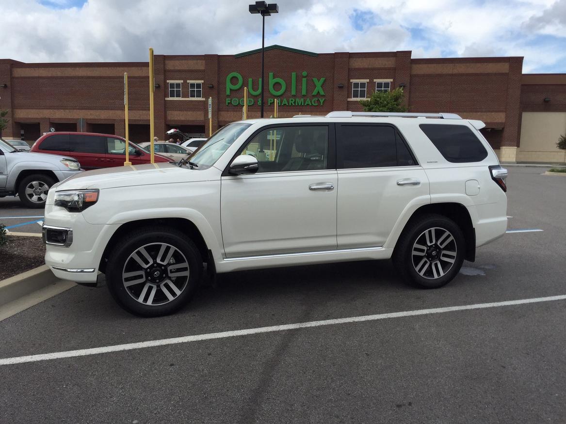

So I recently bought a new 2014 limited T4R blizzard pearl and have been following these forums since I got my truck. My wife and I are hoping to turn this into an Overlanding rig and have a few questions. First of all, we know this is a fairly capable vehicle from the get go, but also know there are limitations to the stock truck. First I'll list out the upgrades we were thinking, hopefully Im not to far off.
BTW - I understand it might have been easier to go with the trail or even SR5 premium, but I have three kids and needed the 3rd row and we liked the leather seats, and dual climate. Got to keep momma happy.
TRD pro wheels with BFG AT 2 275/70R17?
Icon stage 2 lift with tube UCA's
Roof rack (Gobi, drabbits, Bada)
Shrockworks front bumper
Shrockworks rock sliders w/ trim package for the limited
Shrockworks rear bumper with swing arm tire mount
Skid plates of some sort
Roof top tent of some sort
Front and rear lockers at some point.
Now the first question.
If I choose this wheel and tires set, will this set up work with the stock bumper(with and without the lift) at least until I get the front bumper replaced?
#2 by adding the additional weight of the bumpers, rock sliders and such will the Icon stage 2 lift be appropriate?
These mods will be done over time, but realistically I'd like to do the wheelset in the next month, and then the suspension, roof rack and tent by early spring. We are planning a trip to New Mexico and Colorado around the end of May. If I can do more before that time then I will. I know there are endless additions I can make but we'll have to do this slowly. I appreciate and help and advice you seasoned guys can give me, I live in Knoxville and my off road resources seem limited around here.

One of the first things I did to mine was install an RCI gas tank skid plate. The Limited stock gas tank skid plate only covers the front 1/3 of the tank. The rest is just the plastic tank exposed. The SR5 and Trail use a full thin sheet metal skid. It actually cost about the same to buy the heavier RCI skid as the stock thin Toyota skid plate. I am going with the 17" BFG KO2 tires probably next week but I am going to run the stock 20"tires most of the year for long highway trips. I am going to lift sometime but just a spacer lift. I love the xreas suspension on twisty mountain roads.
With all that extra weight, you are going to need to re-gear (since the truck will feel like a pig) and if you plan to do lockers, might as well re-gear to 4.56 at the same time. I'm doing that right now myself.
Also, might as well go to a 285 tire. Tires pretty much make or break your offload capability.
I would get lift/UCAs and tires and wheels on first. It will all fit with the stock bumpers without much of an issue. You may need to push the fender liners forward after getting your caster set near 4* positive.
If you plan to do pretty serious stuff alone (like where lockers would be required), consider a winch for self recovery.
Also, I would not mess with Icon for overland.. Consider ARB/OME. Much cheaper and they last forever..
