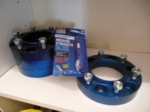

Planning to install 4 spidertrax wheel spacers in all 4 wheels.
Things to do and not to do?
Torques for spacer to the hub and wheel to the spacer?
Amount of blue loctite per stud? and it goes on both the stud and nut or just one?
After care?
Thanks
Just check your torque a few times in the week after installation.

I don't use Extended Threaded lug nuts. FWIW.
If you use lock tite, don't retorque. It will break the adhesion and essentially not be locktited anymore.
