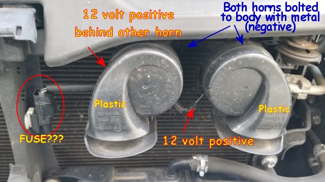

The entire metal body of your car is negative/ground. There is a wire that comes from the relay to the horn. It should be near the horn. (see photo) That wire is positive. You didn't have to remove the horn to test it, but it appears to me that your video shows it hooked up backwards; positive to the horn body and negative to the input voltage. I'm not sure that it makes a difference. The sound coming out was not normal. It should have been quite loud. Positive wire from the battery connects to the input tab on the horn (not the body). Hold the negative wire firmly to the metal part of the horn, but don't touch the positive and negative together; lots of sparks. You probably didn't make a good connection.

In my attached image you see the 2 horns on my 04 T4R. You can see the wire on the right one. The wire for the left horn is hidden by the horn. Something I've not noticed before is a set of wires on the left going to a small holder. This is probably a fuse to protect the wires from overloading. I'm not sure because I've not seen this on other cars.
You don't need to remove the horns to test them but it's looking like they're both bad. There is one more test you could do if so inclined and if you have a multimeter. Plug the wire to the horn to the red/positive lead of the multimeter. Clip the negative lead to the body or negative post on the battery. Set the multimeter to DC volts in the 20 volt range. Blow the horn. Meter should show 12 volts DC.
If you are satisfied with your tests, buy 2 new replacements; hi and low. (I'm a pack rat and I would keep the old horn that still works. Something to test with or give to someone else.)

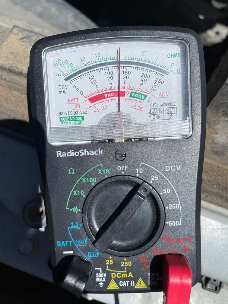

Thanks for all the advice and good suggestion about the multimeter now that I can easily get at the horn & wiring. This photo shows the results of another daughter holding the horn down while the multimeter was connected -- positive to the connector going to one of horns, negative to the battery negative. Should have thought of this test myself, but clearly I'm new to this stuff and even more new to electrical.
Looks like I'm buying new horns.

Yes, if you're getting power at the wire then it's definitely the horns. I had the very same thing happen years ago on a '91 Camry. I bought a new horn relay and put it in; nothing. I never thought both horns would go out at the same time. I went to the JC Whitney site (remember their catalog?) and found some horns for about $20 or so. They lasted over 12 years, until I finally donated the car to Goodwill when it was 29 years old.
Glad it's working out for you. You can see if NAPA has the horns but you may need to buy from Toyota. Anyway, you've found the problem. Clean off any rust from the bolt on area and you're good to go.
Yes, if you're getting power at the wire then it's definitely the horns. ... Glad it's working out for you. You can see if NAPA has the horns but you may need to buy from Toyota. Anyway, you've found the problem. Clean off any rust from the bolt on area and you're good to go.
New horns arrived today & installed. Problem solved. Sucks that Toyota charges so much for the parts (about $150 total for both the high and low horns), but sure beat the heck out of a new clock spring!
