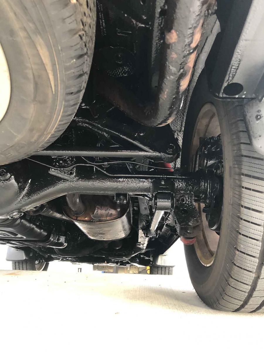

Thanks for all the responses, everyone. I wanted to share an update on the rust issue.
I took the 4R to a shop which banged on the frame rails and convinced me it was worth salvaging. I replaced the rusted out skid plate and engine undercover sub assembly with new ones that I painted with several layers of rustoleum. I had to drill out and retap a few bolts on the underside. I reinforced a couple heat shields with washers, but ripped out the muffler heat shield since the mount points were beyond salvaging, and I didn't want to deal with riveting new posts. I didn't notice hot floors or other issues driving around this summer without the heat shield, so I feel safe leaving it off.
I had a local shop strip the remaining rust and spray the underside, rockers, and inside the frame with fluid film. The treatment cost about $350 and they applied about 2 gallons.
I'm keeping my fingers crossed that I can drive the 4R for a few more years, and hopefully without a big repair, like AC or xreas.

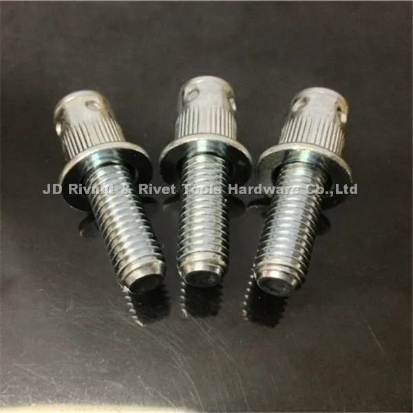

Heat by itself is not an issue even in the summer if you don't use heat shield the condensation under carpet and potential mold in the winter is a concern if you have shield off under rear passenger area. You can get Rivet Bolts and proper tool on Amazon and install these from underside:
Makes sense. I looked into something like those rivets, but it’s a tight area to get into with the muffler in the way, and there’s no dropping the muffler with the amount of rust on the flange. Maybe a project for next spring..
