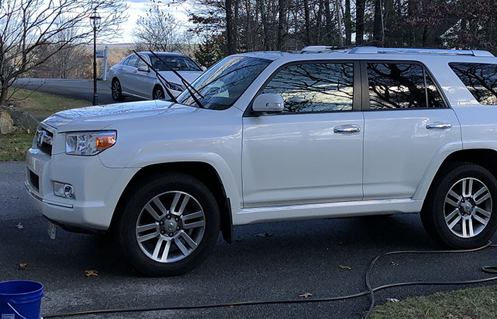

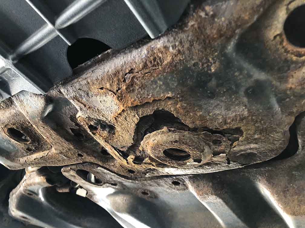

I have a 2012 Limited with about 130k in the Boston area. I maintained it religiously hoping to take it well into 200k territory, but I never thought to coat the underside. In just the last 2 years I had the following rust related issues:
  • 3 frozen calipers.. one destroyed my rim (cosmetically) when the piston froze stuck out during a long road trip, wore the pad down and caused metal/metal debris to land on the rim giving me a nice molten-sand blast finish
  • Every heat shield rusted through and was replaced or fixed with washers
  • Most of the heat shield posts are rust icicles and needed replacing
  • Rusted through skid plate & splash shield
  • Transmission switch (range sensor switch) froze/rusted, rusted solid to transmission
I can see that I still have many more rust-related projects ahead of me, but the frame rust concerns me.
Many of the welds are flaking and I don't have a good feel for what's safe. Is it time for me to trade it in?
Between parts and my time (which is free I guess) the repair costs have been adding up lately. I know I have a pricey xreas repair ahead, and likely an AC repair. I got a quote for $14k to trade it in, is it time to part ways? Or are my rust concerns stupid, and it'll drive to 300k+ like all the 3rd/4th gens have?
Thanks in advanced!
After 8 years and 130k miles, I think $14k is not a bad trade in. I would trade-in.

take the 14 and run. new ride - woolwax or fluid film professionally sprayed every fall. professionals know where to spray and have all the attachments to get inside the frame.

My advice: I'd take the 14k, and make the (sometimes considerable) effort to keep the vehicle (particularly the undercarriage) clean on a new vehicle. Or you can just let the new one rust too, and replace it sooner than would otherwise be necessary if it weren't neglected. Some people do the latter, sort of as the cost of doing business, when they don't wish to make the effort to keep their vehicle clean.
In my defense, I didn't neglect the vehicle. I washed the vehicle 1-2 times a month. Clay bar and wax 2-3 times a year. Every spring I hosed the undercarriage thoroughly, and in the winter I periodically took it to a car wash with the undercarriage wash. I really worked hard to keep it looking great since I wanted to own it for a long time (see photo from last fall), so I'm kind of butt hurt by the situation.
When I bought the 4R I didn't really believe in coating the undercarriage because, in my mind, you would have to pull every component from the underside and thoroughly coat 100% of the surface. I figured that after the half dozen recalls between '95-'00 and '05-'10, Toyota would have addressed rust-proofing in the factory. I'm sure the salesman told me the same thing ;)

Thanks. I park in an unheated garage or outside in the winter. Never have had a problem on new vehicles. Some surface rust, sure, but nothing like your pictures.

I'd use this as a lesson in what is necessary when living in the rust belt. Or move, which is what I'm considering.

Any make or model can rust or corrode, if it is sufficiently neglected in a highly corrosive environment.
The Tacoma, Tundra, and Sequoia frames that were more prone to rust, were improperly made In America by Dana Corp. Now Toyota should have done a better job verifying that Dana Corp was making the frames to spec. Dana Corp should have made the frames to spec, and shouldn't have cut corners.
Ultimately Dana Corp had to pay a 25 million dollar judgement for the improperly made frames, and Toyota replaced a bunch of frames.
Even when a steel frame is made properly with anti-rust treatments, if they are sufficiently neglected long enough in a highly corrosive environment, it'll have issues.
I doubt the "Stainless steel" cyber truck is entirely made of stainless steel. If it has regular painted or coated steel, AND it's sufficiently neglected in a highly corrosive environment, it will have rust issues too. Also, stainless steel can corrode.
You can't just wash the undercarriage thoroughly when it's warm out in the spring. If it drives in salt, it needs constant attention.
My hose freezes in the winter so I let the car wash do an "undercarriage wash" on it and I make sure to go real slow over the sprayers every time. Other than that, if we get a random 50* couple of days anywhere in the dead of winter, you better believe I'll have the hose out.
If it were like a show type of vehicle, it would sit in the garage any time there's a hint of salt on the roads and only ever get washed by me personally. It's not. So I do what I can when my hose is frozen.
8 years old and 140k miles on mine that travels all through NE every winter. It looks way better than that underneath. Either replace any replaceable rusted parts or trade it. Some of that looks bad.
