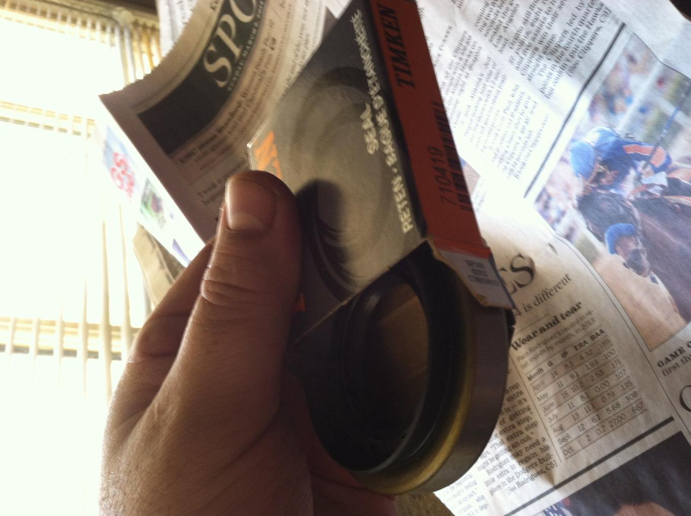

I swapped in a G144 front axle out of a '93 into my 4rnr. Got rid of the ADD and swapped on my axle. All u need is the Timken axle seal P/N: 710419 and you're good to go.
