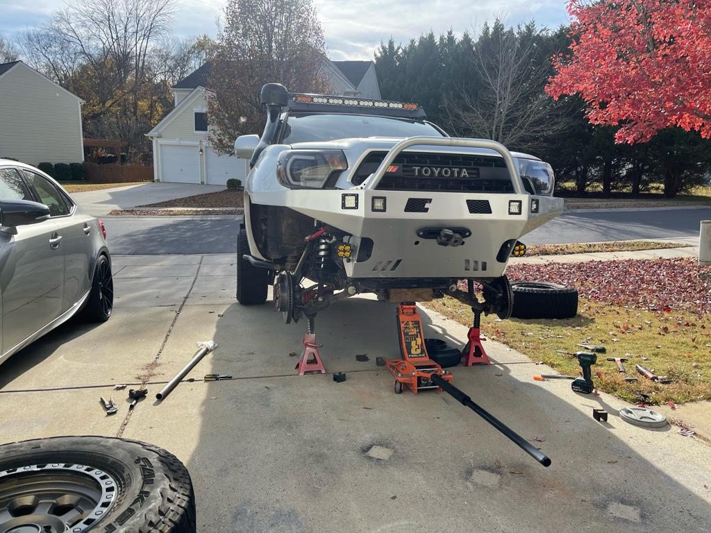

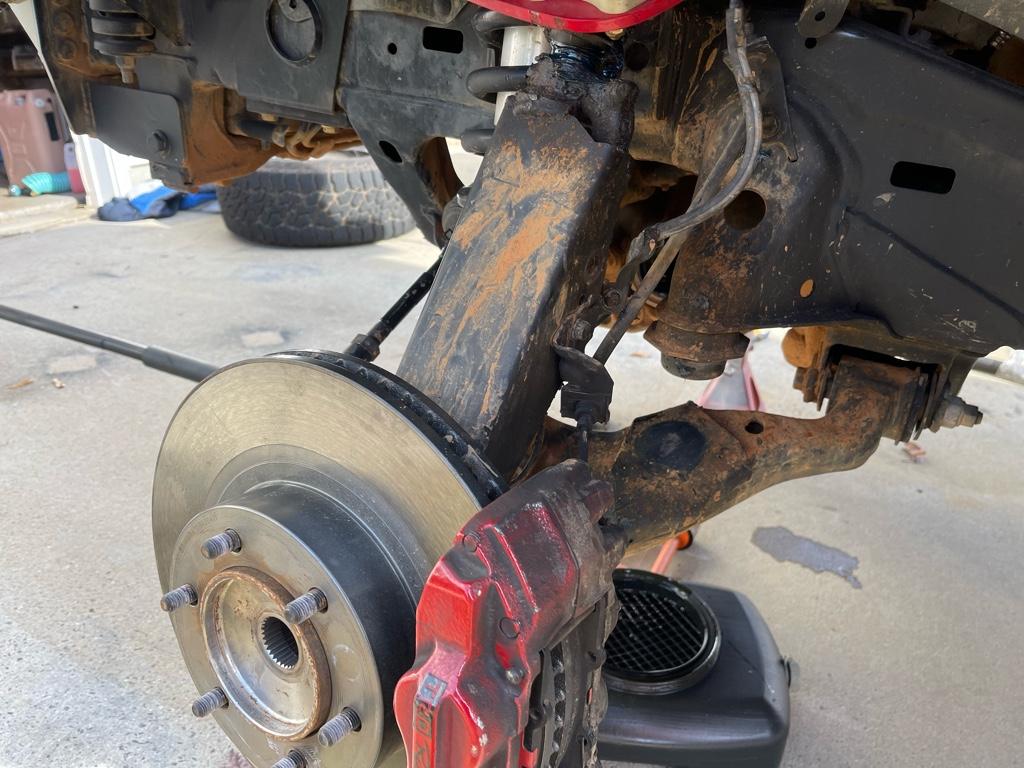

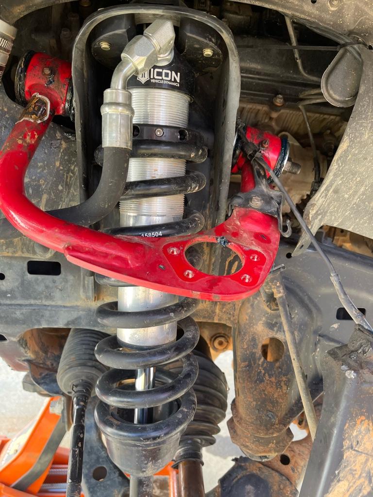

So I thought that my creaking/knocking sound while taking off from a stop with steering wheel turned as caused my a not fully tightened upper balljoint nut, which after tightening it down did seem to resolve the issue, however, after my flex test yesterday the sound is back and sounds to be worse, which led me to believe (unconfirmed at the moment) that the JBA ball joints are slightly worn. The boots are cracked (these failed pretty quick which is very annoying) so I have 2 replacements on the way and should let me know pretty quick if that is the issue indeed.
The reason I think this is the source of the issue is that I have no noise under regular front/back loading/unloading under heavy acceleration and breaking, but as soon as I crank the wheel and take off from a stop there is a pretty significant sound coming from the front. All tie rods are new, no sway bar is on, and all bolts are tight. it COULD possibly be the lower ball joints, however I don't think so. But just in case, since these have over 140k miles on them, I did order a set of detroit axle lca's to throw in temporarily while everything is apart until I go long travel in the next year or two.
I still have the cam tab reinforcement kit sitting waiting to go on so I figured it would be a really good time to get all of this done since I have to take apart a lot of the front end... CV axle reboot, cam tabs, UCA ball joint, and LCA replacement. Hopefully it'll resolve some of these noises and get it one step closer to a bit more reliable :)

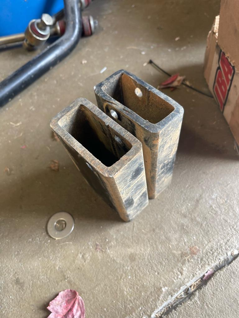

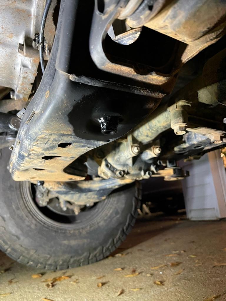

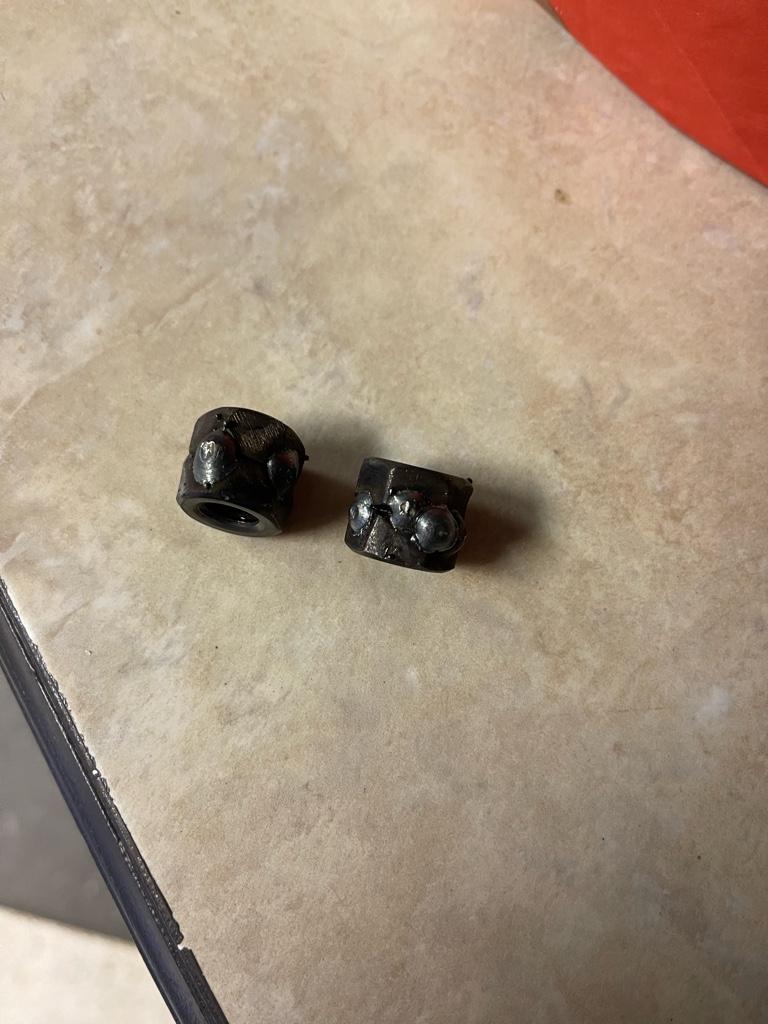

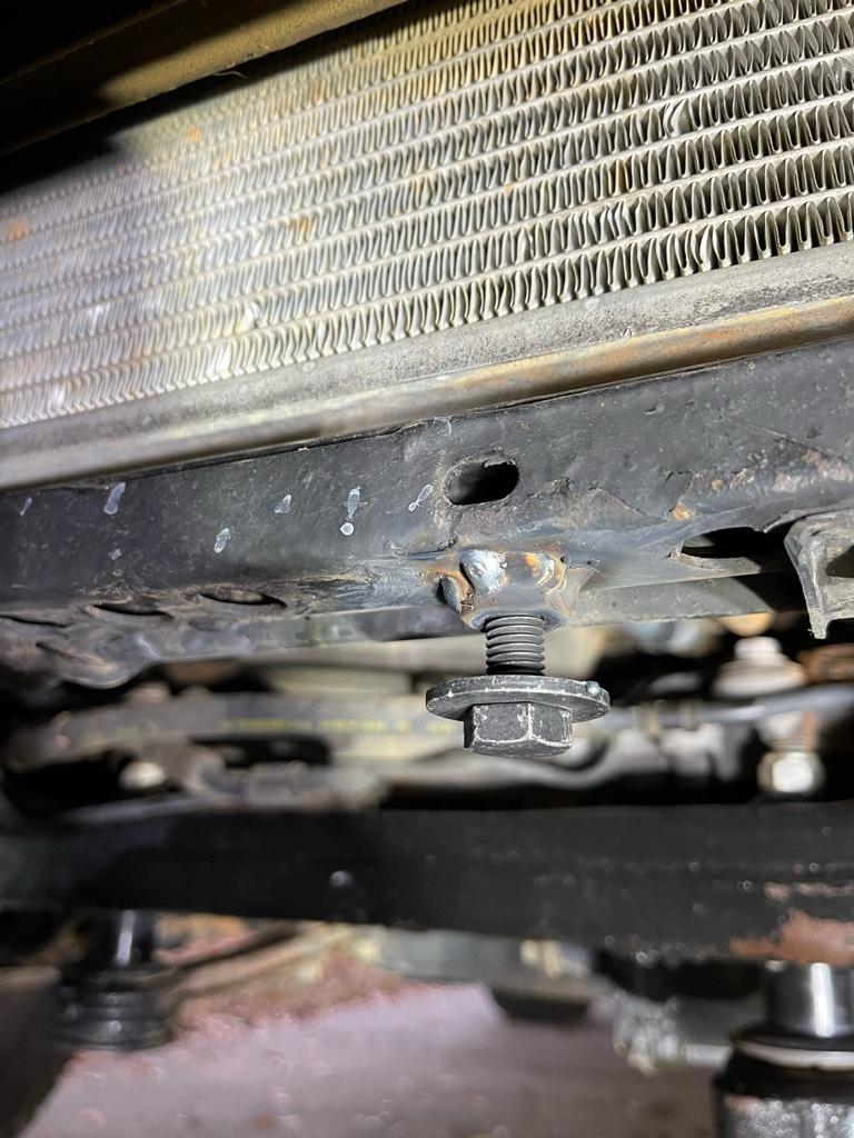

Oh yea, and since I ripped out all but 1 bolt from the front skid my plan is to weld on some M10 steel nuts right to the crossmembers so have a bit more beef to screw into once the skid goes back on.

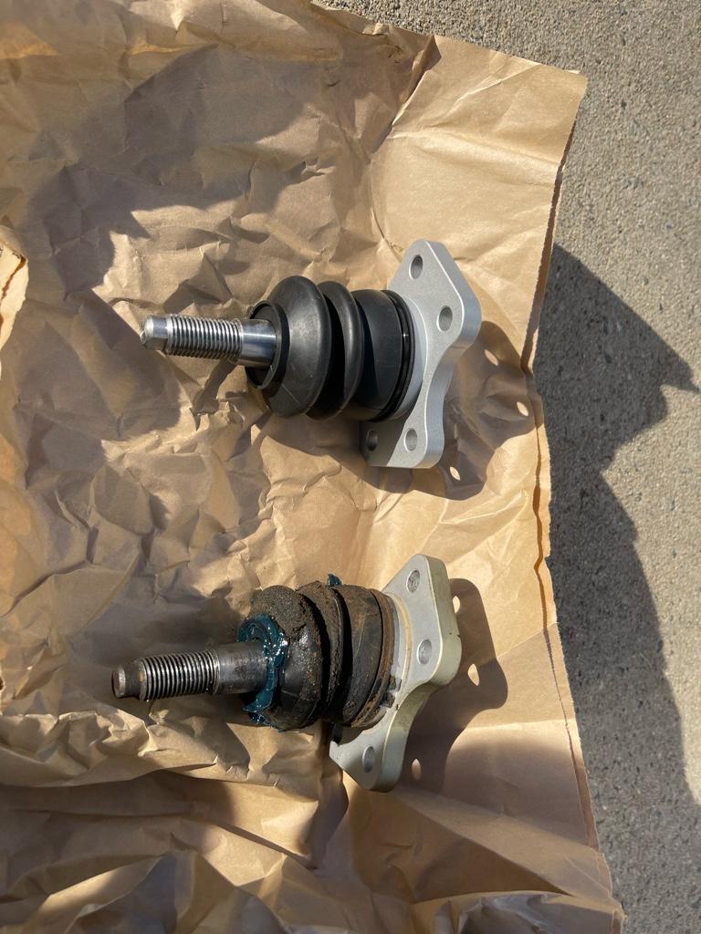

I got the JBAs as well with the old design ball joint boots. I dint feel like paying the big bucks for the new style so I bought these..More Information for MEVOTECH TXK6292
They are for a 2000 escalade/other GM trucks which should fit according to their website. I havent installed them yet but they feel like a nice product.

Thanks for the input on those man, I'll definitely be looking into it. My JBA's came with what i believe should have been the new design (bought about a year ago) but the boot itself didn't last for shit. Its literally cracked along 1 or 2 of the ribs and I have only been greasing it per the instructions (along with an oil change) so my thought is that I probably got some debris and moisture in there. I'm still not 100% sure that it's the balljoints making noise, but everything so far is pointing that way..
Do you know if those replacement ones still have the same range of motion? I have seen it mentioned a few times that there are replacements that fit their arm but won't allow the full 90 degree swing at full droop? If so... I feel ripped off... lol I paid 132 bucks shipped for 2, the ones you sent are like 30 bucks a piece..

Im not sure about the range of motion. Will have to test it out and compare before I install them.

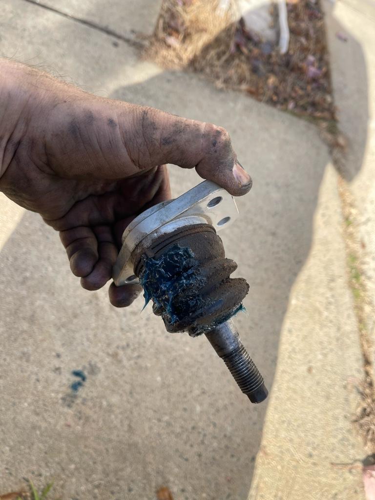

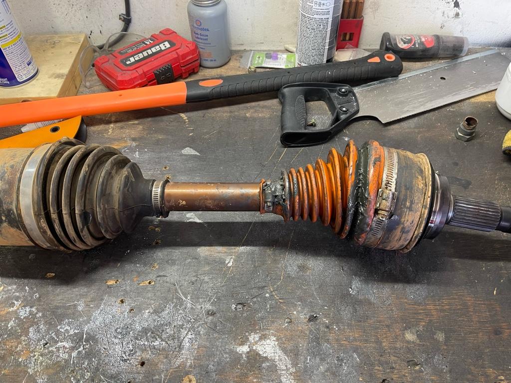

Had a productive but dirty 3 hours. Finally got around to rebooting the RCV axles and the JBA ball joints delivered.
The popping noise wasn’t the JBA ball joints but I’m still pissed the boots failed so fast lol. Oh well, got 2 spares for the trails now.

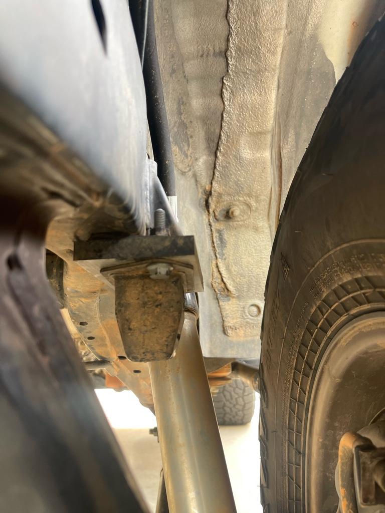

I think the popping noise may be coming from the rear springs that look like they shifted slightly on the 1in spring spacers I have installed. They definitely aren’t centered in the spring perch like stock. Need to do some more investigating.

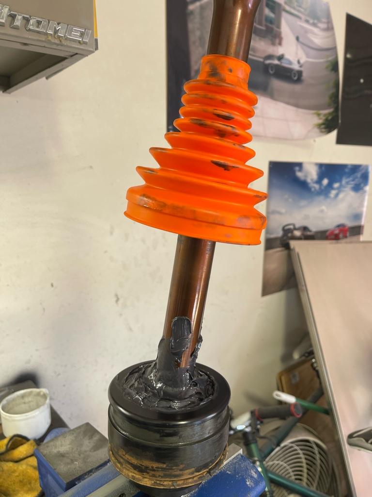

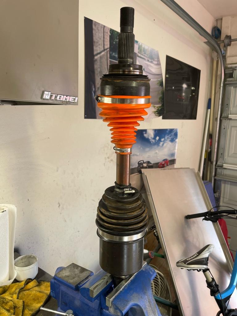

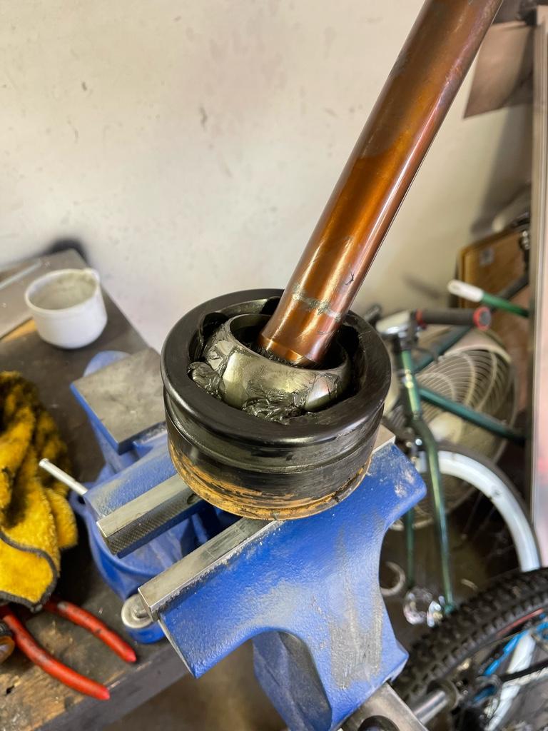

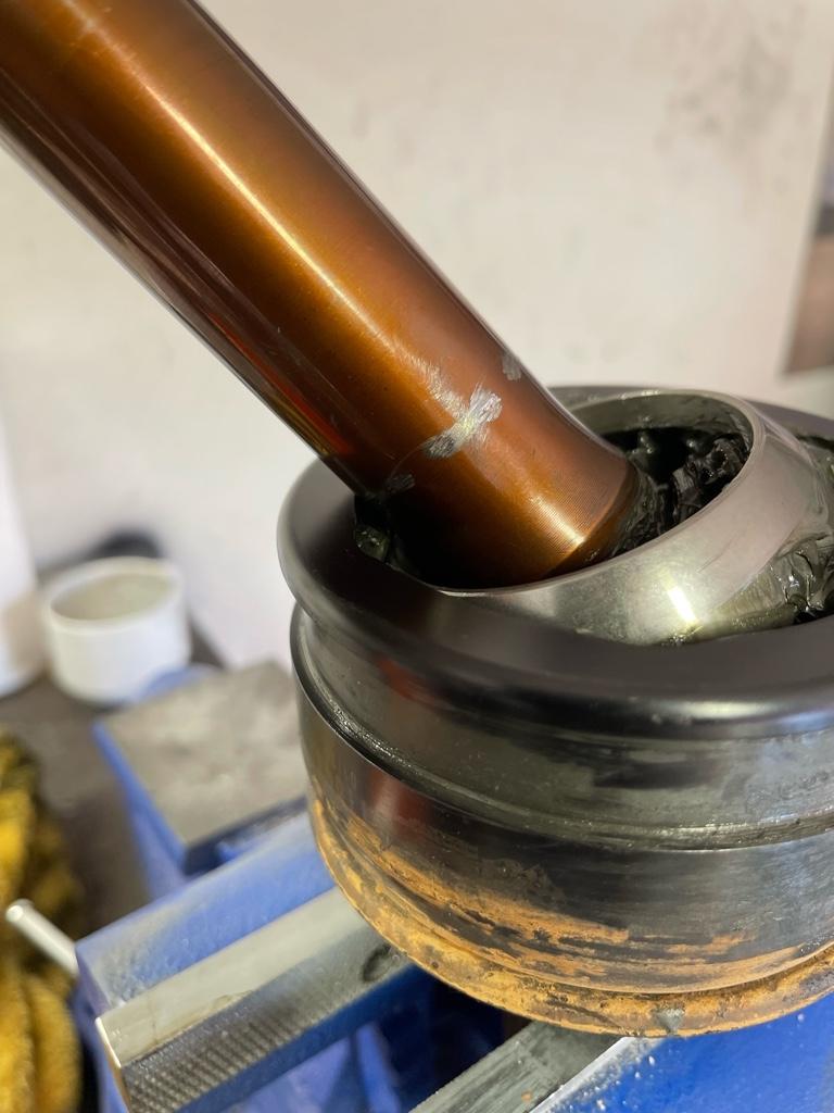

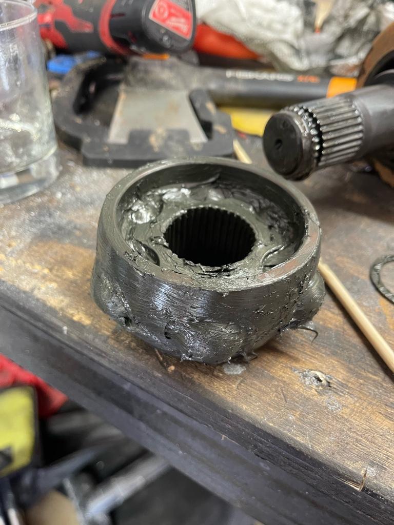

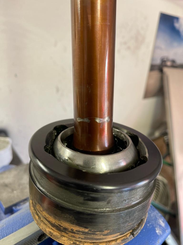

The RCV axles were interesting to look at. Completely different design than factory axles. They don’t have any pucks in them, but rather the ball and cage design in each cup. I did find something interesting… it looks like at full droop the RCV axle shaft actually comes in contact with the inside of the cup and you can see some impact/wear marks. Thought this was unusual but don’t see it causing any issue really…and these are lifetime warranty replacements so I don’t really care too much.
The jba balljoint replacement was quick as hell, but I hate their zip tie design to hold the boot on. It barely goths through the opening and I popped one off and had to install my own, which was even larger, so I had to put it on in place after mounting the balljoint. All in all not much to complain about.
Well, after the front end work didn’t resolve my issues with a clunking noise when turning and taking off I went digging in the rear. What do you know ? It was my upper control arm hiem joint all along… the on right above the gas tank I guess wasn’t fully tight and allowed the high to bash against the high misalignment spacer and wear it out a bit allowing th ball to spin inside and clunk left to right. The fact that I have 5/8” spacers with a 7/16 factory bolt doesn’t help either I guess, it was in a very tight space and hard to crank down on and I haven’t checked it lately.
Had to shave just a bit off the spacer to get them tight again, cranked down on the bolt and the noise is gone. So a friendly reminder, if you’re running heims on a street driven vehicle check and maintain them regularly and try to use proper torque and hardware lol. Sure is nice not having to worry about your wheels falling off with the type of clunking I was hearing and feeling lol.

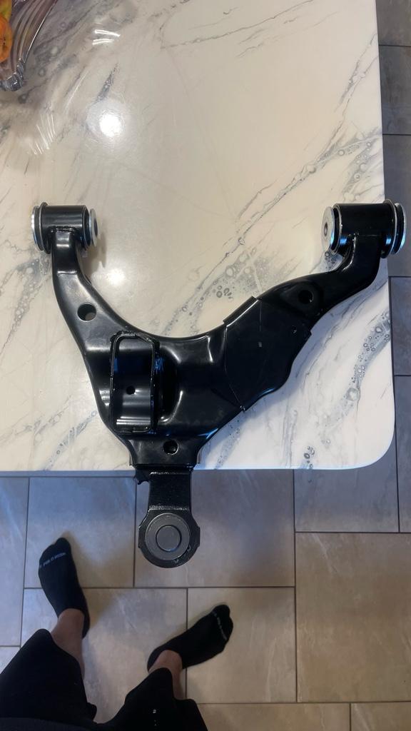

Got my Detroit axel lower control arms in. Don’t expect these to last nearly as long as the oem ones but I figured it would be nice to have some new bushings in place when I am working on the cam tab weldments since I have to pull the arms off anyway. The factory ones will stay in the spare parts list since I don’t really see any issues with them other than having 145k miles … but now that I’m typing this out it has me questioning my thought process… lol. Maybe I should just leave them alone

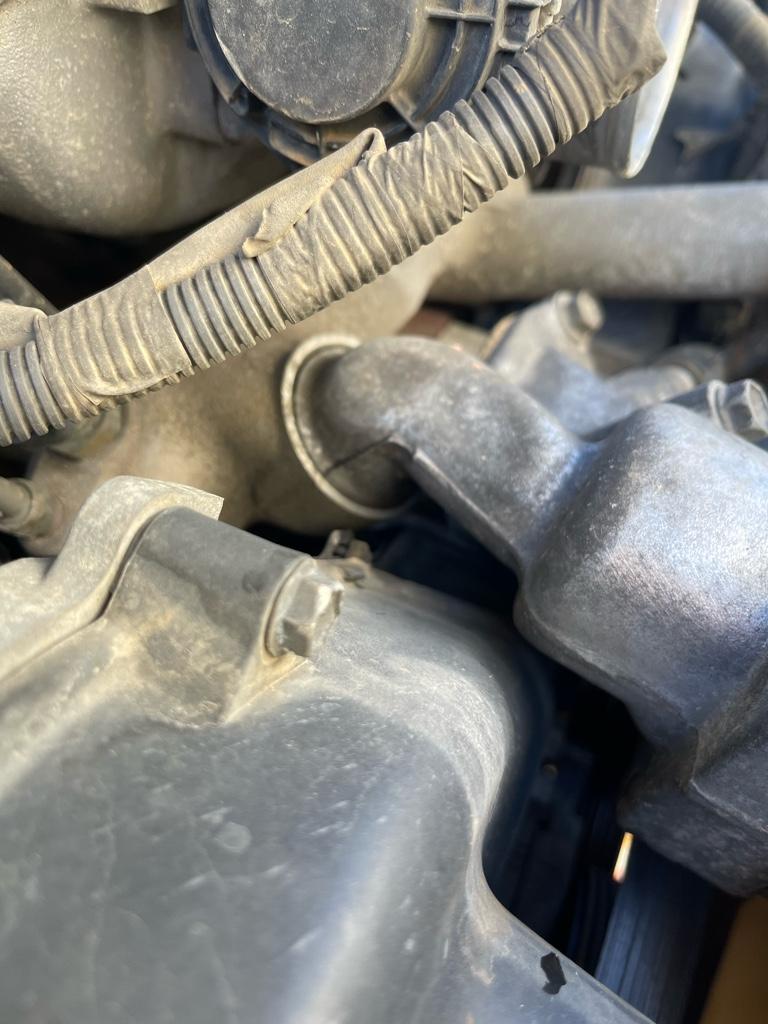

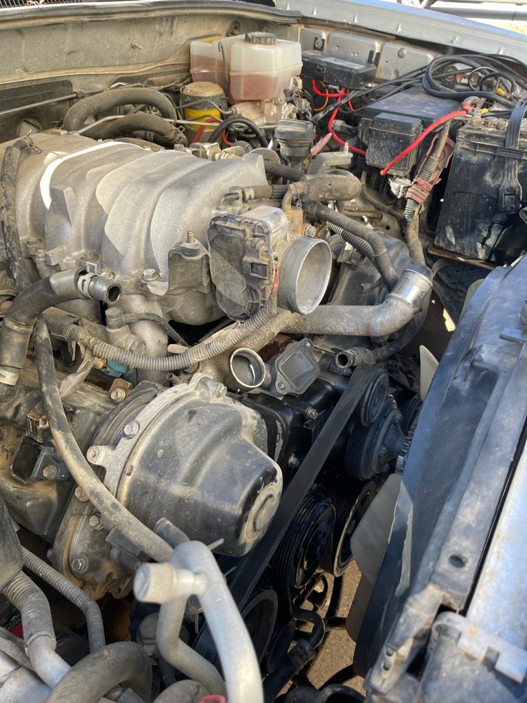

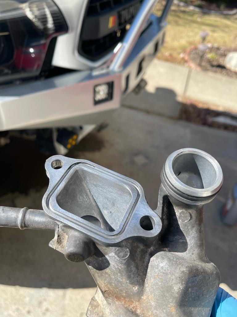

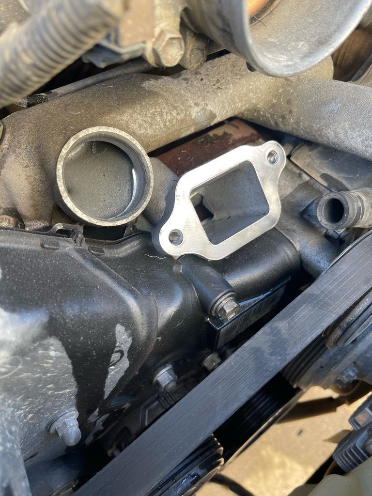

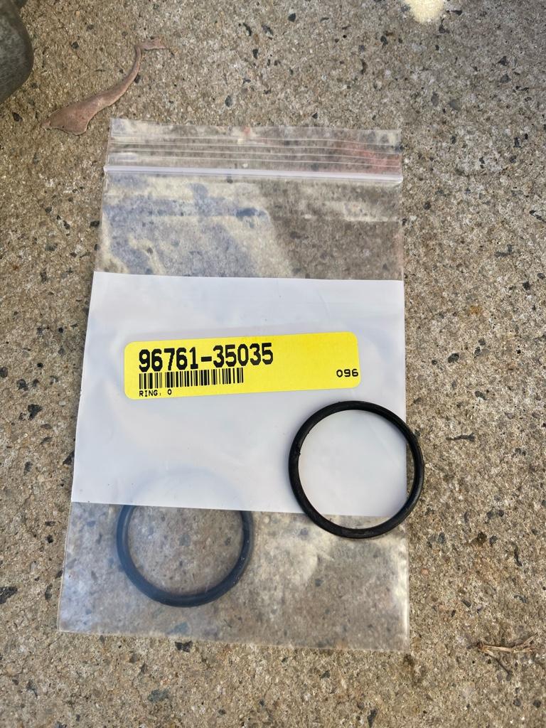

Took advantage of some nice weather to replace the upper thermostat housing o ring (part number in the pics, hard a hard time finding the correct one to order).
Took surprisingly quick to pop everything off. Now just to wait for the gasket to dry and fill up the coolant.
Is there not a square rubber gasket for the square area that fits into the groove of the housing, if not how is it sealed?

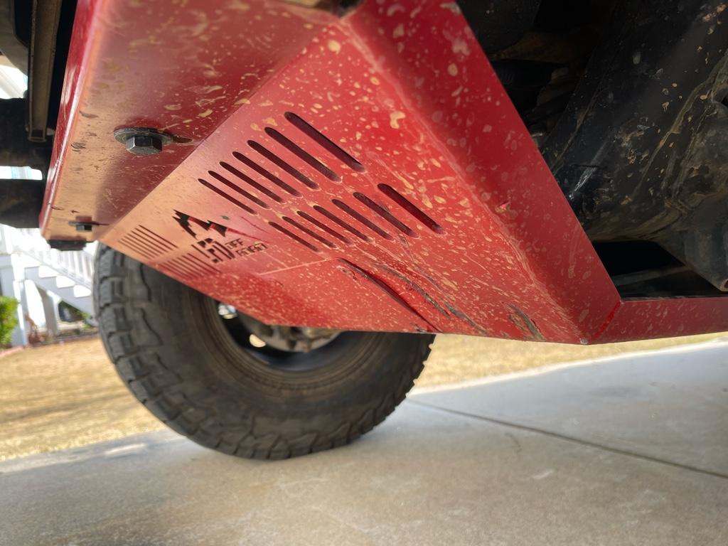

Made some new beefier mount points for the front skid. Stacked 2 washer for the rear to keep from having to use spacers which were a bit of a pain to insert.

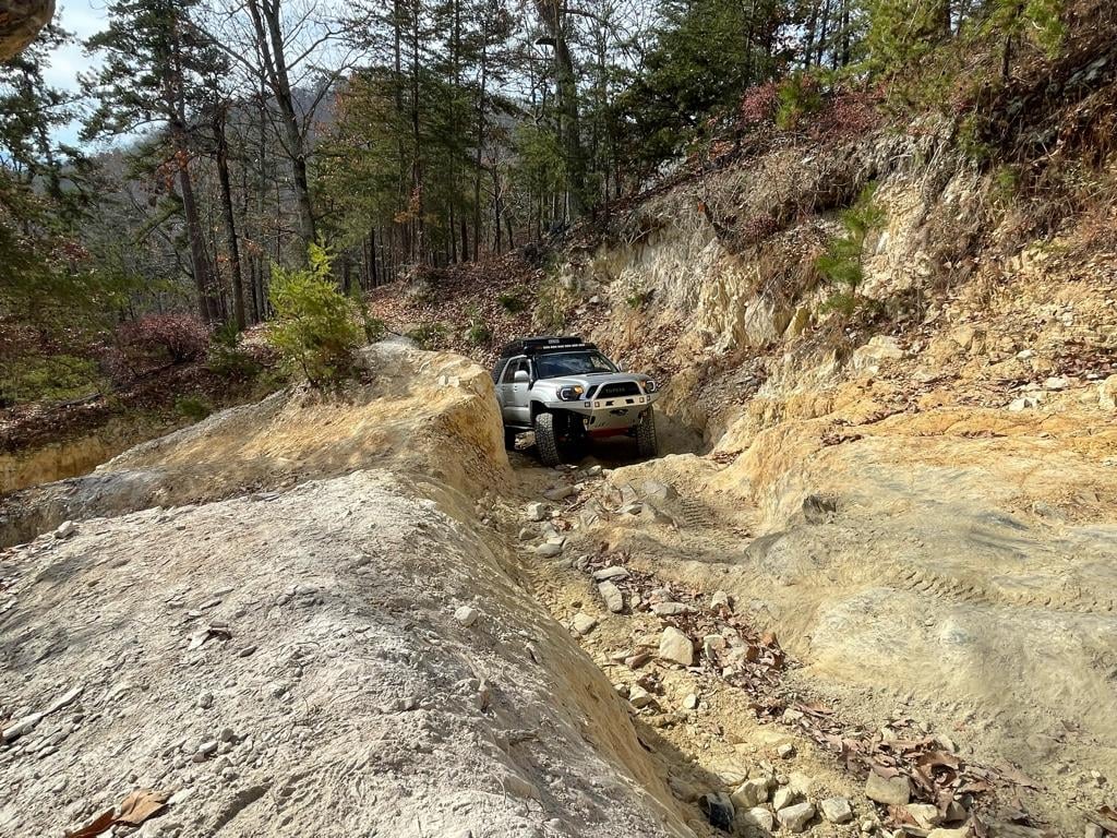

The local off-road trail is closing for the season on the 15th so we took one last trip out this weekend with my brother for a quick overnighter to do some camping and off roading.
All the recent repairs held up and the rig did awesome. Did some night trail riding as well as some morning rock crawling.
Bashed in the front skid, definitely nice to have it lol, it took quite a beating. Also ended up with some new pin striping on the side and some nice new gashes in the sliders. All in all an awesome trip out, super happy with how it performed.

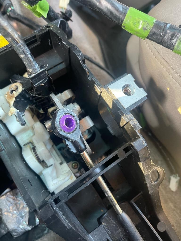

I got all the way home , backed the car into the driveway, went to park it, and my shifter linkage failed. Talk about perfect timing ! I’ve had the repair bushing sitting around for the last year on my work bench so luckily it was only a 20 minute repair. Could have been a lot worse of it happened in the trails lol

Lockers/RCV axles
Though pricey, having front/rear lockers in combination with RCV axles have me in a VERY comfortable place with regards to reliability. I had a couple of guys mention things like "that's a no-locker trail" or "I've made it up that fully open" etc. While that is perfectly fine, and I completely understand that a lot of the trails/climbs this rig does could be done open/open with some Skinny Pedal action, I have watched these rigs going up the same obstacles and it definitely looks violent, and the question isn't IF your axles or diff will fail, but when. Having lockers front and rear, on top of the beefier RCV axles give's me huge peace of mind. The last trail ride I did just about everything in 2Hi with an occasional rear locker engaged when I was bound up on a slick clay climb, but as soon as I would find myself not being able to make it up without really having to give it the beans I would just engage my 4wd with some lockers and it would crawl right up with minimal wheel spin and throttle. That was the entire purpose behind the build.. go out to have some fun, but do so reliably without having to do axle swaps and all on the trail.
