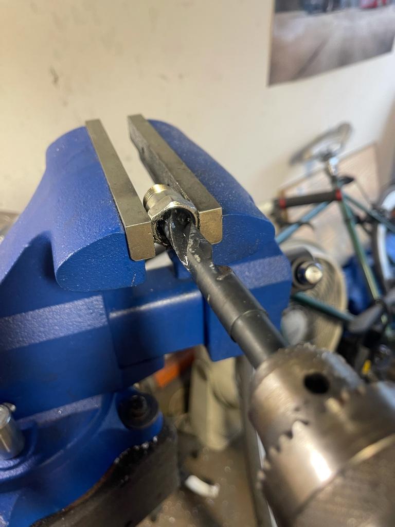

So looks like my $180 of A1 o2 sensors and sparkplugs/coils narrowed down my P0430 issue down to the actual catalytic converter itself.. I was super happy when the code didn't show up for the first 5 days, but now its back with a vengeance lol. Still throwing the bank 2 below threshold code... so after doing some digging I think my next cheap try will be to go get some non foulers at lunch and drill them out for the rear 02 sensors.. hopefully that takes care of the issue.
I don't mind spending the money on new cats.. but can't stand the idea of having to take off the headers to replace.. if I go through the trouble of doing that you better be damn certain i'm going with a long tube header instead lol. But now it looks like URD doesn't offer the 02 simulator anymore so I figured instead of dropping $1000+ on an upgrade i'll try the $15 route first and see what happens lol.

So a few things …

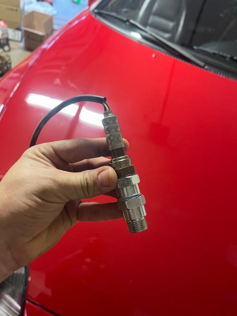

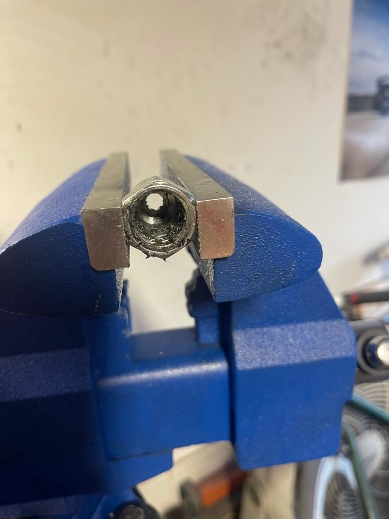

1. Drilling out the plug defoulers absolutely sucks without a drillpress absolutely sucks.
2. The stacked defouler method appears to work, but I may need to open the hole up a bit. At idle it’s reading 0v on that o2 sensor and I’m not sure if that’ll be a problem for the system to initialize, time will tell. It picks up voltage as soon as I start accelerating so the concept definitely works.

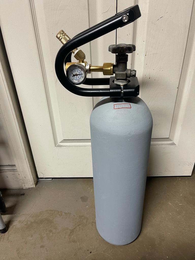

3. My CO2 fill is pretty much complete. Tank was supposed to ship empty, I’m not complaining or anything … but there’s 1600psi worth of CO2 in there.. so that bad boy is full lol. Can’t wait to do a test tomorrow.
No going back now. Spent a better part of the day tackling my custom carbon fiber snorkel. Made good progress but still have a ways to go…
While the fiberglass was drying I tried out my CO2 tank. 15 psi to 31 psi in about 40 seconds. Not too shabby !

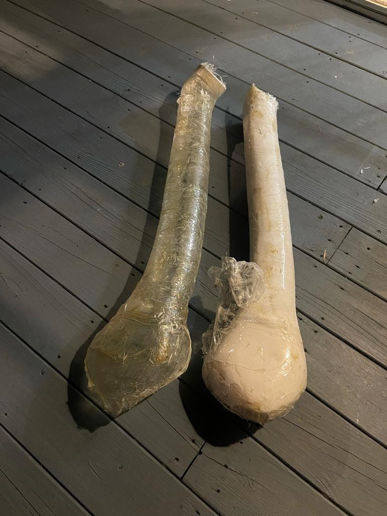

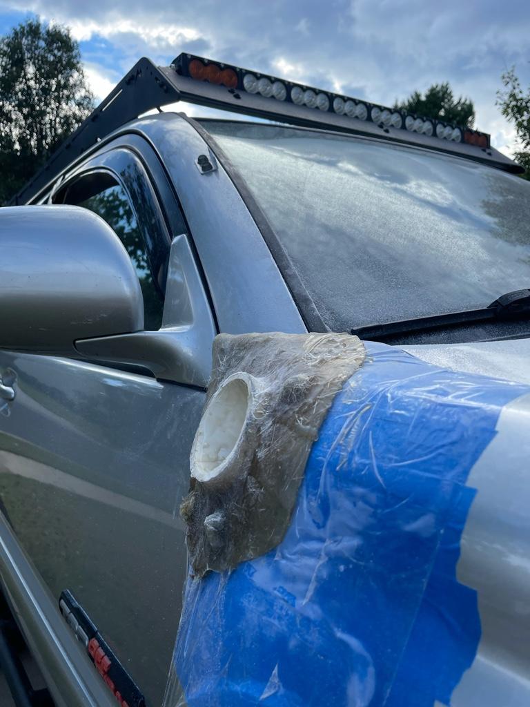

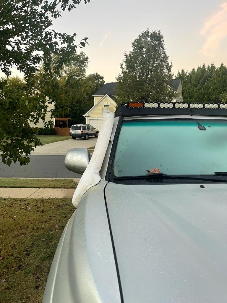

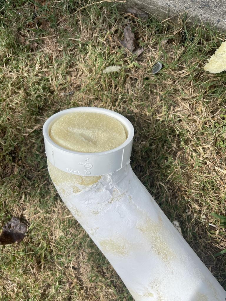

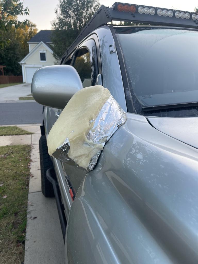

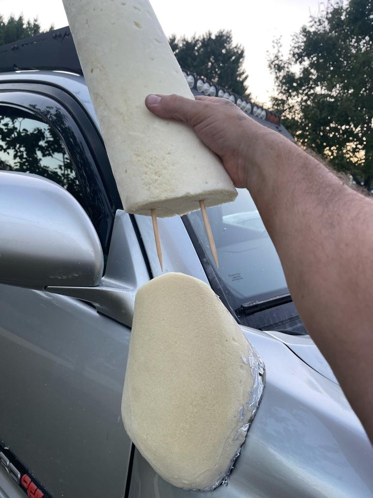

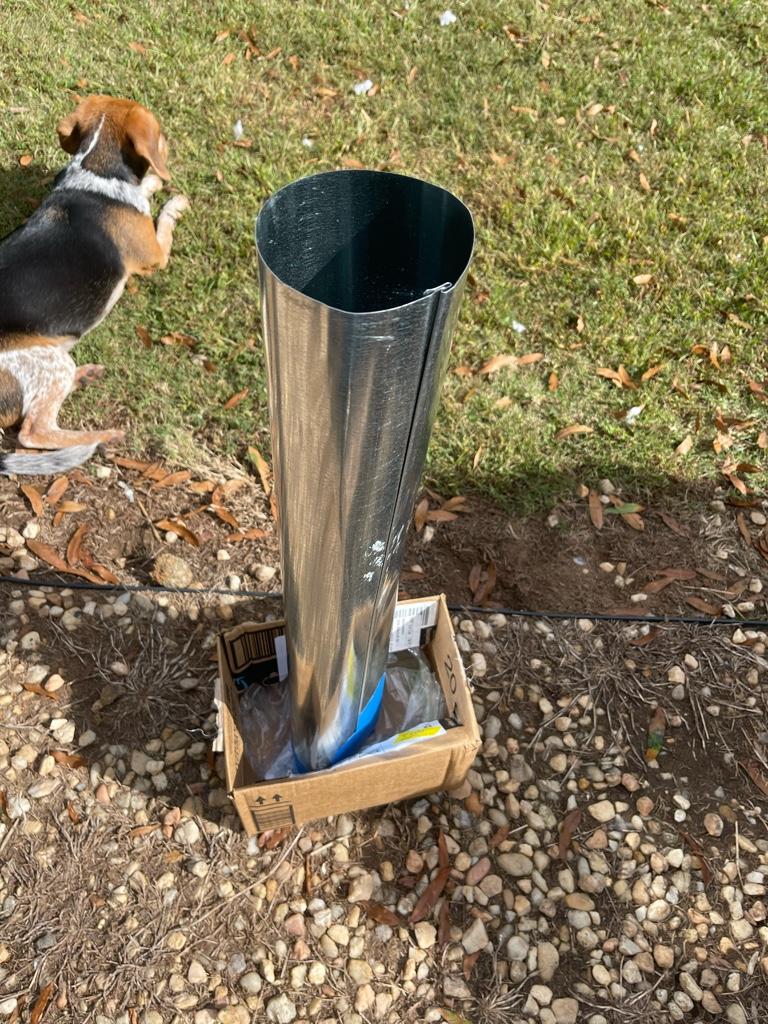

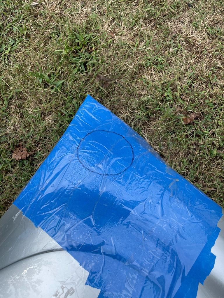

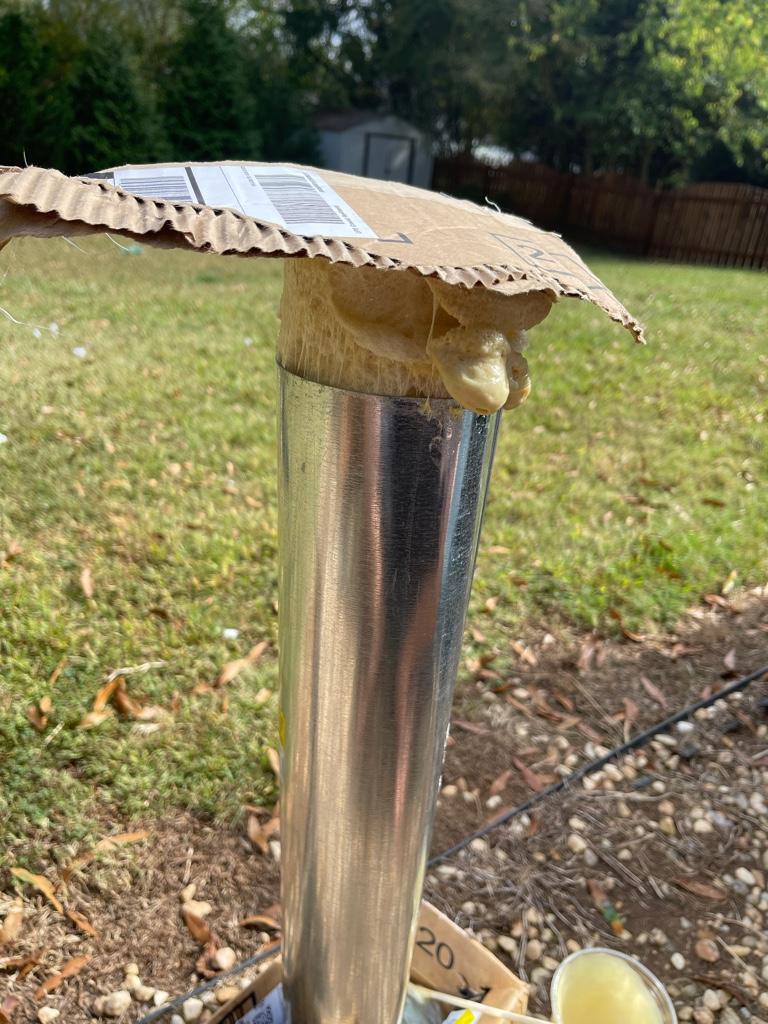

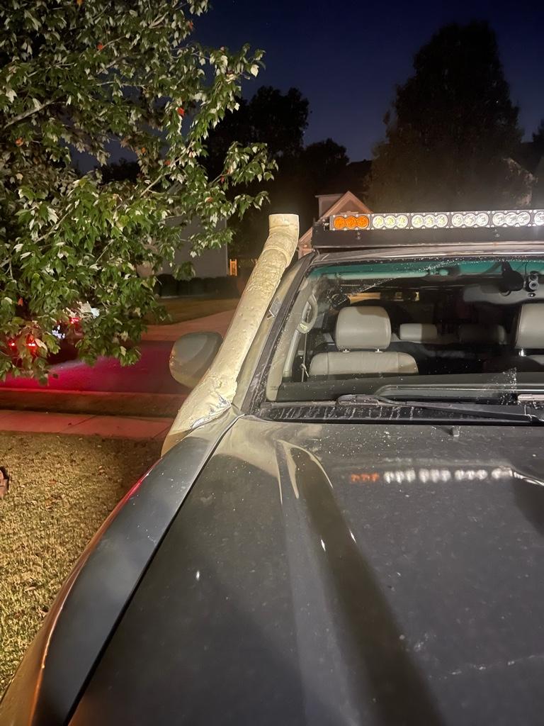

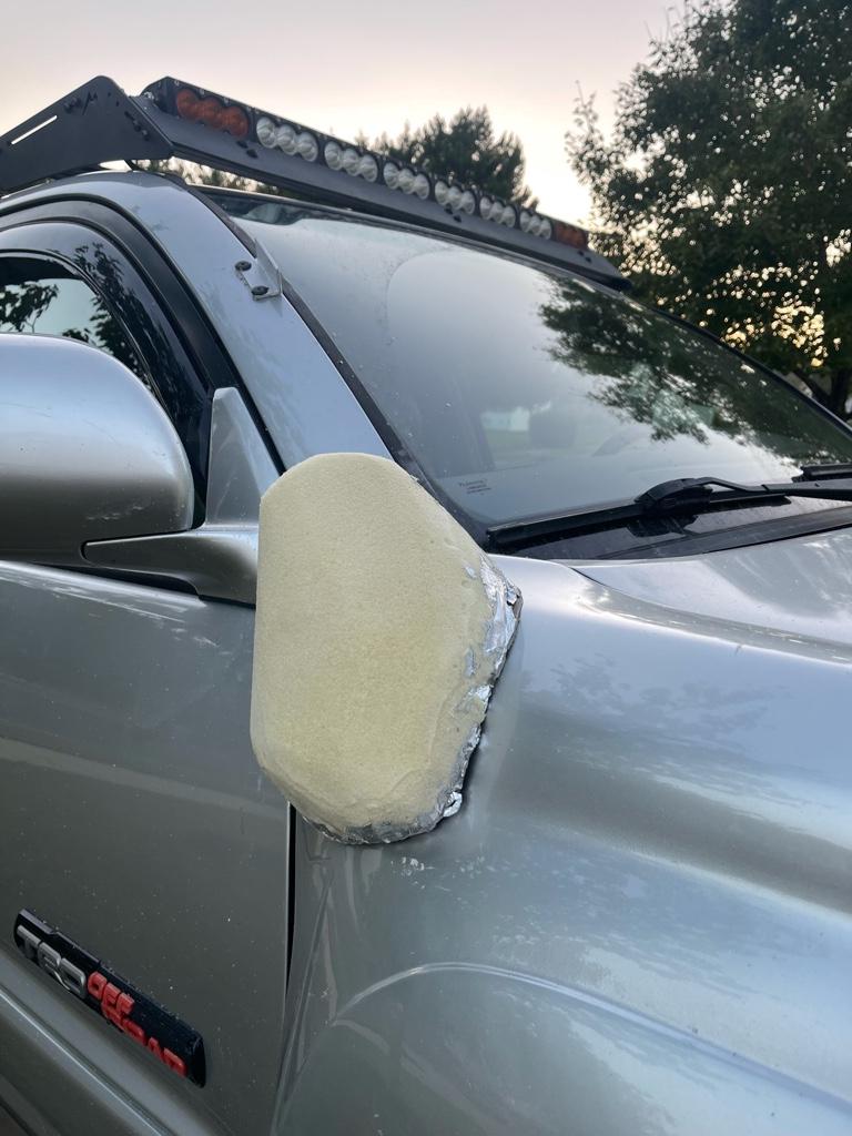

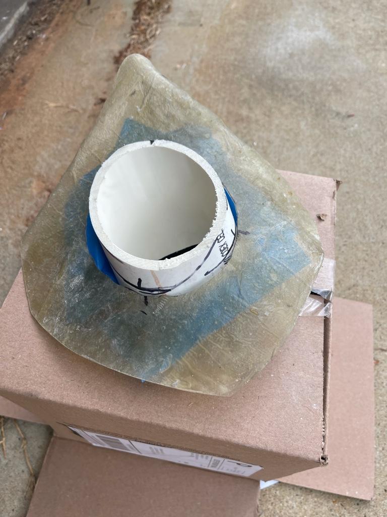

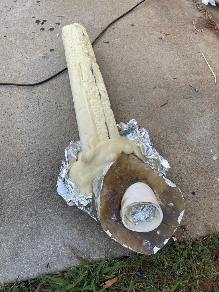

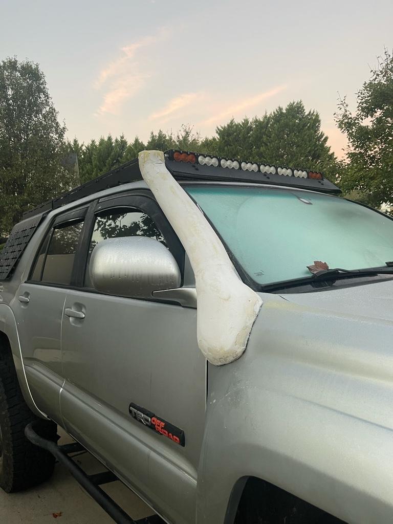

So I scrapped the idea of using pvc or duct material for the upper runner. Instead I decided to try the 2 part expanding foam to create the snorkel first before making a mold to made the carbon final piece. This stuff is pretty crazy lol.

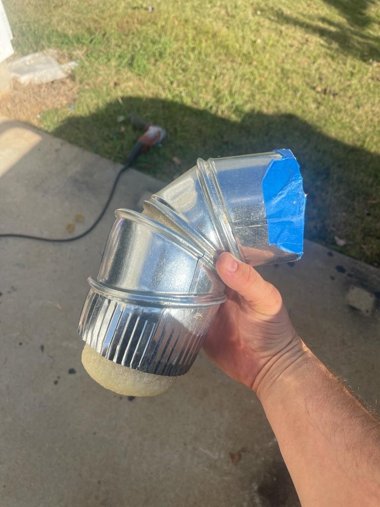

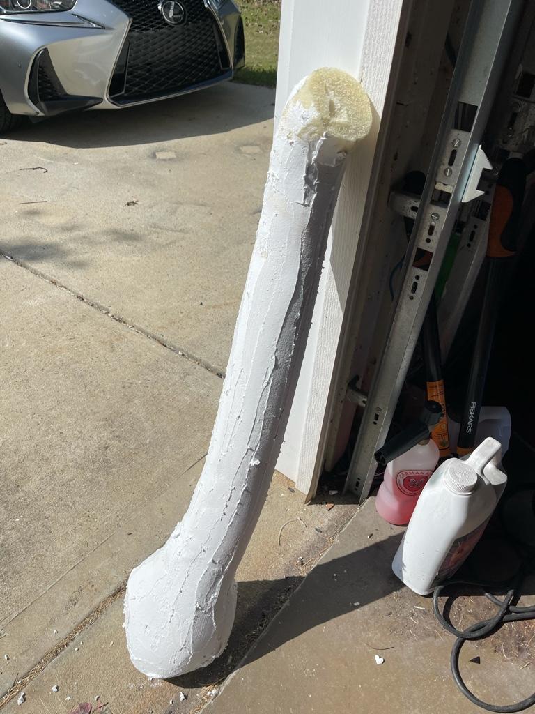

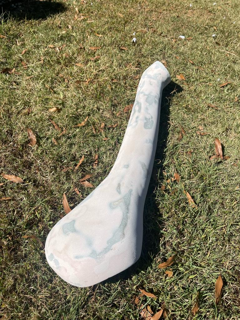

Did a little bit kore sanding on my lunch break and also fused the 45 degree elbow piece on. Was fairly happy with the overall shape so decided I would cover it in spackel and let it dry so I can start sanding in the actual finished surface in preparation for doing the first layer in fiber glass followed by the carbon fiber final layer.

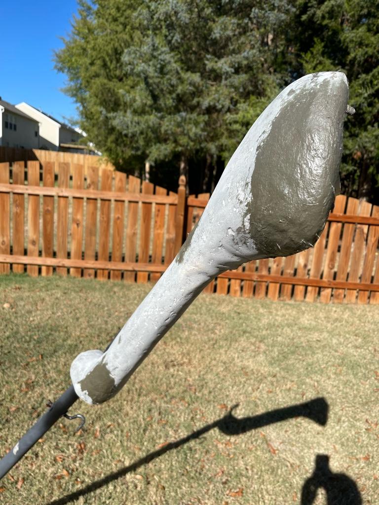

Sparkling took forever to dry, I hate sitting and waiting lol. Finally dried enough to start doing a bit of sanding before work this morning and man am I getting excited. I decided not to worry about the imperfections in the foam and just take it to the next step which will be fiberglass the hole thing.

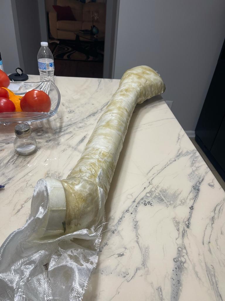

I’m going to do my best to do a clean smooth layer but worst case it’ll take some more sanding and filling with body filler to get it right before doing a final layer in carbon fiber. I figured 2 layers is plenty strong to support the pre filter. If I mess up the pattern a bit then I can go to a 3rd layer I guess. Still need to figure out exactly how to have the mounting bracket done and fused to the carbon but shouldn’t be too hard.

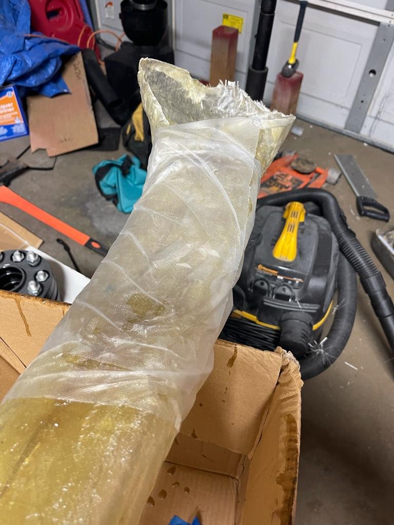

My current plan is to wrap the entire thing in fiberglass and then cut one side of it down into the foam so I can spread it a bit and take it off without having to fuse 2 completely separate pieces together but I don’t know if it will flex open enough to take it off from the foam.. we shall see. One things for sure.. this is going to be one sweet looking snorkel :)

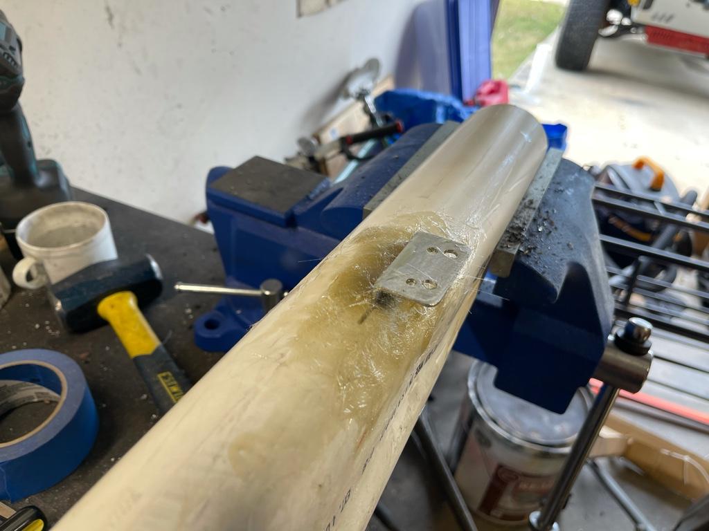

Did a little more sanding at lunch. I started fabricating the mourning bracket to the snorkel portion itself and will need to give it some thought on how I will fuse it to the carbon piece reliably. Potion and and all is great, just need to make sure it stay that way after it cures. I also decided to add a pvc reinforcement ring up top where the pre-filter will tighten using the clamp that way I don’t have to worry about crushing the carbon fiber if I go too tight.

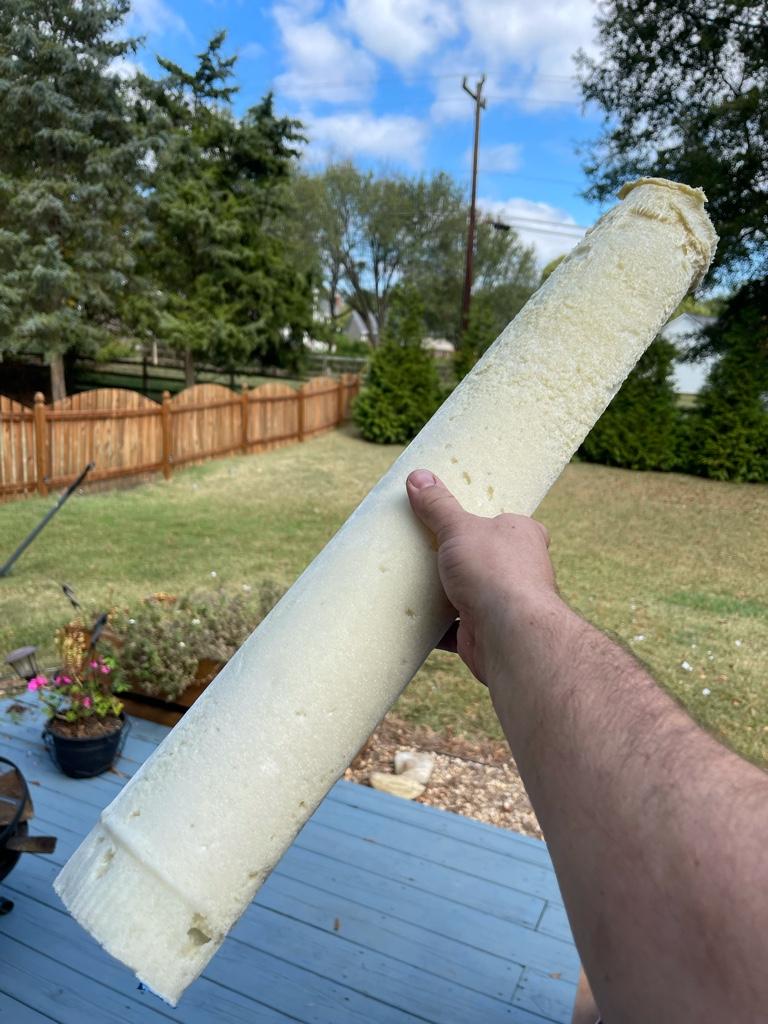

Is there anyway you could pour a solvent down there that dissolved the foam, but didn't hurt the fiberglass? Then you wouldn't need to seppuku the snork open to get the foam out.

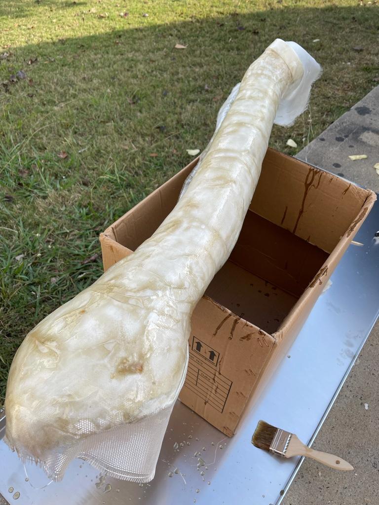

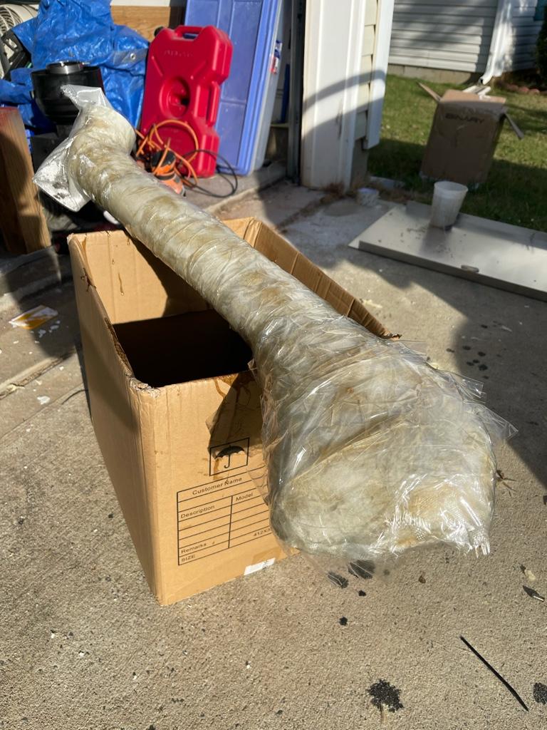

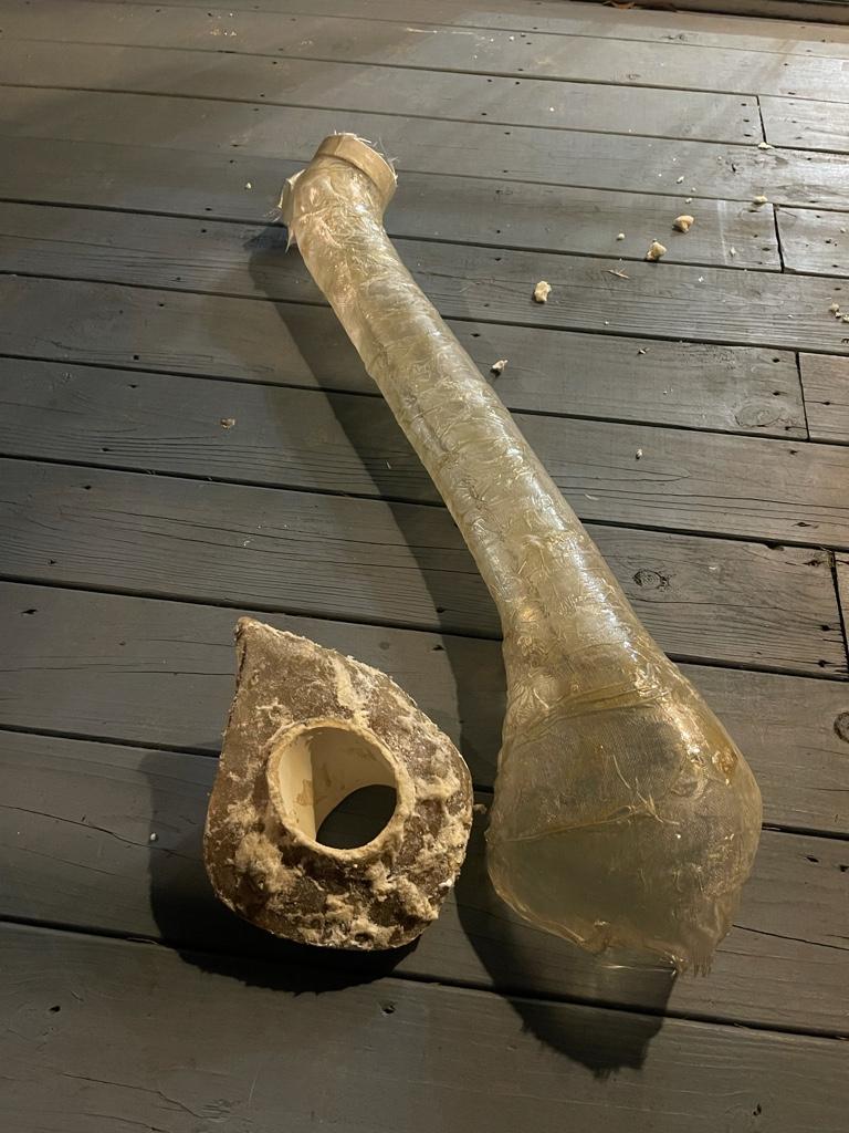

I looked into that as my first option but everything I read is that once it cures it’s basically a mechanical removal .. acetone does good to remove it before it cures but not so much once it cures. I may give it a try before I cut it but I’m not too concerned with cutting it open, there’s a lot of sanding that will have to be done anyhow… first layer of fiberglass is curing now so here goes nothing …
True, once it's cut, putting an extra fiberglass layer on is just rinse and repeat of the previous layers

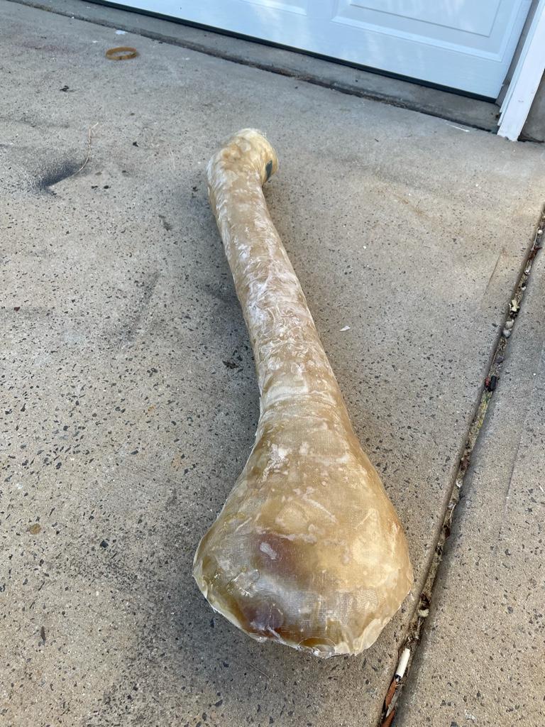

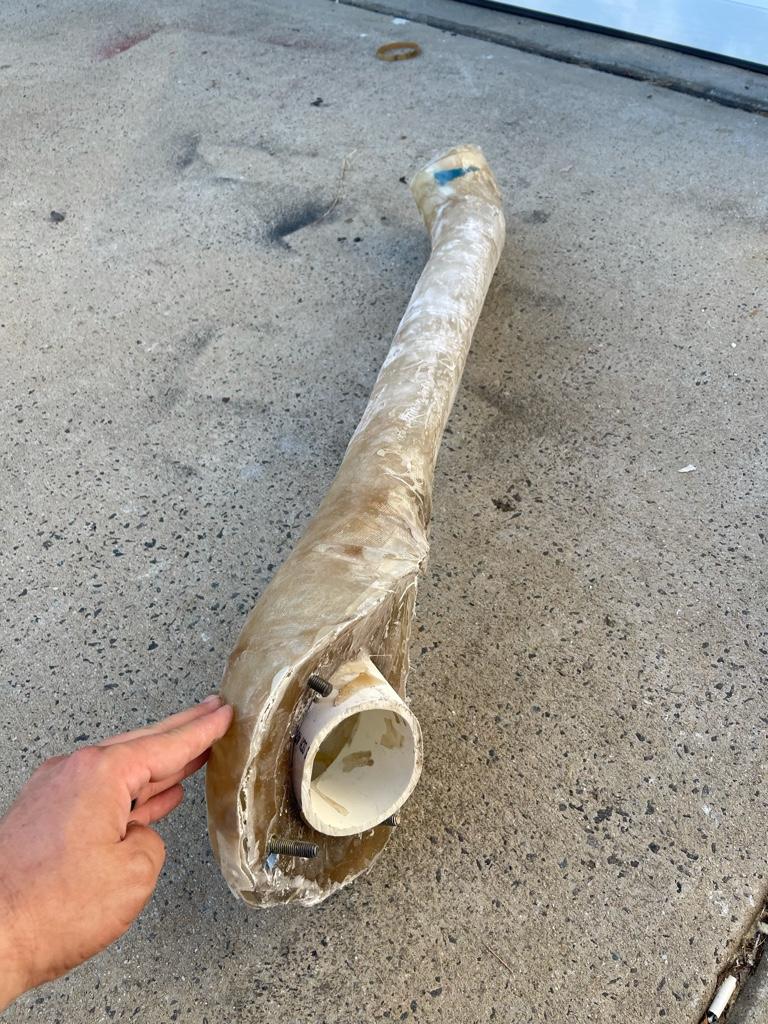

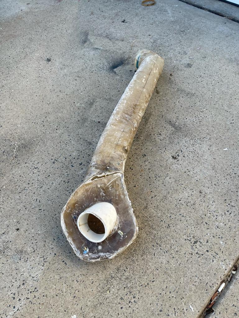

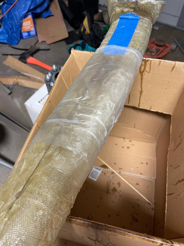

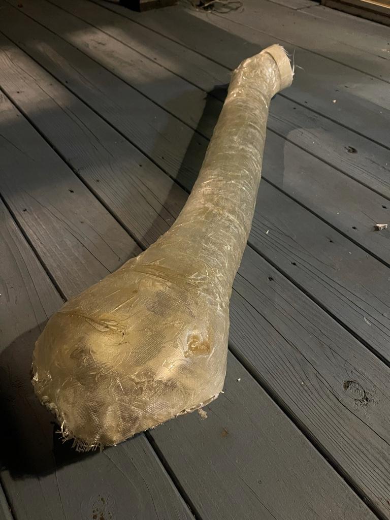

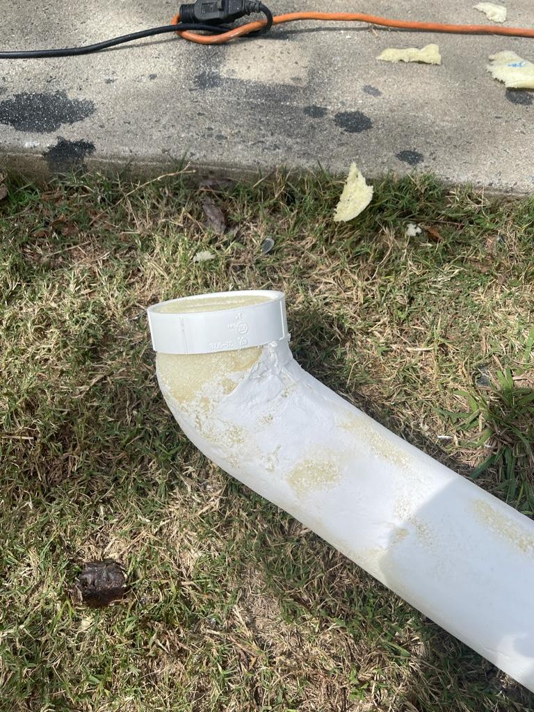

Well, it’s gonna take a bit more work but the foam is out . And by a bit more work I mean a lot… lol

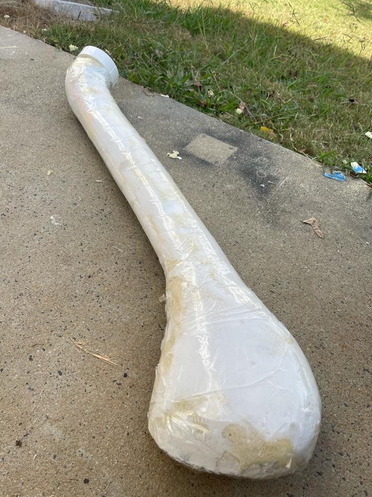

Here is the incision made to remove the foam, currently being patched up in sections before I continue with another solid layer of fiberglass to see if need to do 2 or 3 total layers.

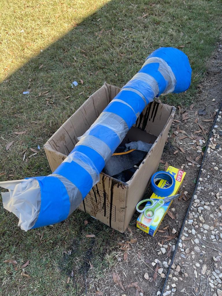

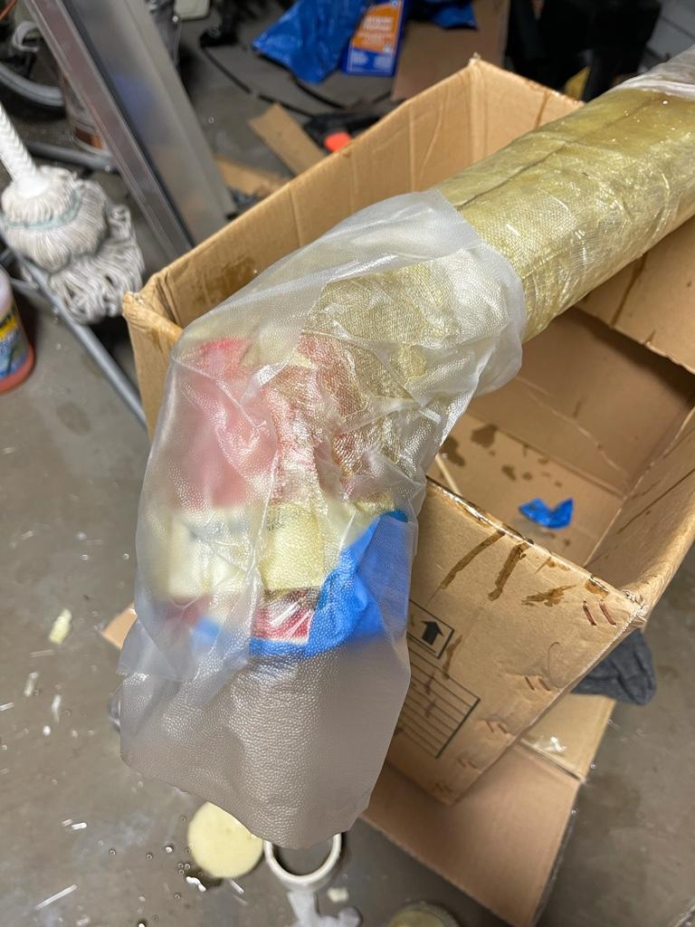

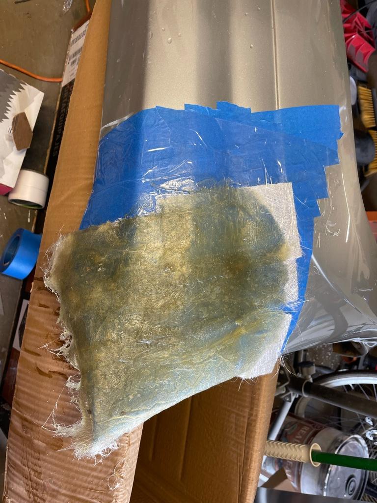

I found out that packing tape is a great quick way to create separation between parts you don’t want the resin to stick to.. pretty awesome. Also, the same tape or cling wrap can be used on the outside once the layers are down with resin to keep everything from rising up while curing and peels right off after the resin sets. I am thinking I will use this method on the final carbon fiber layup so that it lays down and cures as flat as possibly with minimal sanding left to do.

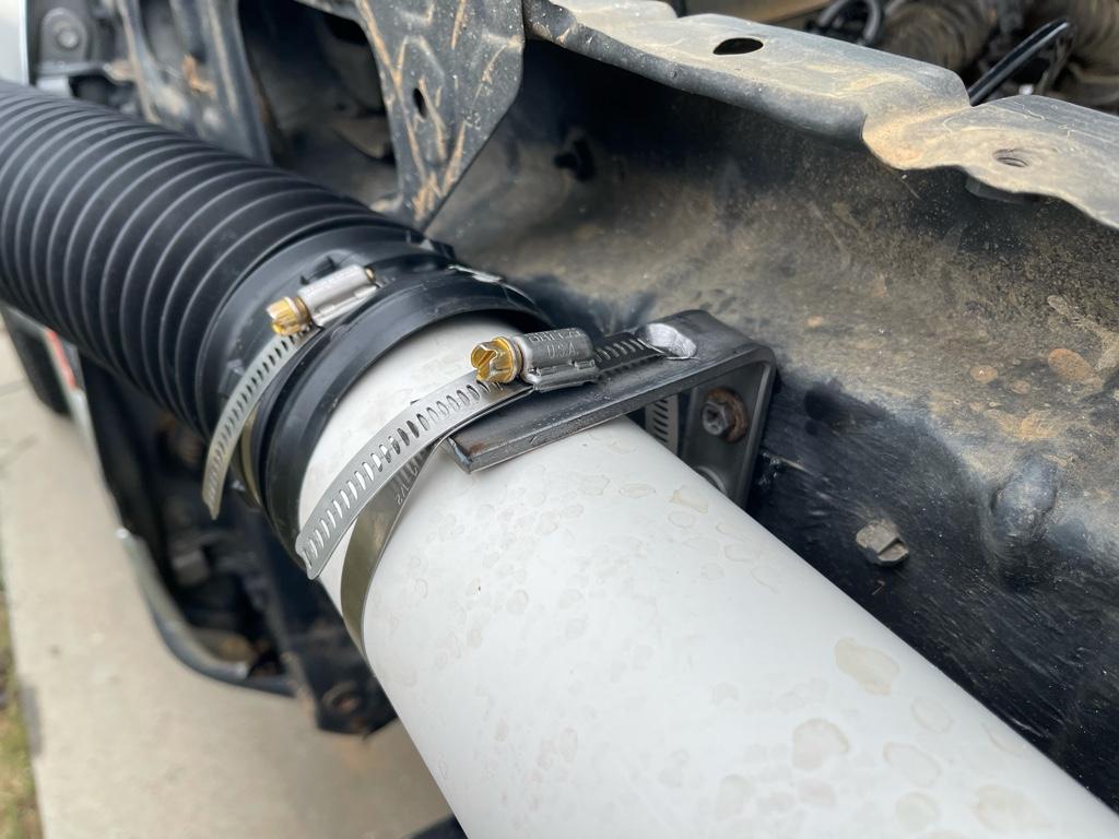

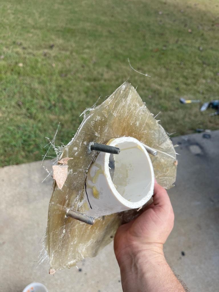

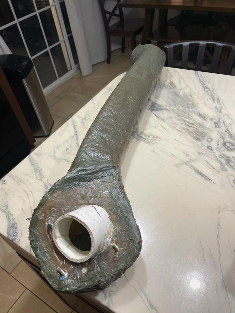

Oh yea, also, I came up with a much simpler ideal of creating a fastener point on the snorkel tube itself.. instead of fusing in an aluminum angle or making other brackets I plan to just drill 2 holes and install 2 screws from the inside of the tube with a nut and washer on the outside to secure them in place. This would them mount through the existing bracket on the A pillar and fasten with some acorn nuts for a nice finish. This will also give me the ability to fine tune the distance between the tube and bracket via more or less nuts/washers in between. What I haven’t decided is whether I want to do this before or after the final layer of carbon fiber.. not having the bolts there would make wrapping the carbon significantly easier.. decisions decisions..

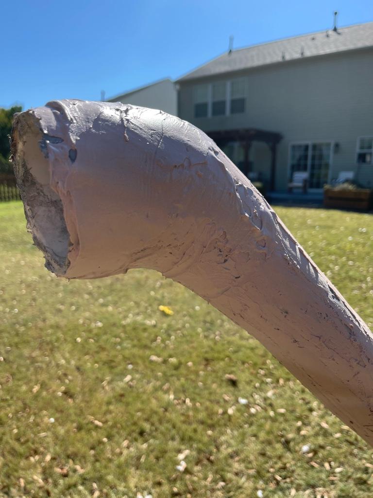

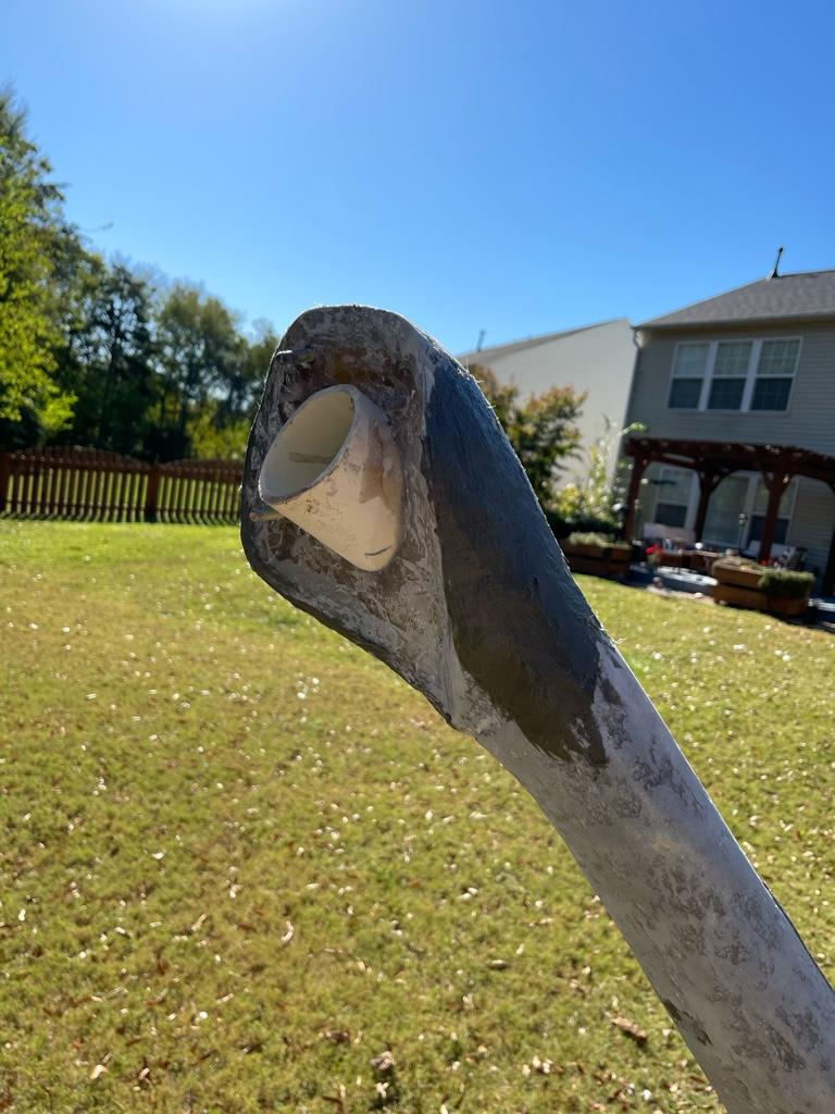

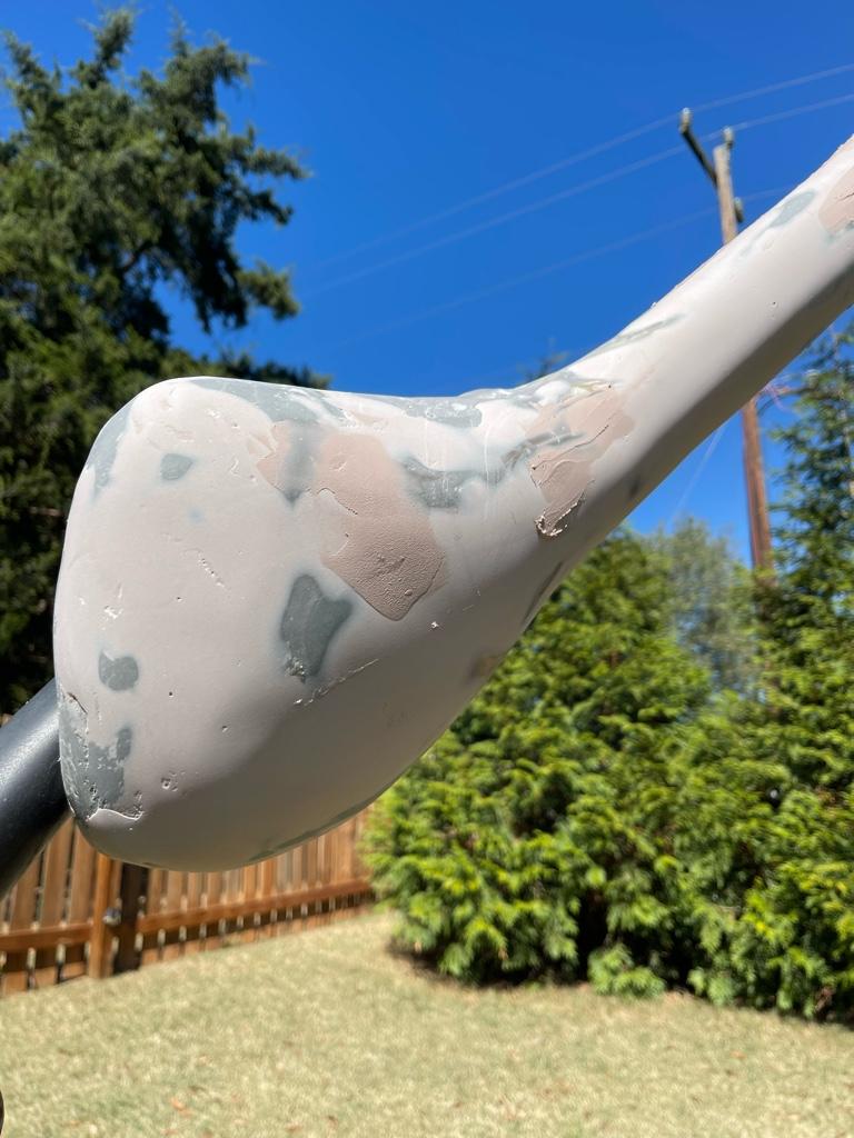

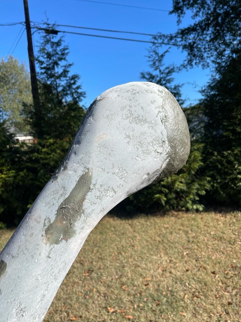

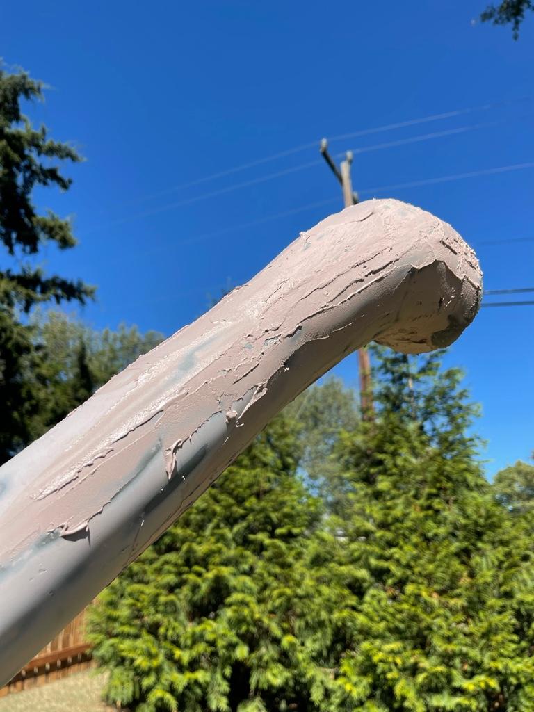

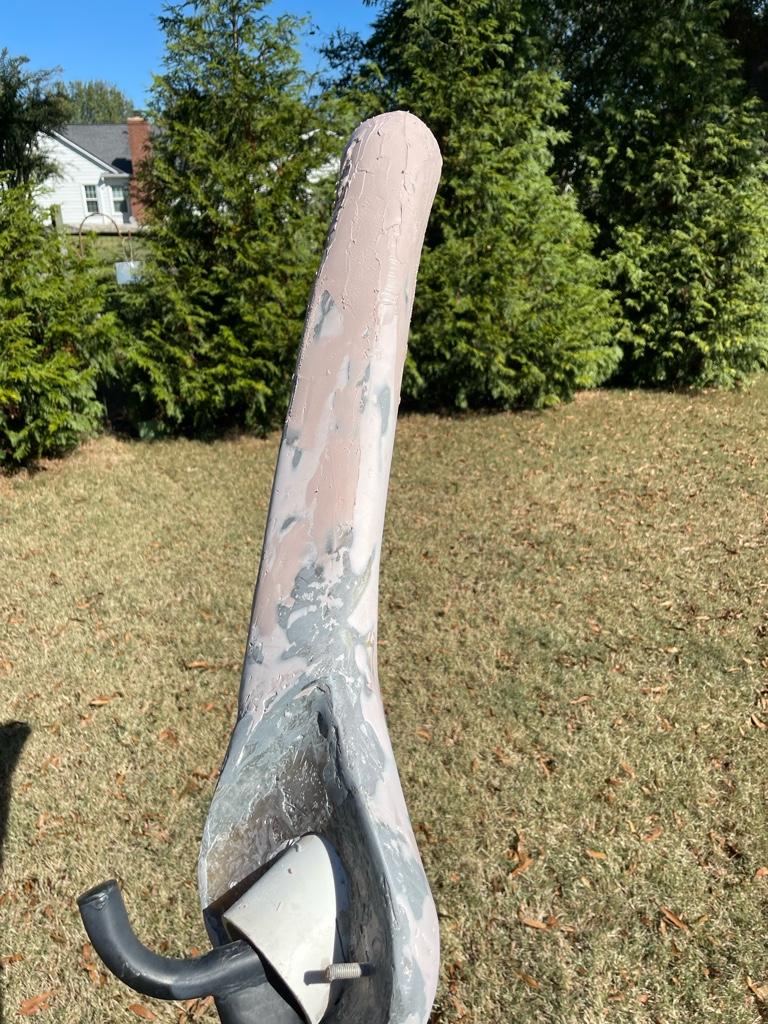

Still got some sanding to do, and then some more and more and more, but it’s now one piece. The plan for today is to add some bondoglass reinforced body filler and do some more roughy shaping before moving into regular body filler to give it the final smooth finish before laying on the carbon layer. Also need to drill and insert the 2 mounting bolts.. we’ll see how that plan goes
Made some progress with the bonzo glass reinforced filler today. Waiting for some 80 grit pads to show up tomorrow to shape this down before I hit it with body filler. This stuff is super strong, but did add a little bit of weight.

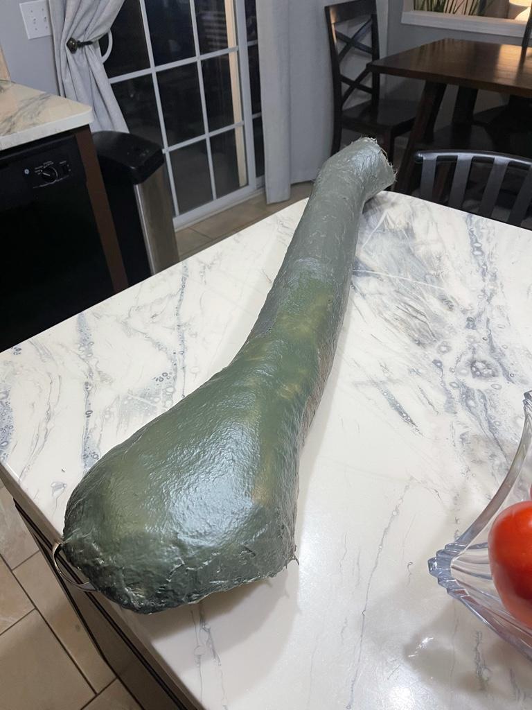

Hats off to the body work guys .. you make this stuff looks easy, it is far from it lol. This is after round 4 of sanding and filling. Finally onto the body filler , hoping to only need a couple more spots to fill after the next sanding session and then I should hopefully be done.
Then I’ll need to Mark and drill the holes for the mount bolts and hope like hell I can get them in from the inside lol.

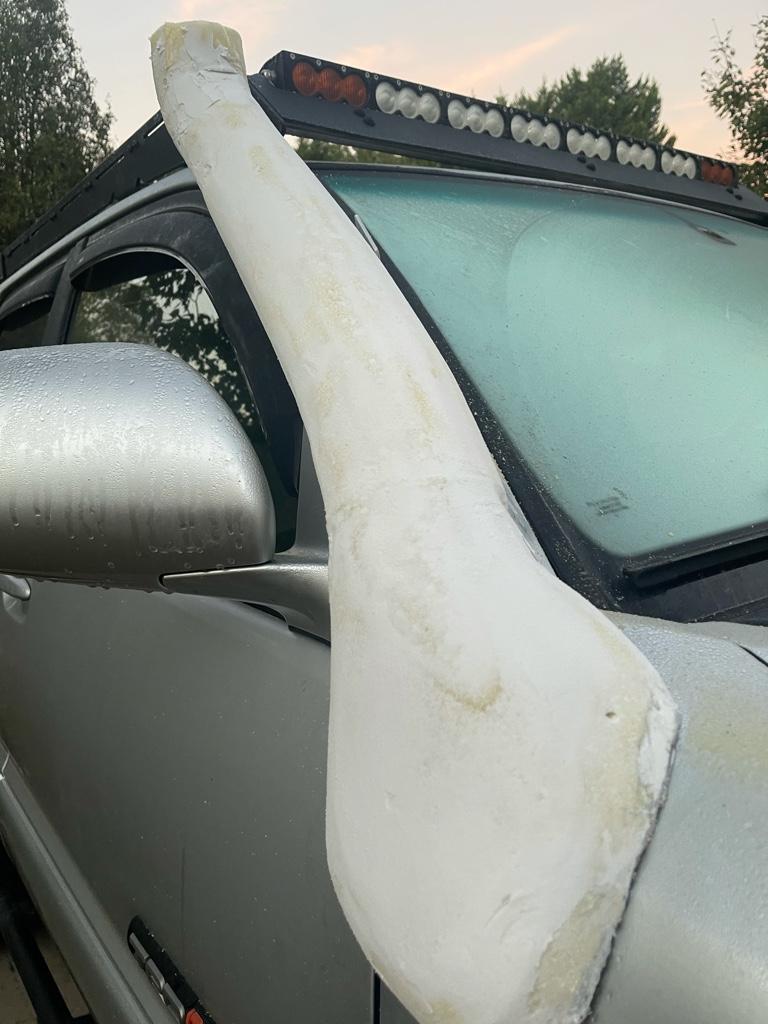

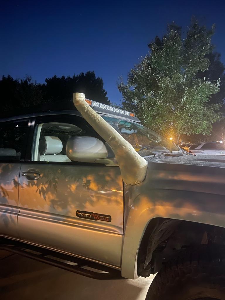

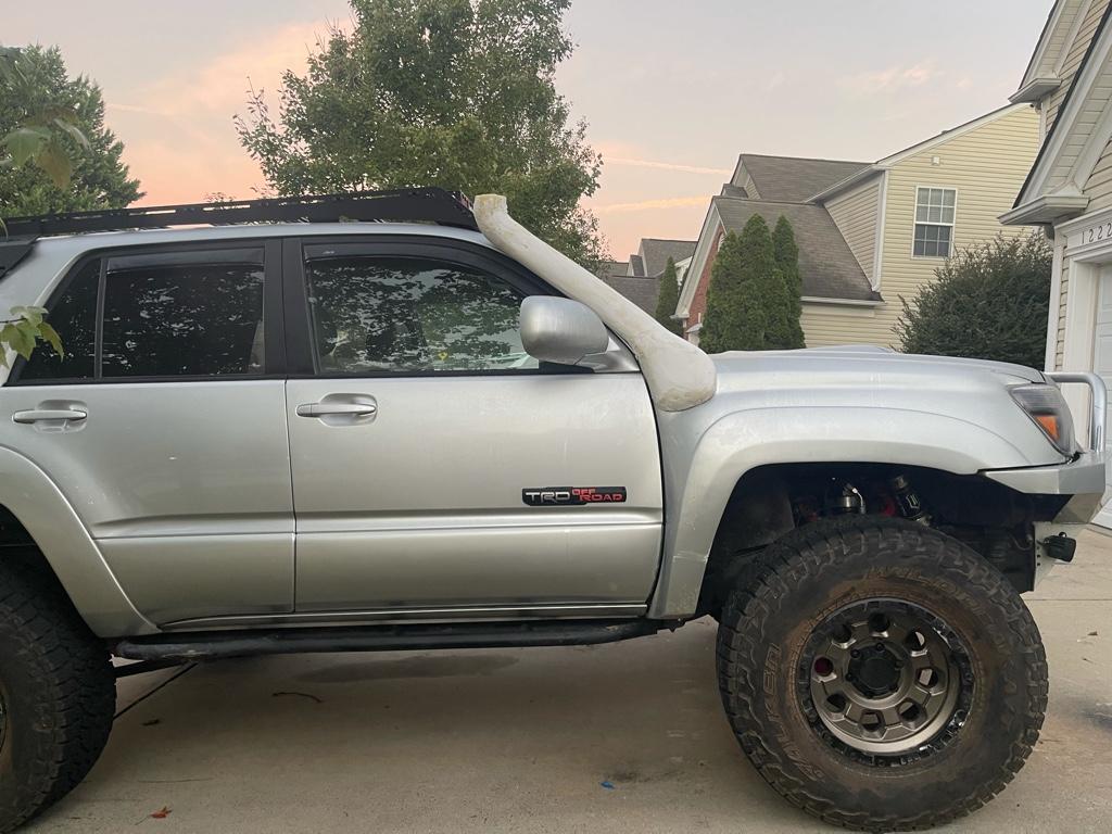

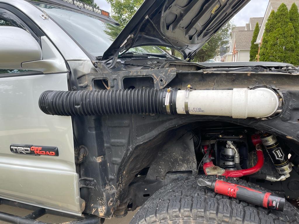

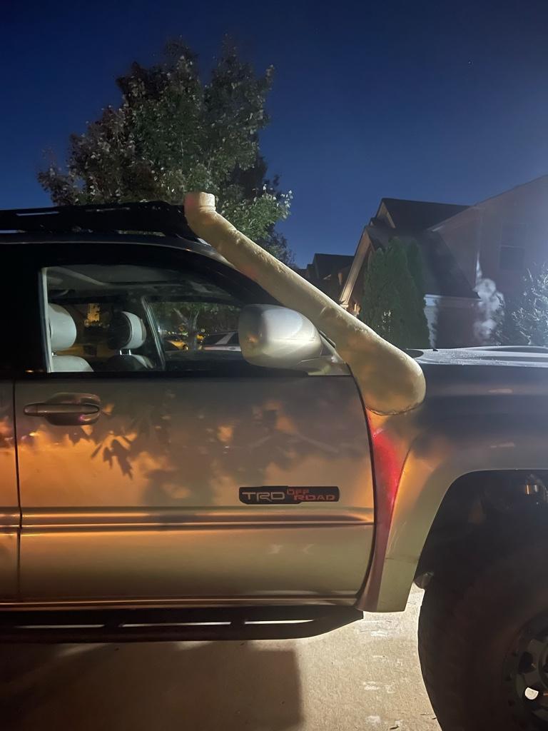

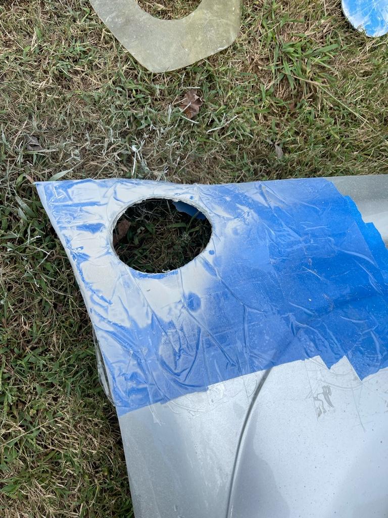

The fitment on fender is no longer 100 %perfect because the upper tube looks like it moved just a little either while I was doing the first round of fiberglass (since I elected not to mold it right on the car) or possibly after I cut it open and fused it back. Nonetheless it’s not terrible and I’ll planning on installing some sort of gasket on the bottom between the fender and backside of the snorkel so it should be ok. The challenge will be to figure out the last part of the piping run that will attach to the removable snorkel, not quite sure yet if my metal flex conduit is going to be the best route or if I’ll have to custom make another foam insert and make a short fiberglass extension tube that will run out to the rubber couple under the fender.
Either way I am hoping that another 3-4 days I should already have a finished carbon exterior piece and see what this thing will look like. Can’t wait. Lots of work but hopefully the end result will be worth it.

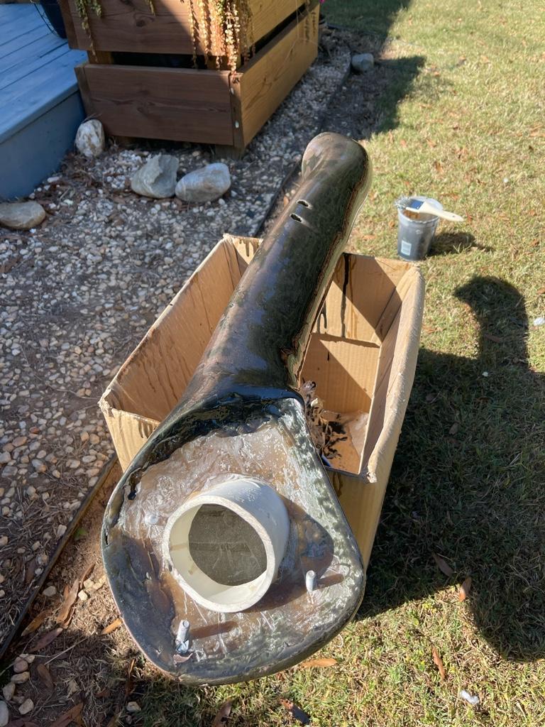

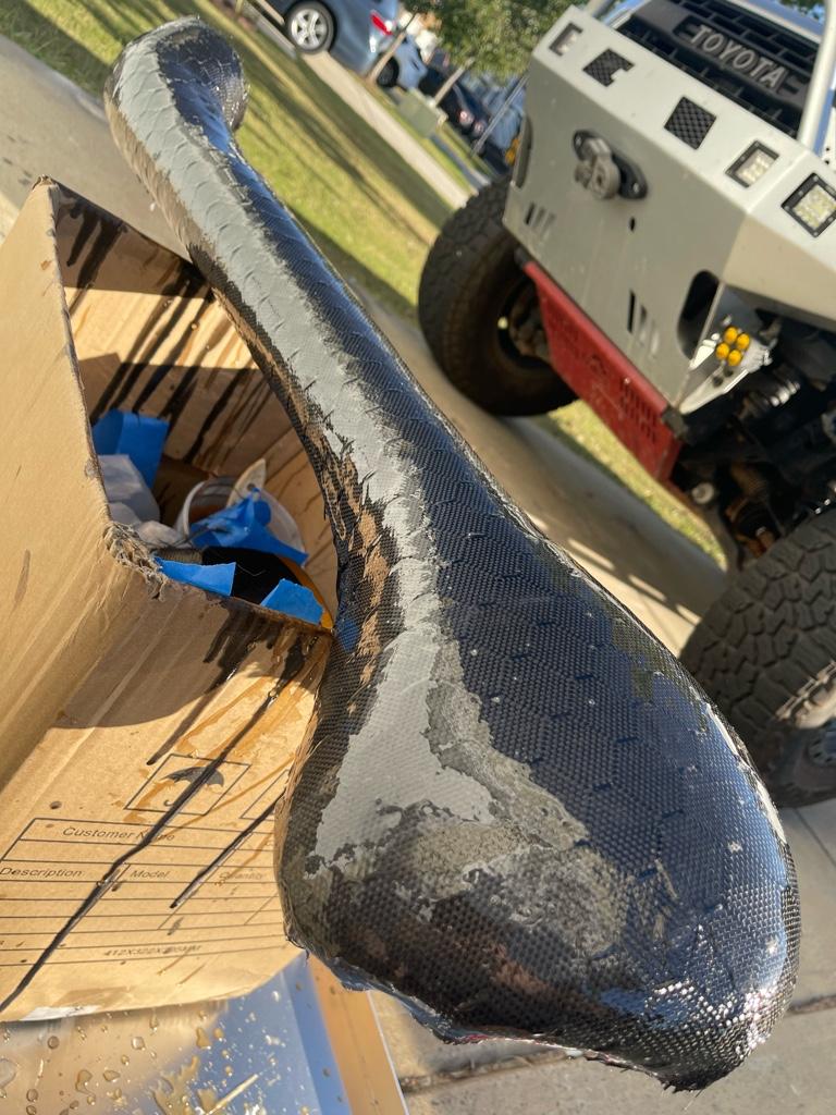

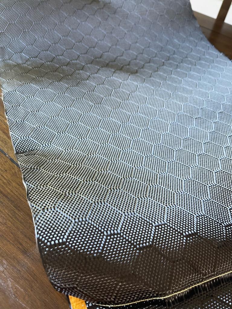

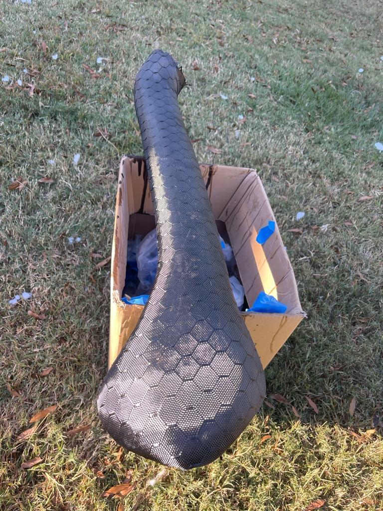

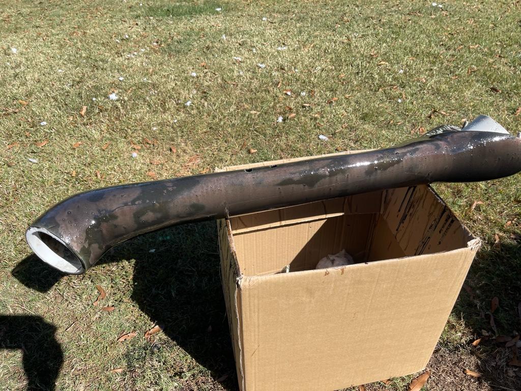

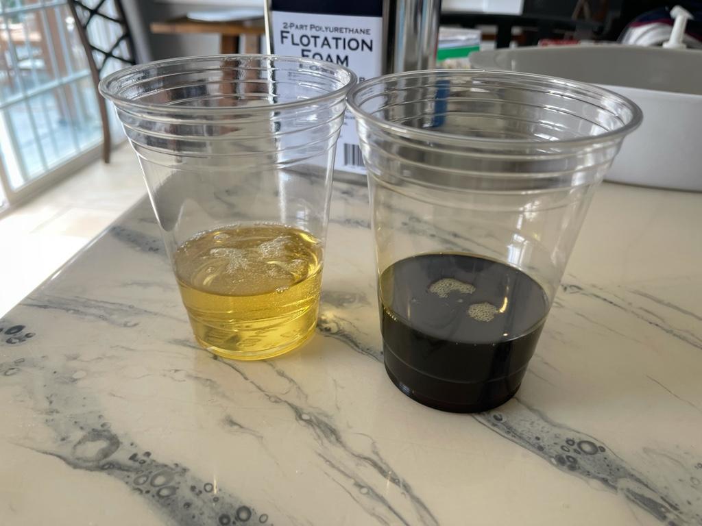

Well… wish me luck. The black -dyed resin coat is on and currently waiting for it to get to a tack stage so that I can drape the honey comb carbon over it. This is the most time intensive and nerve racking part because the tack time is like 2 hours and if you screw up laying down the cloth you’re pretty SOL and have to start over or call it quits on carbon appearance and paint it black lol.
After this it even more time intensive with 14 hour cure times in between next coats with lots of sanding in between. I am hoping I can lay this on nicely , at least on the visible surface and have this finishing out by the weekend so I can figure out the final piping connection.
