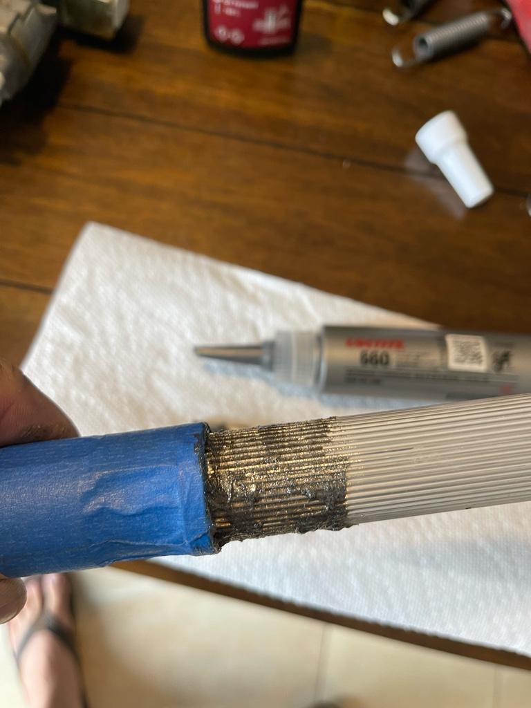

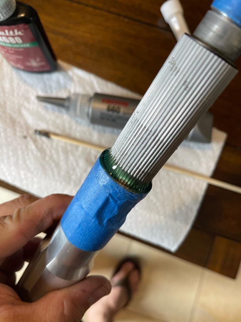

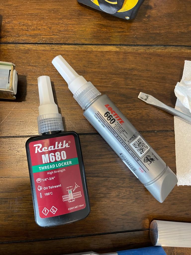

If the loctite 660 compound doesn’t fix it I may just let it be.. not sure if the non telescoping section of shaft is an option for a swap or not , looks like 2004 sr5 models had the non telescoping variant so that may be an option.

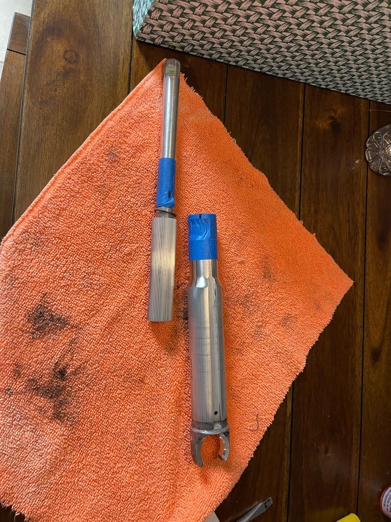

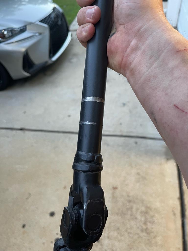

I just spent another hour messing with this damn steering column in an attempt to use the vice to squeeze the outer shaft into an oval and take the slack out. I found that rotating the shaft slightly to a different set of splines helped a little too. I thought I had it nice and snug and re-assembled everythng into the rig to test. Found out right away that I missed with the splined shaft about 130 degrees and had to pull the steering wheel and reclock it lol.
Soon after I discovered that i literally made no difference in the slop. :cheers:
At this point, as frustrating as it was to get it all apart and back together.. I have a feeling I'm just going to leave this damn thing alone and let it be. I don't think that the loctite 660 would really do anything and I will literally have to pull everything apart in order to attempt it before leaving it for 1-3 days to fully cure.. At least I have the peace of mind that there is nothing bolt related that is loose and coming apart, and didn't blow money on a new intermediate shaft to replace the u joint that ended up being 100% good.
damn it! I think i'm going to give this another shot... lol.
While doing some light reading on the loctite retaining compounds I believe I may have ordered the wrong one... the 660 compound is more of a paste and for larger gaps/keyways and I don't think I'll have much luck getting it between the splines of the shaft... but then i came across a forum where (though a different application) a guy had a similar issue with a minor spline wobble that he was looking to fix. It was suggested he use the loctite M680 compound instead of the 660 since it was a lot more fluid (kind of like their thread locker) and would fill smaller gaps up to .015" (which I think should be right in line with what I'm feeling on the splines) and has a better shear strength...
I have a tube ordered for Saturday delivery and will give this another shot.. One thing to keep in mind is that I'll have to set my telescoping feel adjust and leave it.. I'll no longer have this function if I want the compound to do it's job. It sounds promising from a few repairs I've seen retaining keyways that were wobbled way out.. so we'll see I guess.. Taking this all apart one more time shoulnd't be too be of a deal and I won't have to worry about clocking the splines since I'll just leave the U-joint lower portion attached and remove it off the upper shaft. This way as long as I don't turn it more than 90 degrees each way I should be able to line it right back up for a quick repair.
Only issue is letting it cure... I'll have to leave it untouched for at least 24 hours, probably the more the better. I'm just hoping that me messing with re-installing it doesn't impact how/if it cures. With the amount of spline contact it has I think I should be able to get quite a healthy amount of compound on there which is why it's making me think it may just work... I'll report back I guess. :thumb:

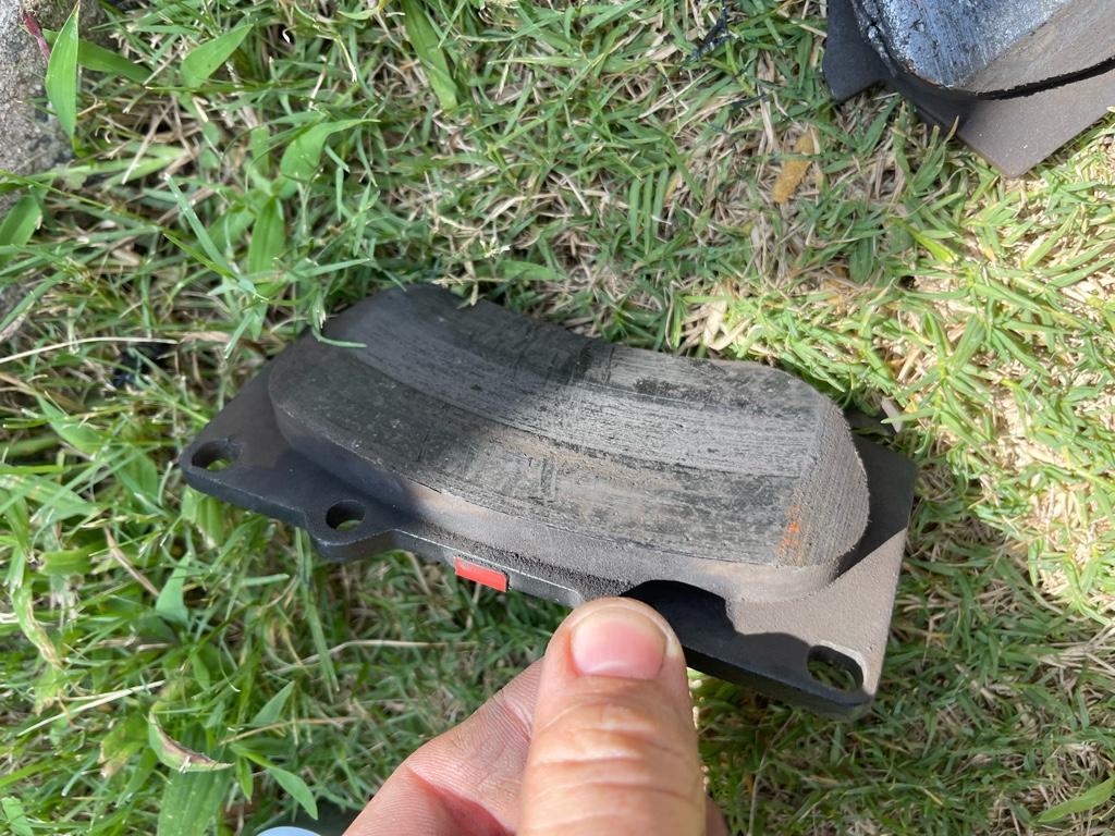

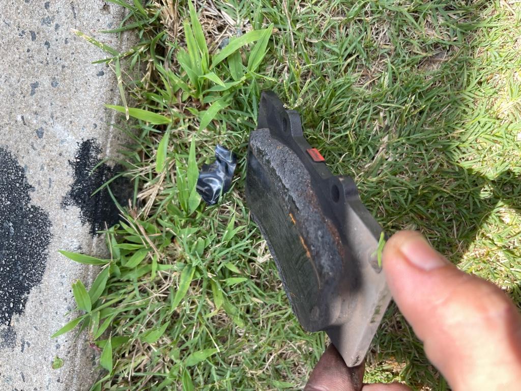

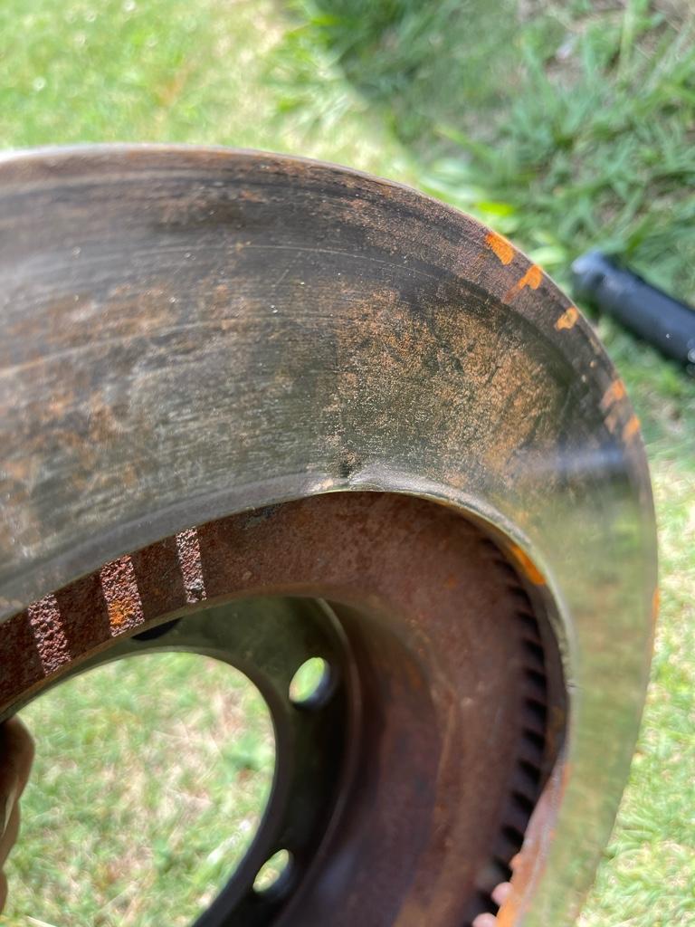

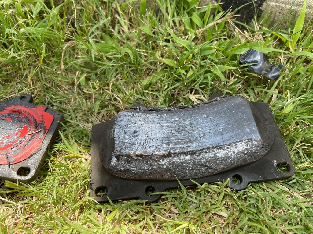

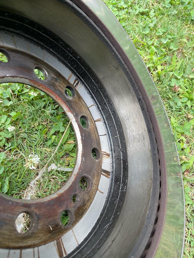

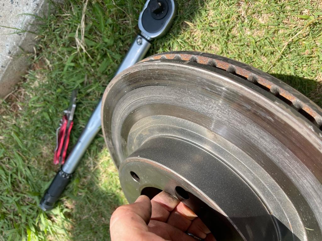

Out with the not-so-old-but-slightly-damaged-due-to-me-being-an-idiot rotor/pads and in with the new. Pretty proud of my job on this.. 1 hour in and out for both sides, which also included taking off the wheel spacers, cleaning up the threads on the studs, and chasing the threads on all the spacer nuts before re-installing. It's hot and miserable out so I try to not be out there longer than needed.
You can see some of the damage caused by the wheeling leaning into the wheel while snapping the caliper bolts. It honestly didn't feel bad, no new noises or vibration really, but I decided I was lucky enough already and not to take a chance. I went with 100% OEM toyota rotors and & pads so we'll see how they do.
I'll have to find a decent route to get the bedding out of the way.. but that may have to wait until later this evening. Excited to see how these perform compared to the Brembo pad/rotor setup I had which was cheaper than the OEM but felt to be good quality.

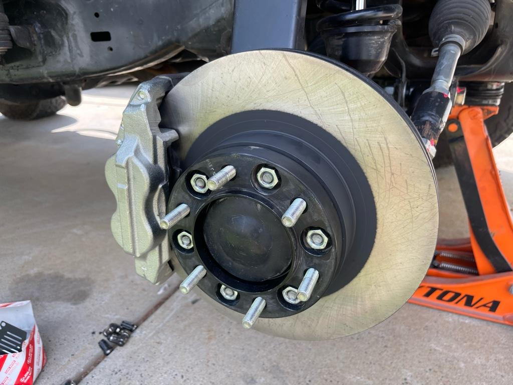

Oh yea.. I am also going up a spacer size for the rear wheels to see if it will resolve my rubbing issue on the TK1 racing sway bar without having to relocate the tabs for it. I looked at flipping it around but that would put the potential point of contact on the tip of the bolt which definitely would put a nice hole in the sidewall. At least right now it is rubbing a large smooth, rounded surface of the heim joint. When I get the rear spacers swapped out, Im going to swap the one that took a trip to the woods just to be on the safe side. Nothing should be wrong with it, and the studs shouldn't have been stressed anymore than they do with the wheel rolling as usual... but just for the last bit of added peace of mind..

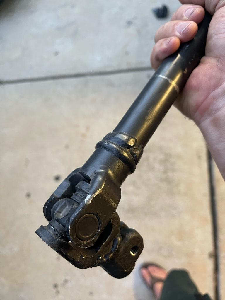

Looks like the 4th time around pulling the column is a lot quicker lol. As expected I only took 10-15 mins to get the assembly out.

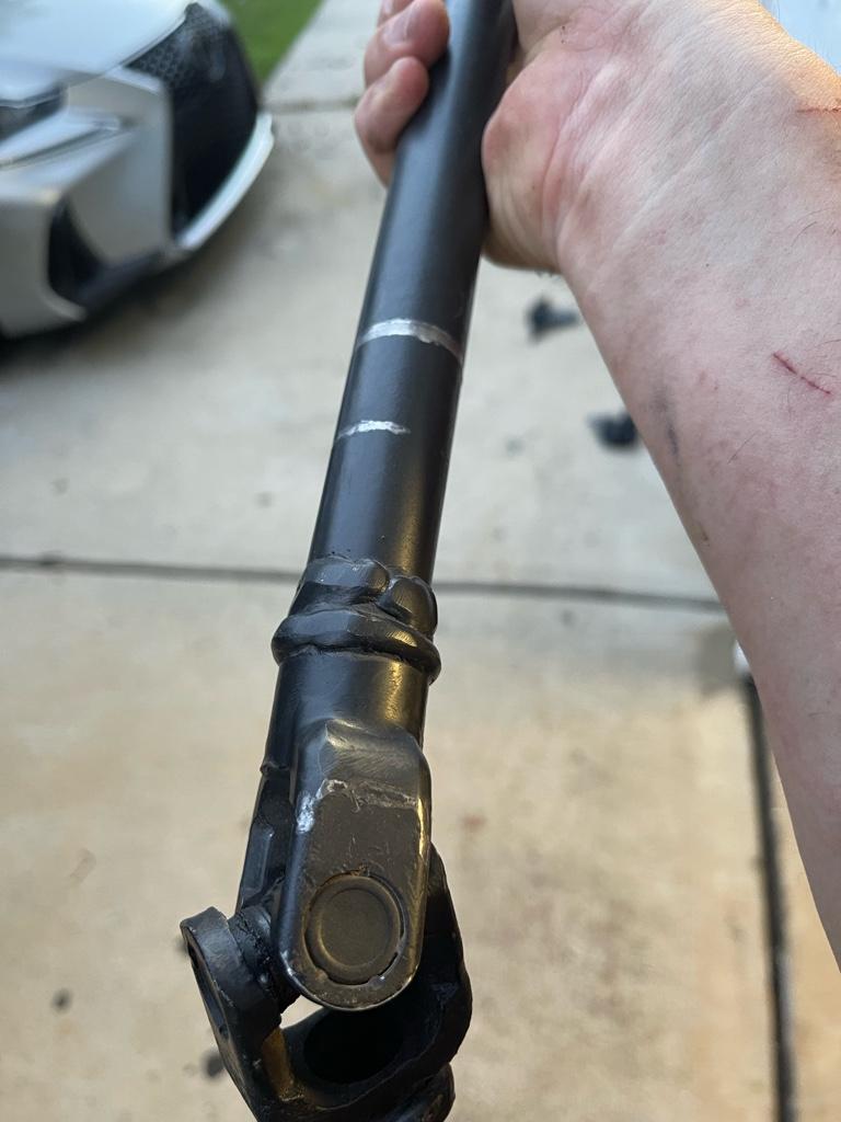

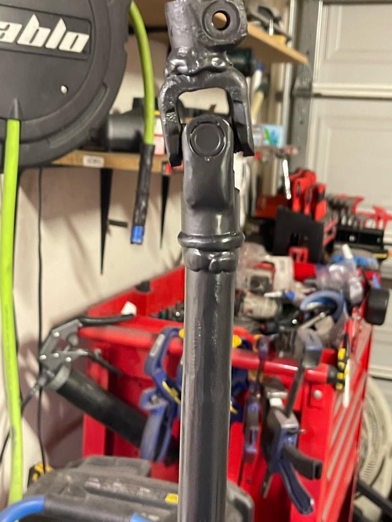

Here is my final attempt with the current assembly.. took some time cleaning up al the grease and marking the splines for quick alignment. Ended up using the 660 compound that is more like a paste on the lower section and the 680 compound higher up. I slid the shaft around a few times to get the fluid down and reassembled as quick as I could to let it sit and cure. Maybe I’m losing my mind .. but it felt kind of promising eve after a few minutes while I was working with it .. who knows.. maybe this will do the trick. I mean it holds messed up keyways in place which is a ton more load than I’ll see here. Only concern here is vibration that could maybe break it down quick.. time will tell. I’ll try and post the video of the slop.

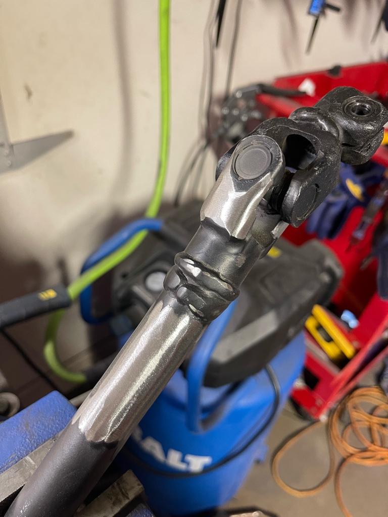

And while I was at it I decided to address the rubbing issue on the lower shaft.
Not a crazy rub but definitely interference.. since the shaft sidewall is pretty thick I decided taking off a mm or two wouldn’t hurt anything. The ujoint also had plenty of beef to knockdown a bit.
Tomorrow I’ll try and see if I can get a Dremel in there to sand the reinforcement I welded in as well.. just to be on the safe side.

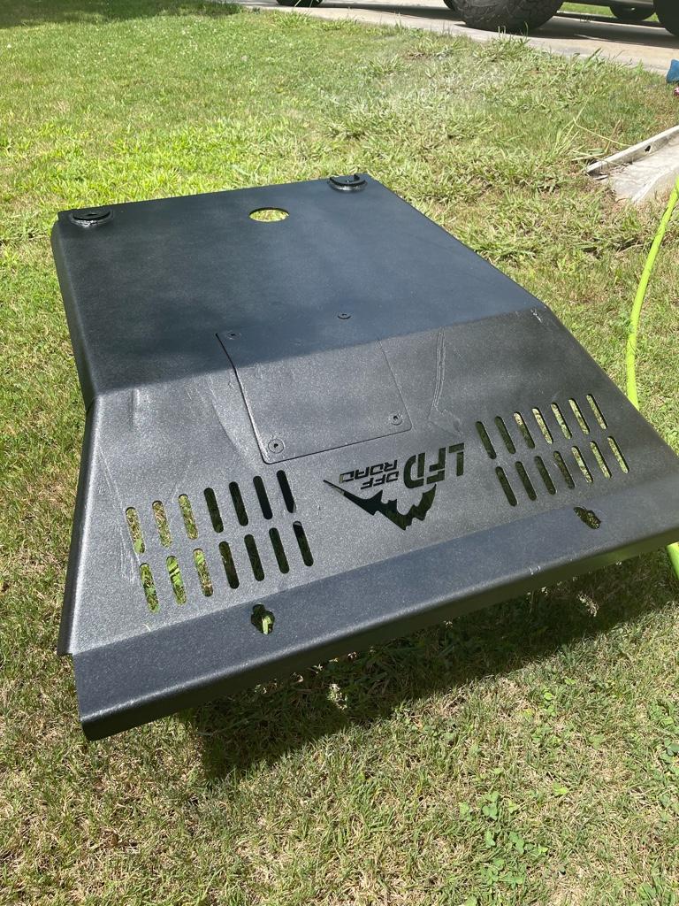

Did a little work today.. got the Amazon axle and one old spare that I had broken down to prep for an emergency trail repair that I’m hoping to never have to use.. lol. Still need to throw together a tool kit but making progress
Installed the lower steering shaft so we’ll see how the clearance works out. Couldn’t really get a dremel in there with the axle in place so hopefully what I did with the shaft itself is enough.

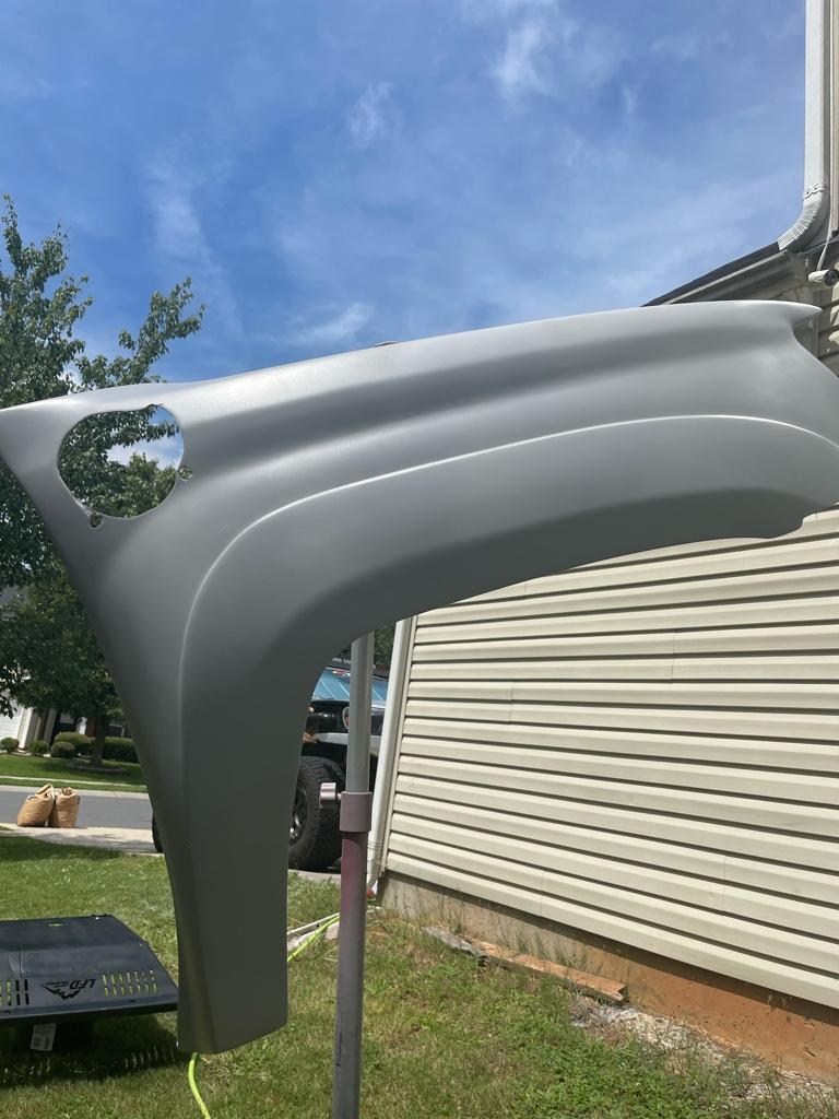

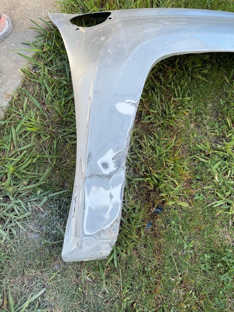

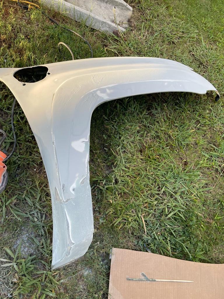

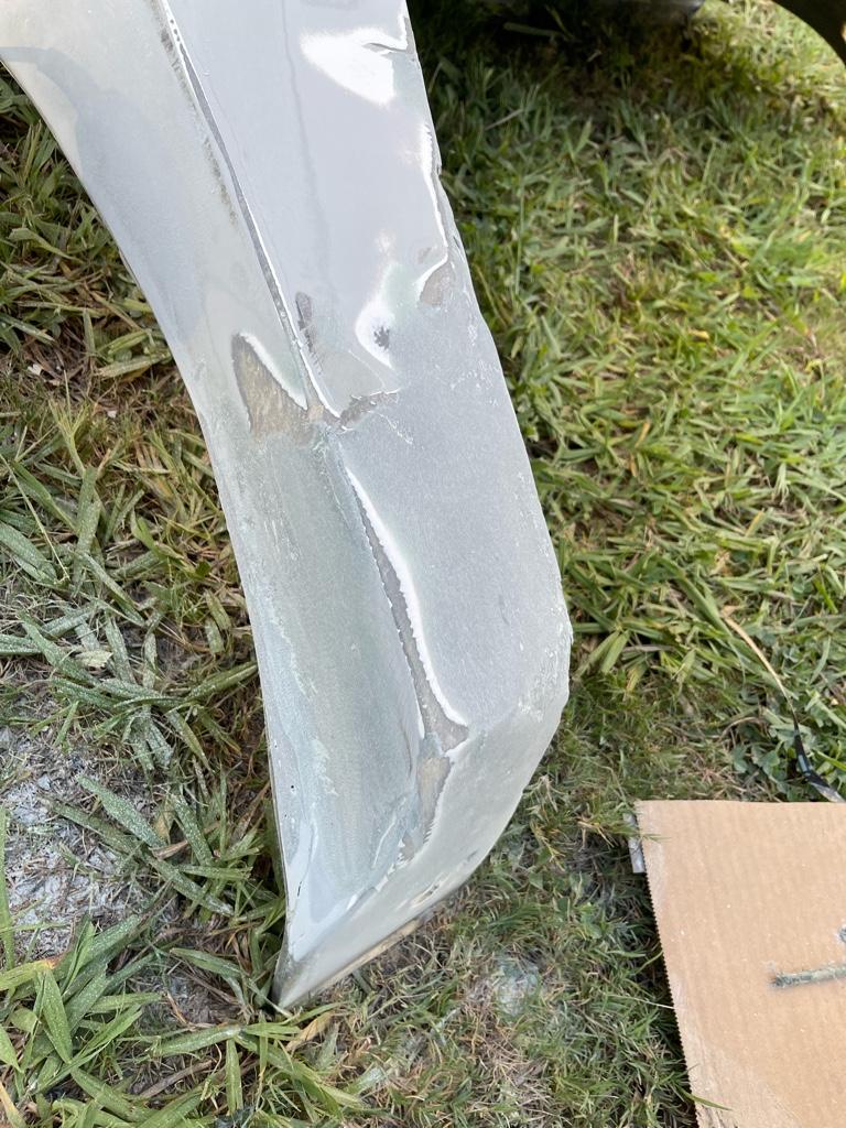

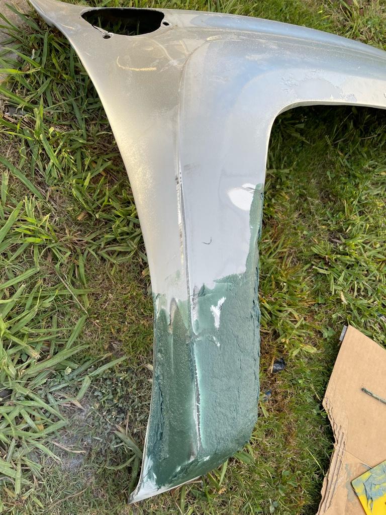

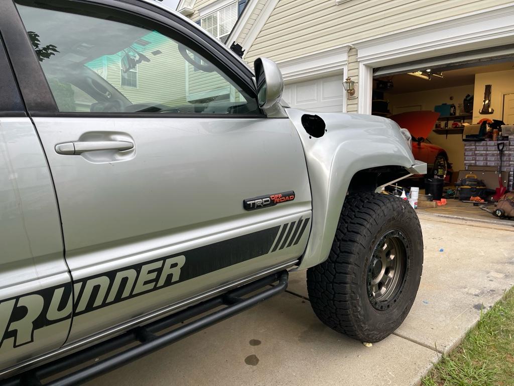

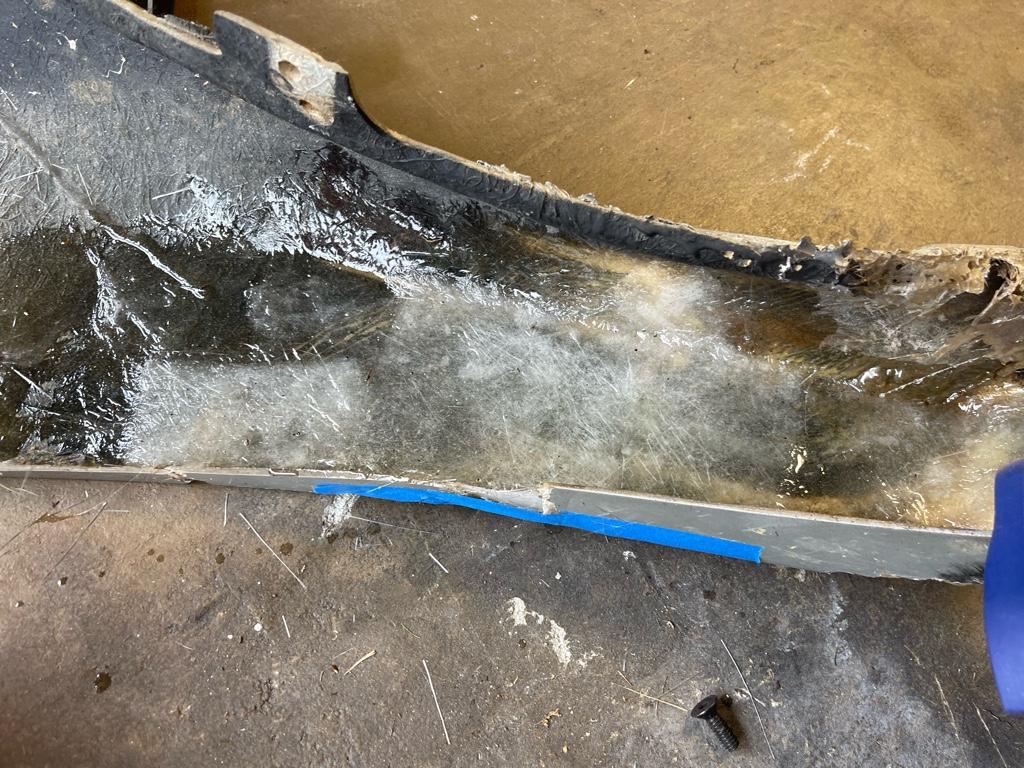

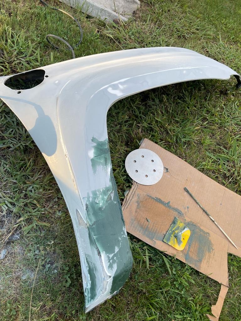

And I started repairing my injured fender.. let’s see how this goes.
Well I'll be damned.... I don't know how long it will hold up... but I'll tell you what... the dang on Loctite 660 and 680 did the trick it seems...
I left it alone to cure for almost 2 full days but just took a little time to throw it all back together and so far I don't feel/hear it clunking around anymore... no telling how long it will last, and I don't want to experiment with telescoping the wheel in and out as I'm pretty sure that will shear off the compound and possibly get it clunking again. I don't believe tilting the wheel should have any impact on the spline engagement so that should still be fine.
I'll drive it around for a while and report back I guess.
In other news, my grinding on the lower steering shaft solved the issue of the u joint binding against the frame. I don't see any more scuff marks. I did see the same radial scuff appear higher up but that isn't concerning much to me since it is only rubbing a tiny sharp edge that I failed to knock down. I may build my replacement shaft with a small OD tube if I can find something reasonable on McMaster, if not, i'll just grind it down a bit further and call it a day.

Well.. this isn’t taking nearly as long as I thought it would .. making killer progress on the buster up McNeil racing fender.
It’s almost like nothing ever happened.. lol. The only damage left is just internally to myself for making a mistake I did :)

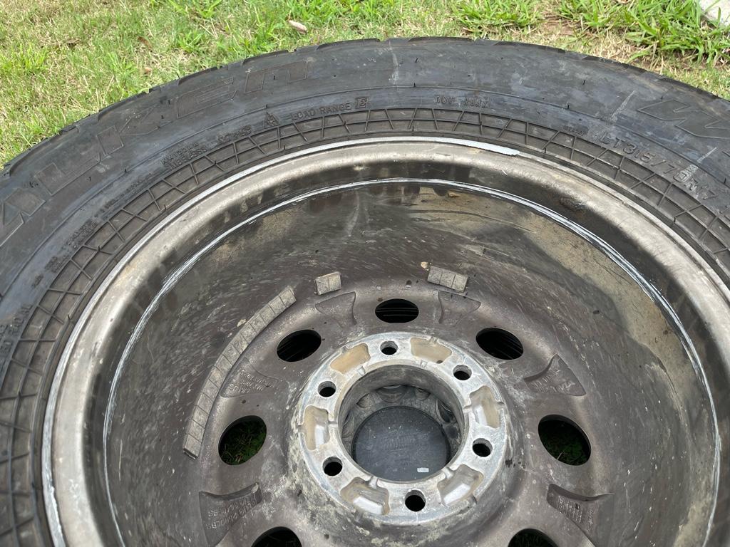

Think I need to get all my wheels balanced.. had a pretty bad vibration at highway speeds and pulled the wheel that went for a ride and found some good gouging on the inside which I’m sure didn’t help vibration.
I slapped on my spare but the weights from balancing last time have long fallen off.
Well, I was going to check and see if the addition of the new larger spacers for the rear was contributing to the vibrations I'm feeling... but after pulling them off I realized my TK1 sway bar hits the tire with no spacer on lol. :lookout:
With the wheel I have i need at least a 1 in spacer to clear it for on road, and looks like a 2" spacer (which is what I'm running now) to clear offroad.

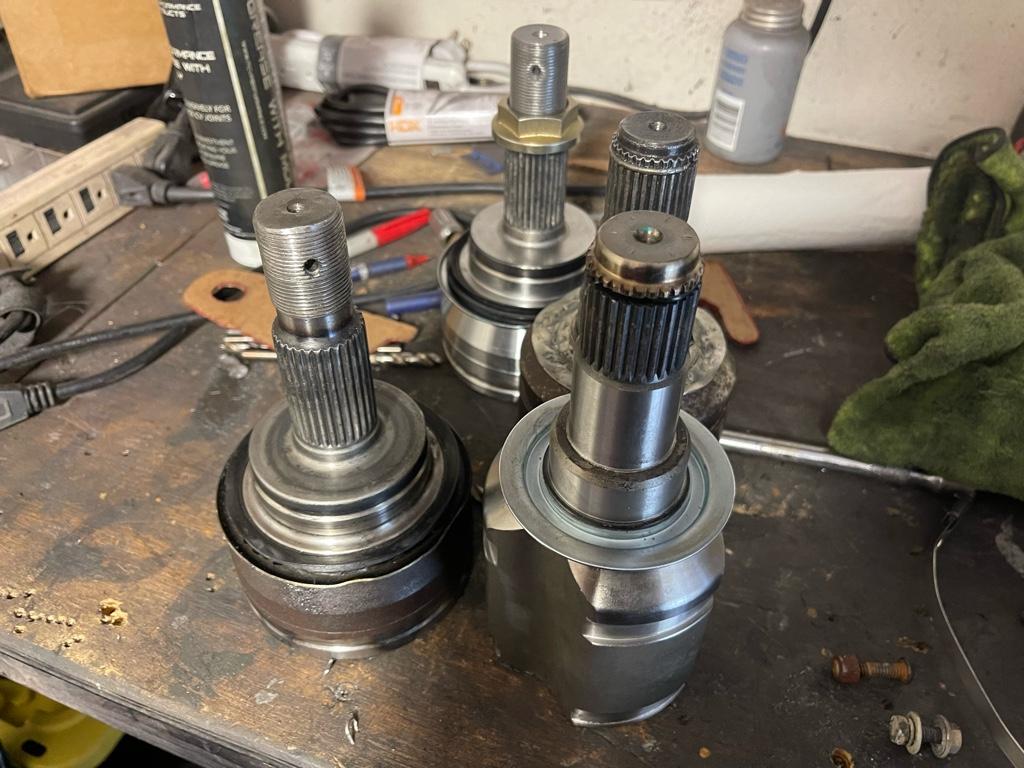

After blowing out the factory intermediate shaft in the front I realized just how heavy I am and how compromised some of the components are in my drivetrain. The thought of going through all of the work and effort to pull the rear axles and do the bearing swap on them and keep them stock just didn't sit right with me. The fact that I am just about full time 2wd unless I am off-road is loading up the rear axles a lot more than it would have prior... soooo I have a set of Nitro chromoly rear axles on order.. I am hoping they are in stock and not back-ordered for month so we'll see I guess. I also opted for a set of Koyo bearings to match what I was running in the front. Not exactly factory.. but I think they should do OK at least for 70K miles.
For the longest time I was dreading doing the rear bearings but found a nice youtube tutorial and a link to the ebay store with a sweet setup for the press to get everything off so I feel very confident it should be a straightforward process. It will probably take me longer to take apart and put the parking brake mechanism than swap the bearings... or so I hope lol.
With that said, this is going to be the last update/upgrade to the rig for quite some time (other than picking up the LT kit if the timing works out just to keep for the future). The rear brakes will be done today or tomorrow more than likely, but the rear axles and bearings will probably have to wait a month or two (given that I actually get the nitro axles on time) before I make some time to address those.

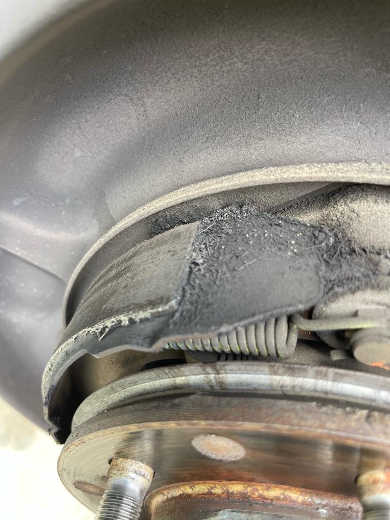

We’ll I’m glad I didn’t order any parking brake pads to go along with the rear rotor and pad swap… the parts are out for delivery so I took a minute during lunch to start tearing down the drivers side . And what do I find ? Looks my my bearings are on their way out and have started leaking bearing grease which is covering the shoes and the inside of the drum. I guess my bearing replacement parts can’t come quick enough and more than likely confirms my suspicion of starting to hear a bit of a bearing howl when on the highway.
Everything you see here is thick grease.
