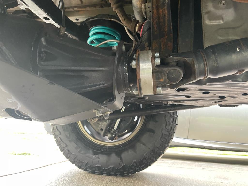

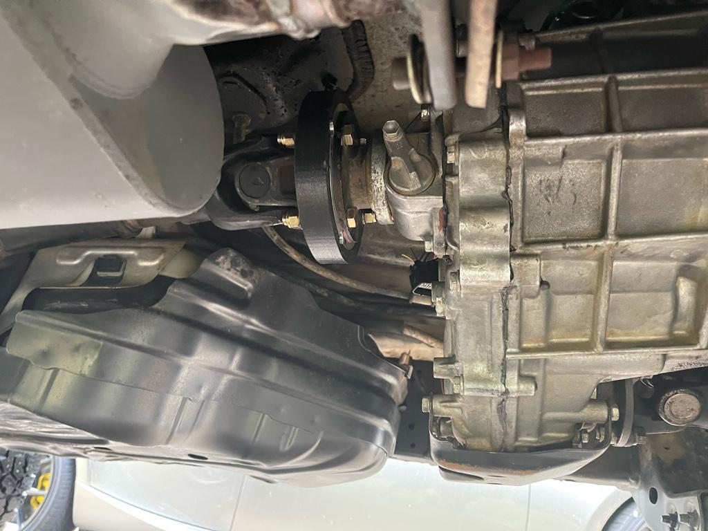

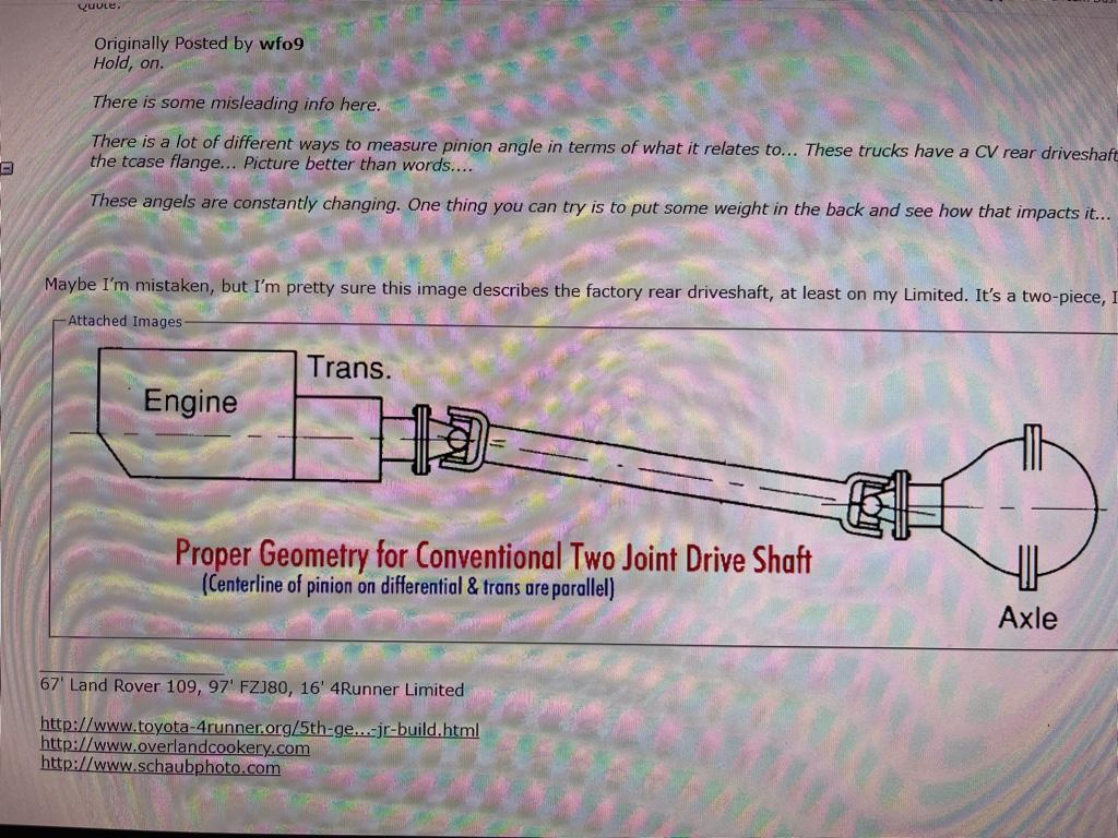

Fun fact... in my preparation to install the driveshaft space to ensure I have 100% spline engagement after shifting the rear axle back AND doing the FJ t-case swap I was looking to see about setting the "correct" pinion angle since I thought mine was off and not pointing as correctly as it should after moving the axle... and guess what I stumbled across? The fact that I was setting it up completely wrong from over a year ago and me moving the axle back actually got it more correct to where it should be...
I always heard that the rear diff yoke should point towards the output of the t-case.. well... that is very true... for a double cardan shaft apparently for a standard driveshaft it looks like you actually want your centerlines of the diff and t-case to be perfectly parallel .. I'm glad I looked into this prior to messing with adjusting the upper arms (which are a pain).. I'll need to doublcheck what my angle is now and it is quite possible that I will actually need to slide the lower arms further out to flatten the centerline, giving myself even more clearance to the door flare.
learn something new every day...
ps: this also gives a VERY good explanation as to why my passenger side upper link mount on the axle was hitting the cross-member above it near full bump prior to me moving the axle back... the axle housing was tiled too far back from where it should have been causing the interference.
So after posting this I ran out to the driveway and busted out my digital angle finder to see where I'm at. Surprisingly enough it looks like I only have .6 degree difference between the output flange of the T-case and the flange of the differential. I am not fully filled up, minimal gear in the rear and without me in it.. I am inclined to just leave it and not mess with it since it should more or less zero out if I were to load the rig down some so I feel like within 1 degree should be more than ok. Needless to say that is very surprising since I just arbitrarily moved the axle back via the lower links when I cut back the bumper lol.
Now I just need to unbolt the front side of the rear driveshaft and hope that the spacer I ordered finally has the correct hole spacing on it..
30 minutes later and the spacer is on the front side of the driveshaft at the transfer case side. Thats an extra inch of driveshaft length I gained back, whihc should about make it stock engagement on the splines again.
The rear spacer I believe was 1.5", this one is 1" and all said and done I should fairly close to stock and no longer worried about over extending on the trails with the dobinson's rear LT setup.
Only thing that is going to drive me crazy is that I now have yet another odd size bolt/nut setup, 5/8" for this spacer lol. I think my tool list will be fairly extensive..

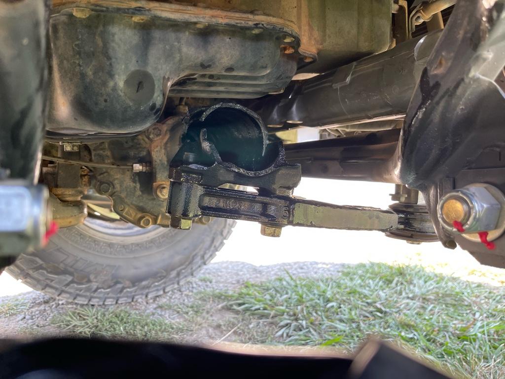

This is where my day took a turn.. Due to shear lack of experience and being completely stupid, I attempted a hard line that I thought I was lined up pretty good for. after a few attempts I kept getting hung up and all 4 tires were spinning. I backed up and repositioned a bit to the passenger side thinking I just needed to bump over whatever was holding me up.. at this time I heard my brother give a quick honk behind me which I thought probably meant "hey hold up i'll come spot you" but I felt like I had it right finally... as he jumped out of his rig behind me to come tell me to stop.. I tried to give it a little bit of sauce and after feeling the rig bounce just a bit and come to a stop I heard him say "oh shit you just busted something bad".
I jumped out and ran around to the passenger side where all I saw gear oil spilling out pretty healthy. First thought was broken axle... but no, it was intact.. the leak was coming down onto the skid plate and was further down line. Diff?? Could I have actually cracked my damn diff?? There was no time to find out, I was at the bottom of the most difficult rock crawl section of the trail with what I thought was only 2wd left and a 6000+lb rig..
We sent my brother up first in case I needed him as an anchor point to winch/tow up, surpringly I was able to slowly crawl up in 3wd. Locking the front diff still gave me the drivers side wheel and I didn't hear the diff making any noises so I proceeded. At the top of the trail we dropped the skid plate and found the issue..... I completely blew apart the axle shaft tube on the passenger side (or whatever the hell you call this intermediate shaft/housing portion??) There was literally a hole a the top and I had no drive to that wheel.

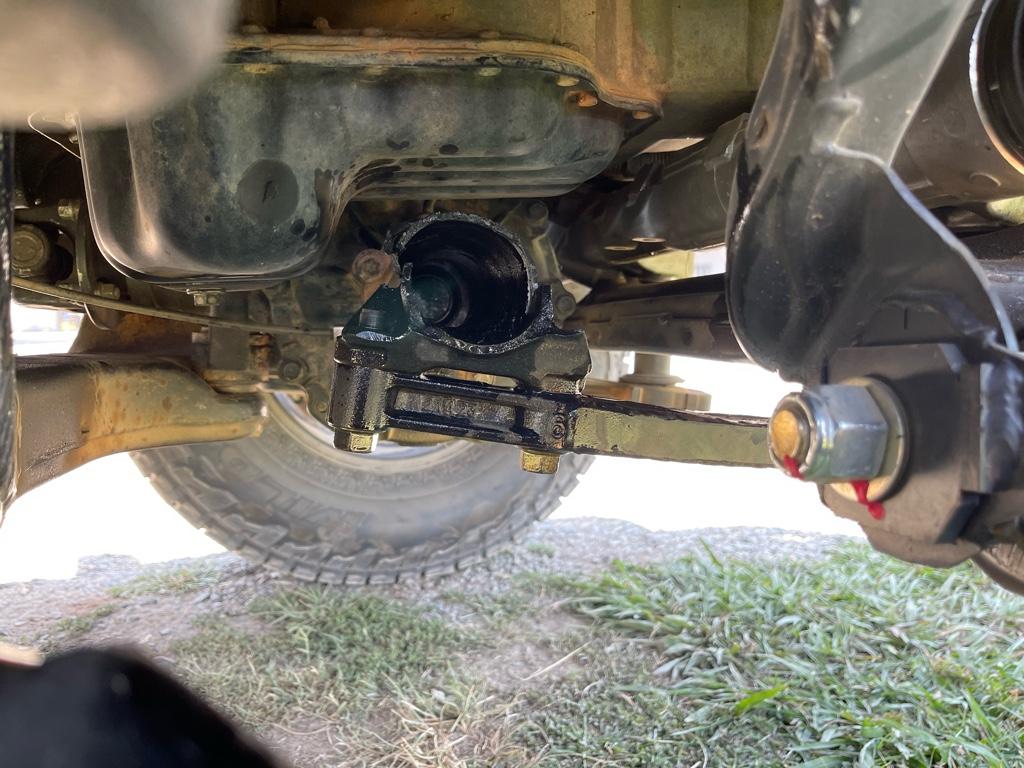

After a quick judgement call about how much fluid I lost and should have left I decided it was worth trying to get the rig off the trails. We made it off and out of the woods, aired up and went to the outpost gas station just at the entrance. My thought was I can get some gear oil, dump in as much as I could, and limp the rig home slowly.

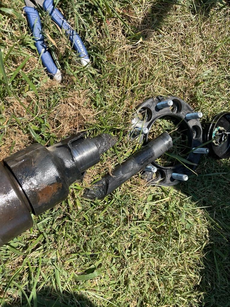

I then discovered that the couple of short miles off the trail literally separated the housing and at this point it was just hanging there on the other end of the RCV axle. . clearly there was no driving it home like that..
This is where my Stupid #2 came into play... "let's pull the axle, poor in gear oil and patch the housing closed so I don't overheat the diff".

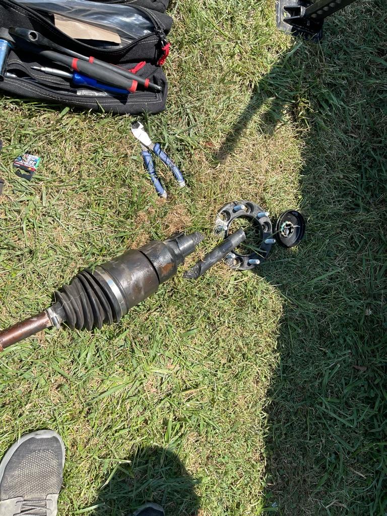

2 hours later we had the axle pulled, where I discovered that I snapped the factory intermediate shaft not in 1, but in 2 place and it blew itself out of the housing. Imagine the force it took to do that??? I think what happened was a combination of being locked with rcv axles, going from spinning wheels to passenger side abruptly stopping against a large boulder, and possibly the skid pushing up on the diff when I bounced down onto the rock that caused the carnage. I don't know..

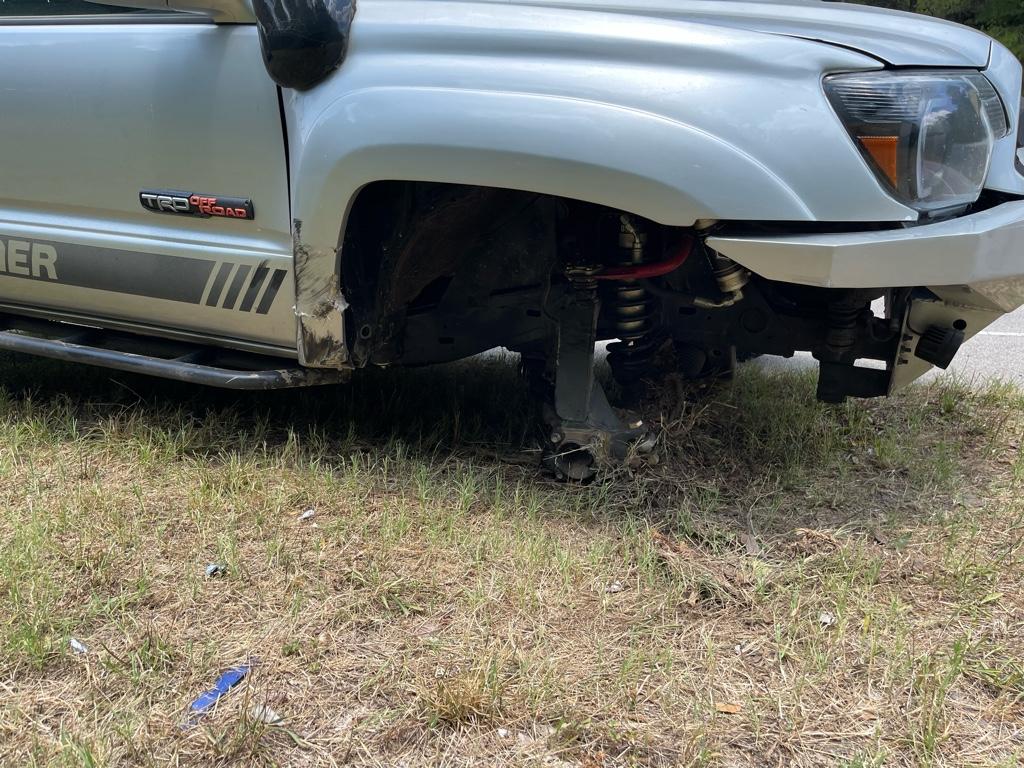

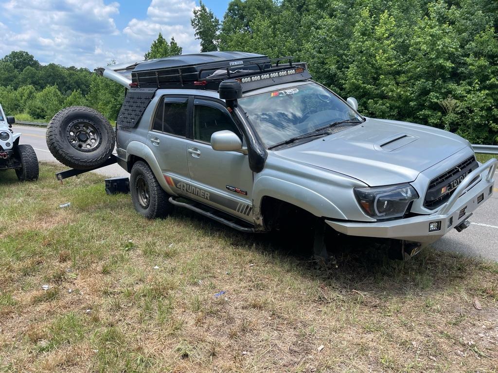

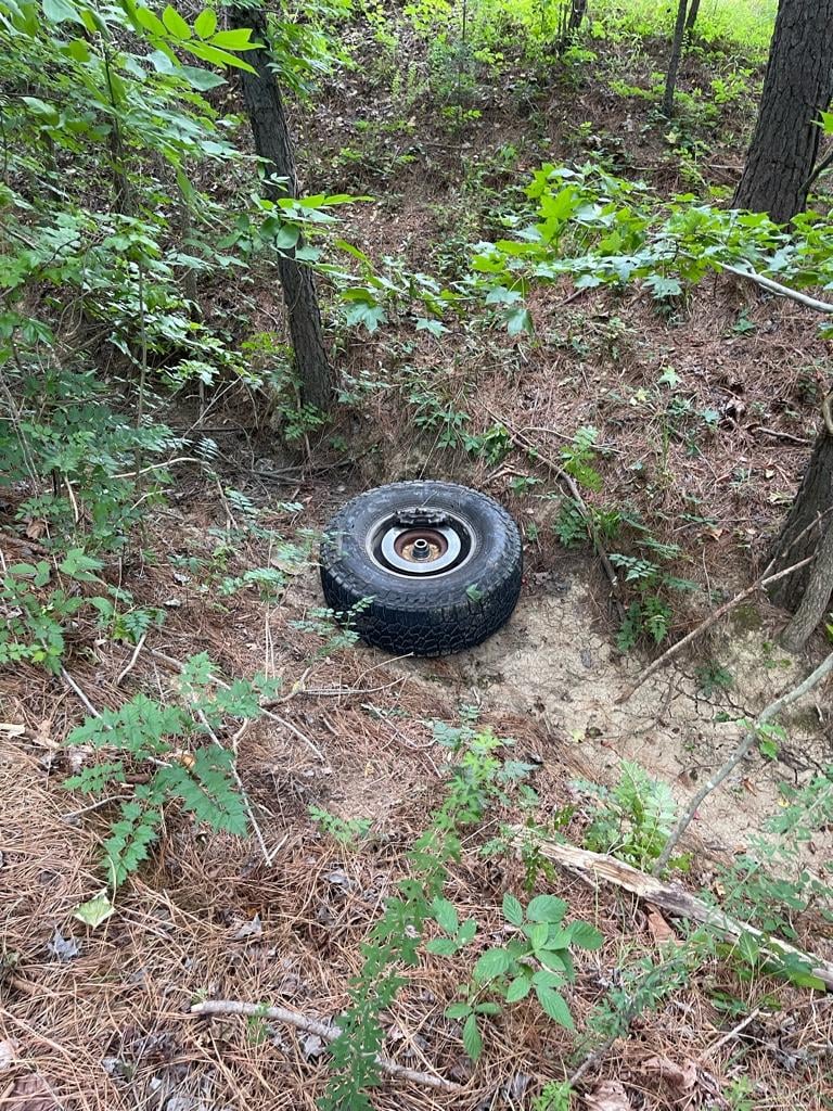

A mile down the road I started noticing that my wheel was cocked pretty far to the left to keep going straight.. I thought this is strange.. I just checked the rack and all the bolts and everything was still wehre it should be... what could be causing this?? In the middle of this thought, as I was going over a small bridge with guard rails on each side, the rig started pulling hard passenger. I was at about 50mph (maybe 55?) and started countersteering while getting off the gas and easing into the breaks. I coulnd't pull off immediately but saw the guard rail ending just ahead. At this point all I saw my passenger front wheel shoot up past my window bounce on the road behind me JUST in front of the car following me and then shoot off across the road about 20 feet in the air and into the woods down the embankment as I veered right hard on the break (with not much luck) .
By some grace of God, or whatever higher being you chose to believe in, I came to a very smooth stop when the spindle dug into the dirt on the shoulder. My initial thought was that my spacer has failed, I've see this before , or maybe sheared lugs or something , I've seen it.. In my disbelief I quickly called my brother and my exact words to him were "I'm ****ed dude, I just lost a wheel" .
Before I could process any of what really just happened, the car behind me stopped and the guy came around to ask if I was good and I told him everything is good and I was super lucky. The response I got went something like "Yea man definitely, but man.. I don't know how to tell you but it looks like you got you a little fire situation going".
I was confused as hell and got out of my rig to see what he was pointing at... yup... sure enough, I see 4 spots of dry grass on the shoulder smoldering with smoke starting to build up. One patch is probably 60-70 yards away and the other 3 closer. So in the 10 minutes following my wheel coming off I spent running back and forth stomping out the grass fire that I just started when my spindle sparked against the concrete as it shaved itself down. Luckily I was able to contain everything and keep it from spreading.
At this point I was able to finally come over and assess what happened. Pure confusion is the best I can describe what I saw.. No wheel, no rotor, no hub, no caliper, leaking brakeline from where it ripped out, and the bearing mounting hub still attached to the spindle. It then slowly came to me. When I realized what I just did it made literally sick to my stomach.... In my attempts to save some time and money to properly get the rig home I just about killed myself and possibly someone else around (luckily it's not a super busy road and the tire went off on its own journey with no harm).
My dumbass failed to realize that the reason the axle and axle nut are there are to keep the wheel bearing pressed into the hub... without the axle nut sandwiching the bearing, spindle and axle together it only lasted a mile before the bearing separated and shot the wheel off.. Stupid, stupid stupid me. Don't be like me. Don't be stupid.
All in all, this was the absolute best case scenario. I was lucky enough to have my brother with me to give me a hand both getting it off the trails and the ordeal that followed. And I was super fortunate to have my dad and his truck available AND him having a friend that let him borrow his skid steer trailed which we used to finally get the rig home. We spent a good 3 hours or so on the side of the road , in which time I was able to hike down and find my broken off wheel/rotor/caliper assembly about 30 yards off the road and about 70 ft down a steep embankment... talk about a word out to get that sucker back up out of the woods... I am still hurting.
Finding the wheel was blessing though... my brother had a genius idea to do what we just did but in reverse... use the axle to put the wheel on and hold together with the axle nut, which is what we did. after 30 minutes of trying we got it partially on and nut started. This allowed us to very quickly drive the rig backwards on the trailer and back down at home..
The damage:
So far, here is the best that I can tell from what I saw, thankfully the rack and everythign steering related I just did seem to be OK with no issues.
-blown up intermediate shaft and housing
-separated wheel bearing
-snapped off caliper
-torn off brake line
-2 lower spindle bolts are shaved just about all the way down
-Unsure on the balljoint bracket damage
-lower control arm is shaved pretty hard into the ball joint and for sure needs to be repalced
-torn CV boot on the good axle (DAMN IT! ) while we were offloading it .. the strap caught and tore the boot.. sucks.. but all in all I can't complain.
-my custom fender is pretty screwed down low, but nothing that can be fixed with fiberglass..

so I've been giving this a lot of though and scratching my head on it about how this could have failed... and I have a theory, which leads me to my STUPID mistake #3 (which played in with mistake #1)...
Last time putting on my skid plate, I noticed that before the plate bottoms out at the 4 attachment corners to the frame the very bottom of my diff contacts the plate. So that means that with the plate fully tightened, I'm already stressing the diff. Any impact that is taken by the plate is directly translated into the diff now...
If you look at my picture of the failed axle shaft and housing... notice where it's broken.. up top... like it tried to flex UP but couldnt... I bashed the shit out of my skid at the time this all happened... I am not thinking that it wasn't wheel speed and torque that did the damage... but rather something that shouldn't be flexing taking an impact load upwards...
Also take a look at the pic of the axle shaft that snapped... it broken on BOTH ends... and the end where the axle housing snapped also has a horizontal crack, rather than a clean vertical one like you see on the other side, and like you would expect to see from a torsional failure (i thinK?? )
What are you guys thoughts on this? I certainly havent heard of folks snapping this shaft previously... maybe my Stupid #3 really is what did it..

Glad you're safe man, that is a scary one. And thankfully everything that broke is relatively easily replaceable and not the custom fab parts. (quick edit: ooof the fender. crap that one had some elbow grease put in)
I've seen the v6 version snap because it has the ADD doodad, but never a v8 one. My guess is that the housing itself lets loose first, causing the shaft to noodle around and grenade itself within the busted housing. I think based on the setup, the housing itself would be in a bending failure mode. Even excluding the skid plate situation, that the housing is already in bending under engine load, so that would just icing on the cake. That would explain the circumferential and horizontal cracking of the housing, rather than an angled crack expected from torsional failure.
possibly the diff drop isn't helping because it puts the front bushings and arms at a weird angle that doesn't set it up well to resist the bending?
I have a slight update to my theory on the bending... my brother has dashcam footage (that i'll try to upload at some point, nothing spectacular) that shows the point of the failure, which doesn't show the skid hitting. You can hear an audible snap when the front right wheel come to rest against a bumper-high boulder. However, the skid is mashed in for sure, so at some point just prior to this I came down on it to do the damage. My guess is you're probably right on the housing going first, which COULD possibly have happened when the skid pushed up on the diff. I unfortunately have long forgotten any basic crack analysis from back in engineering school, but having one side have a flush break vs the other end having a horizontal component definitely suggests slightly different forces at play to cause the failure. No telling (at least by me) as to which occured first.. but at some point I snapped both ends of the shaft and blew them out of the housing..
I agree on the diff drop spacers... they don't help nearly as much as they hurt me. Those are coming out without a doubt. I'd rather tuck the diff as high as possible. I also need to ensure that my skid plate only protects the diff, but doesn't push up on it, which possibly means extending the mounting points with some welded tube or something.
Only thing that has me concerned slightly is the though of the entire diff being pushed up by the skid possibly having caused other points of failure, however, it does not seem that way at the moment.. The rig is at my parent's house, so i'll have to make some time to go take a look and start pulling parts. I ordered everything except the diff (which hopefully is at the local junkyard) and RCV is working up a quote for a set of boots and grease (I hope they give them to me on the low since they never sent me my original boot back.. but we'll see).
I went ahead and ordered the lower control arm ball joint bracket because I am fairly certain that is what I saw shaved just about all the way up. Maybe it wasn't that bad, but I bought it anyhow just to have..
