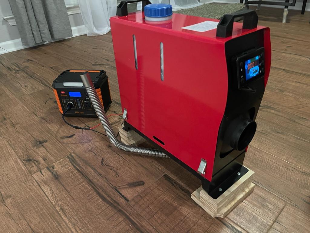

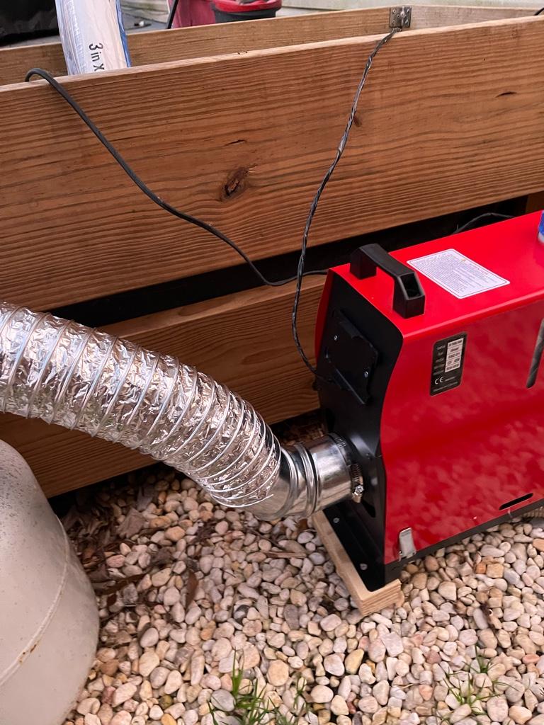

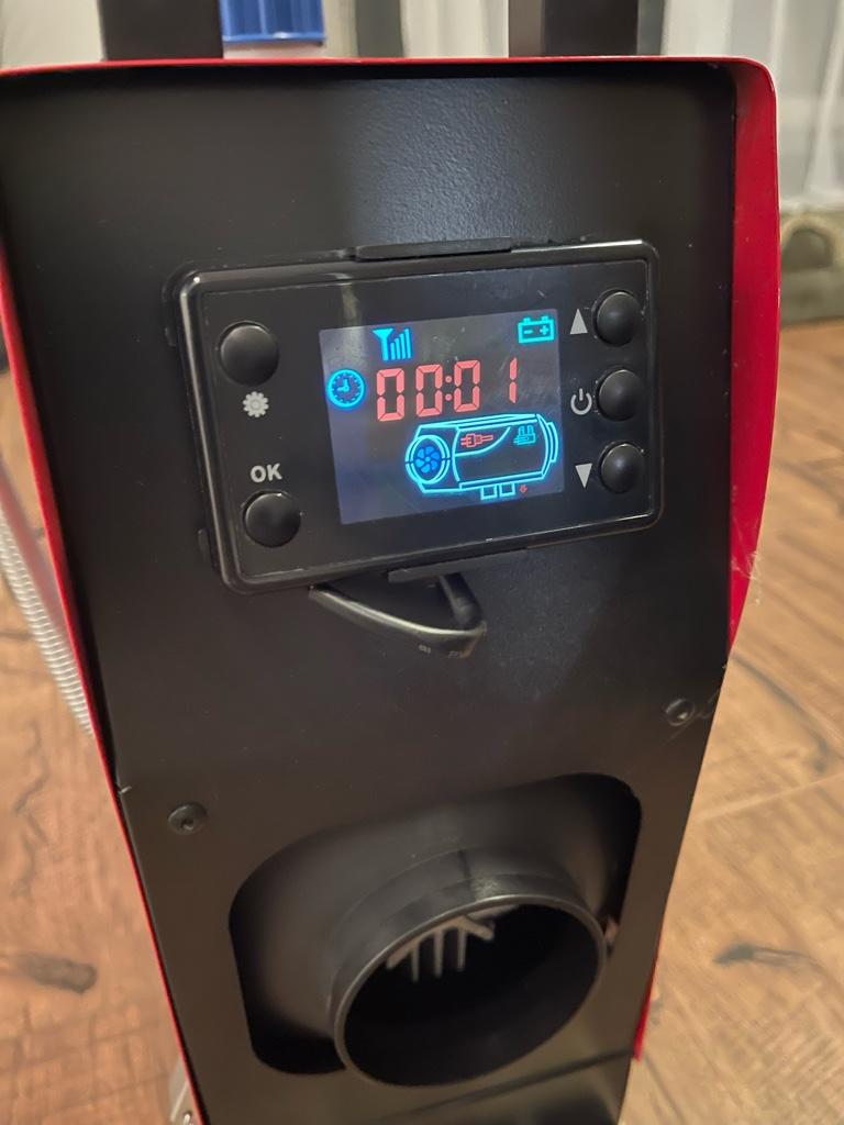

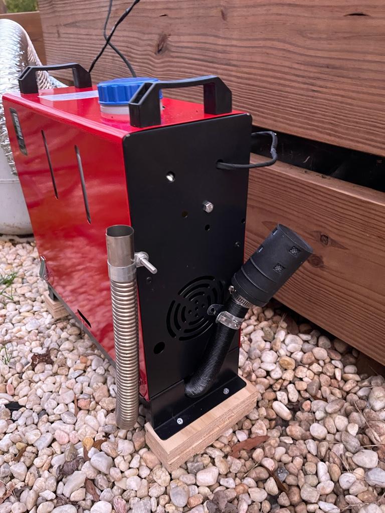

A little late to the party with the heater since it’s warming up .. but figured it could be a nice way to get out with the wife while temps are still low.
Decided not to hassle building my own to see if this is something that will work for my setup and the testing so far has been great. Not expecting it to last too long for just under $200 and if it does what I need it and fails at some point I’ll probably build my own into a more storable case with a nicer unit. So far the all in one setup has been pretty dang amazing.

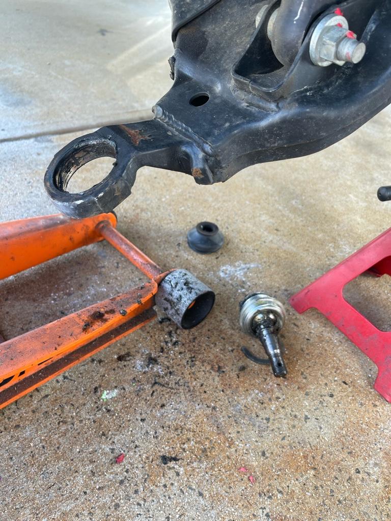

I was sitting here a couple of days ago and something dawned on me .. my initial idea of “temporary” cheap lower control arms is slowly turning into a long term solution .. which means cheap ball joints .. that’s coupled with 35s made me think of suffering another suspension failure on the road.. yikes.

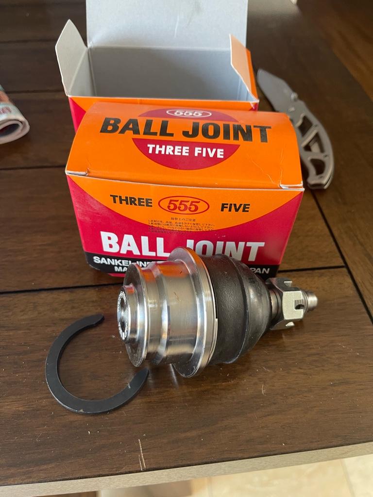

After doing a little searching I ordered a set of sankei 555 ball joints to throw in as an added peace of mind.. will try and tackle this in the next week or two.

+1 for the 555s ball joints. Been running them for a while with no issues. Also using their inner/outer tie rods.

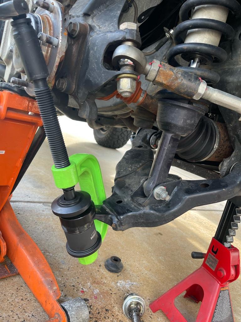

Well that was fast … and boy do these loom fantastic ! Gonna pick up the balljoint press from autozone for rent on the way to the office and hopefully get this knocked out this weekend !
Fingers crossed that I didn’t miss any bolts or torques.. lol
Piece of cake.. froze the new joints going in, heated the lowers and hammered out the old joints without an issue. Took a little figuring out with clearance without taking the front end apart but it’s on..
Didn’t want to over torque the castle but on the balljoint and from what I found it should be around 118 ft lbs or so.. felt fairly easy all the way through and decided not to keep cranking .. I’ll give it a few road miles and check to make sure it’s still on there lol.

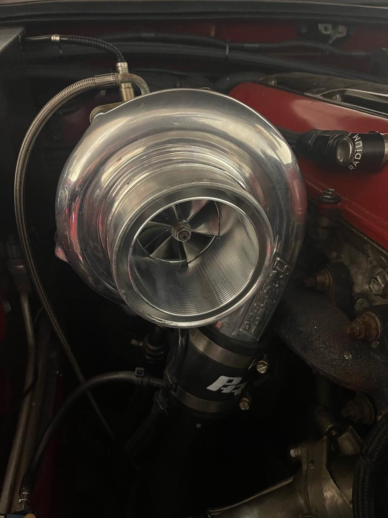

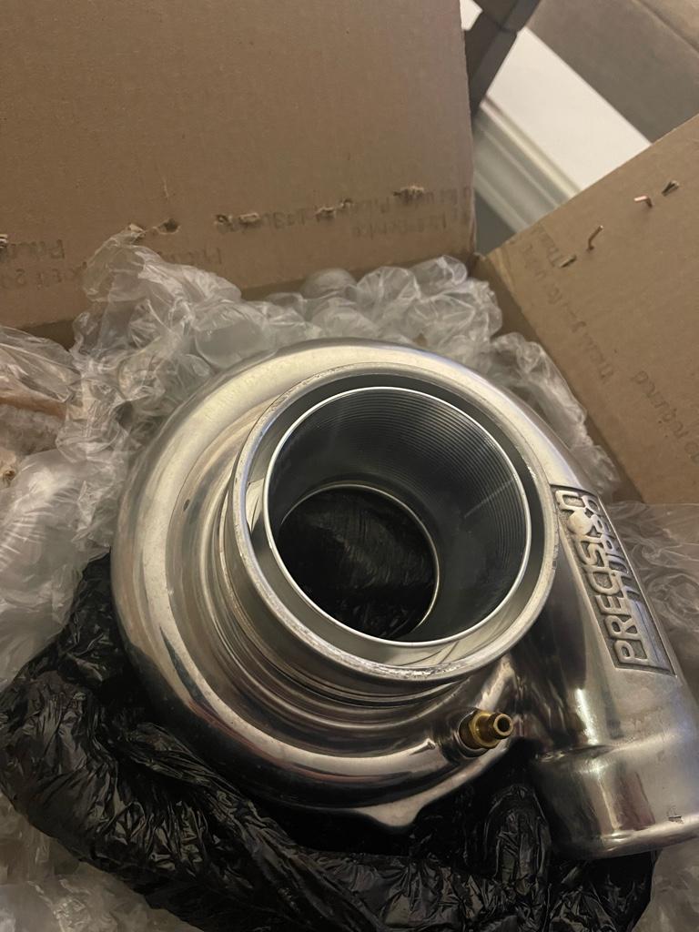

Just got my turbo housing machined by OCD works to resembles the old school HKS t51r KAI turbo spool sound and I’ll be lucky to get 5mpg now.. REALLY hard to stay out of boost.

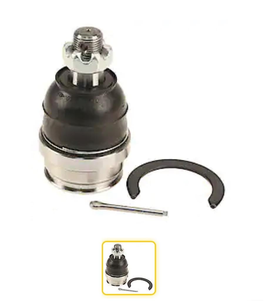

Much better brand than moog(been a hit or miss lately), I use 555 on my daily Prado 150 with no issues at all.
On the 4runner I use ACDelco 45D2426, bought a set on 2018 put some hard miles on them, ordered a new pair late 2022.
