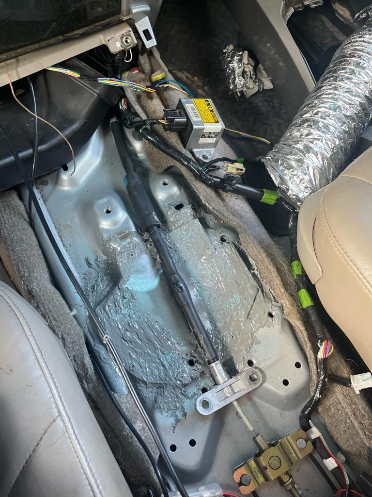

The last round included pulling apart the center console again to better seal up the the hole that remained of the FJ transfer case swap that is no longer in place. Took some thing gauge sheet metal from home depot and used rivets and a ton of seam sealer to close everything up. Still kicking myself for throwing out the ac duct tube that went under the ashtray to get air to the back seats, but made some flex duct stuff I had from my diesel heater that seems to work decently for the time being.

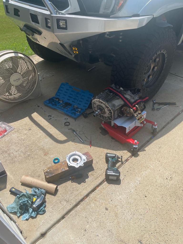

This weekends adventures include a 3 part ordeal I've been meaning to tackle.. I was having some transfer case fluid seeping out from what seemed to be the housing that mates to the transmission.. and is meant to stay dry. I ordered the t-case input shaft seal to have on hand, and sure as well, as soon as I separated the t-case from the transmission I had damn near a half a bottle of fluid come out. I probably should replace the transmission seal on the tail end as well.. but nobody seems to have it in stock and I don't feel like waiting, plus dropping the case on these things is literally a 30 minute ordeal so I'm not sweating having to do it again it comes to it. Waiting for the RTV to cure now so I can throw this thing in later this afternoon and fill it up for a drive tomorrow. Hopefully no more seeping.
While the driveshaft is off I also want to separate and clean off the current grease and use more appropriate stuff (since apparently I've been using the wrong grease) to see if I can keep it sliding more freely on compression without feeling the thud every time I go to accelerate.

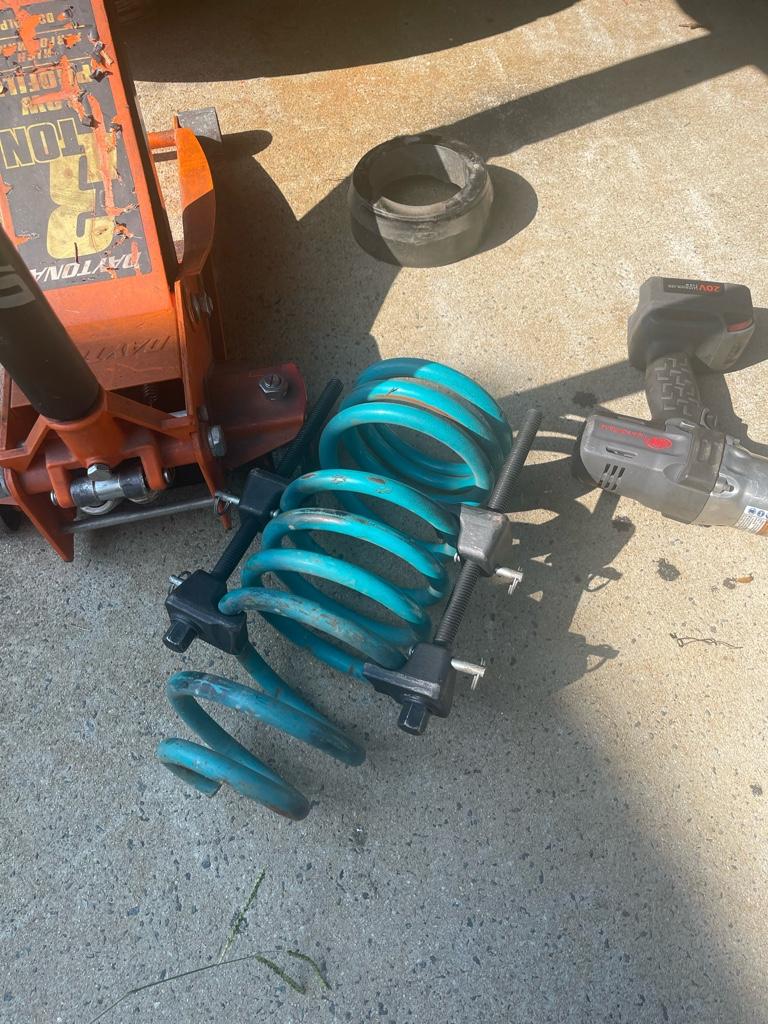

The other thing that I tackled was swapping out my rear Dobinsons springs for a lighter spring rate.. ever since I got rid of the RTT and big fridge the rear has been jacked up into the air with crazy rake, effectively getting rid of any caster I had. I wish an option was to lift the front to match, but with my recent goal of trying to make parts last a bit longer, the logical solution was to drop the rear. Went through 2 batteries on a 700ft-lb impact driver compressing the springs in and out, I had doing these big spring lol, but they are in and ride pretty damn good and sits a lot more level like I wanted.
While the springs were out I was able to fully compress the rear axle to check for clearance everywhere since occasionally on back-to-back hills I would hear something impacting, and I believe it was the corner of the passenger side upper link mount against the cross member above it. Shaved off the corner a bit to give it more clearance and will need to do some testing once it's road worthy again.

Ran out and threw the transfer case back into the rig during lunch before the afternoon storms come through. I'll have to wait to fill it up since I didn't get to the RTV until around 9 p.m. last night and it calls for 24 hours.. doubt i'll have the patience to go all the way to 9 but I figured it's a bit soon now to test drive, definitely don't want any RTV-related leaks to deal with later, though I'll likely have to drop it again at some point and replace the transmission output shaft/extension housing shaft seal since nobody had it locally and I didn't want to drive the supra to work in the rain tomorrow.. I don't think it's bad, or at least it wasn't fully bad until I put the case it. I may have nicked it a bit going back in since I had a bit of transmission fluid in the housing before tightening everything up, or maybe I'm lucky and it was just a bit that spilled while the seal compressed :wacko: :loco: Oh and by the way, don't be like me.... don't run 85w-140 in the transfer because you misunderstood what ECGS said about running it in all their applications... it only applies to the front and rear diffs :) I've been running the same damn fluid in all 3 on my FJ t case.. luckily I've only done maybe 250miles on this fluid since going back to factory... on the bright side, it probably probably was too thick to really leak out of the seal :shrug: Just got some 75w-90 synthetic valvoline flex fill in a pouch to try out on this go around.
I'm also hoping I got my driveshaft together in the proper orientation since I took it apart and pumped all the old grease out and filled with the proper stuff.. my marks didn't stay as visible as I had hoped.. so any new vibration will surely be the result of that lol. Time will tell.
I also kept finding conflicting information on the amount of grease, hydro-locking the shaft with too much, etc... since I took everything bit of grease out of my shaft I doubt the typical 3-6 pumps is enough.. i've read about guys pumping 30-50 into theirs (way too much if you ask me lol) with no issues, while others being petrified about hydro-locking the during a compression and cracking the transfer case (also seems to be a bit excessive lol) so I went with maybe 10 pumps, squeezed a bit out through the zerk fitting hole, and extended it to the case and mounted it up. I guess i'll see if the stop/start thud is there and pump in a bit more grease as needed. My axle is pretty far back compared to stock so I feel pretty confident that an extra 3-6 pumps won't do any damage, and may actually be required. :hippie:

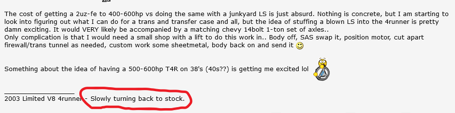

Then it hit me... for the price I would pay to do anything toyota boost/rebuild related would be pretty steep.. now I know the thought of throwing an LS in place of a tried and true 2UZ-FE platform is bound to ruffle some feathers, but hey, I still get flak for having a Tacoma front end from some :reddance:
The cost of getting a 2uz-fe to 400-600hp vs doing the same with a junkyard LS is just absurd. Nothing is concrete, but I am starting to look into figuring out what I can do for a trans and transfer case and all, but the idea of stuffing a blown LS into the 4runner is pretty damn exciting. It would VERY likely be accompanied by a matching chevy 14bolt 1-ton set of axles..
Only complication is that I would need a small shop with a lift to do this work in.. Body off, SAS swap it, position motor, cut apart firewall/trans tunnel as needed, custom work some sheetmetal, body back on and send it :)
Something about the idea of having a 500-600hp T4R on 38's (40s??) is getting me excited lol :lookout:

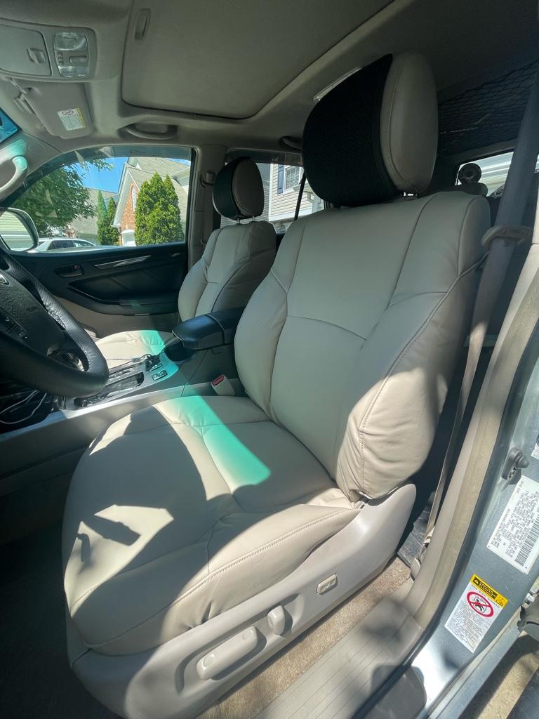

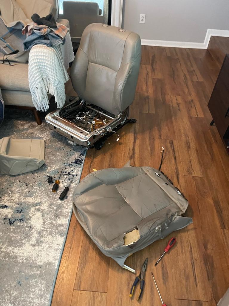

Should have just custom fitted some Lexus IS seats instead … last time I’m tackling an upholstery project …
I don’t have an exact before to compare to, but I guess all in all it didn’t come out too terrible for $140 and 5 hours of work .. this will carry me over until I’m ready to do an all black interior conversion and throw in some gen3 is300 black leather seats and redo the rear seat leather. At least those don’t have any seat heaters to mess with lol.
It’s not as tight as I wish I could have gotten it in spots but with the sun beaming down it’s helping iron out the wrinkles and looks much better today than it did yesterday evening.
edit* I should mention, these cheap covers were from ebay, the quality is decent but certainly not OEM. One area of concern is the side airbag in the seat... the factory covers have a solid tether that attached via metal plate to the back of the seat to allow the cover to stay put as the air bag blows through the stitching. No such provision with these.. so who knows what'll happen if, god forbid, I'm ever in a serious enough of a wreck that would trigger those.. lol.
