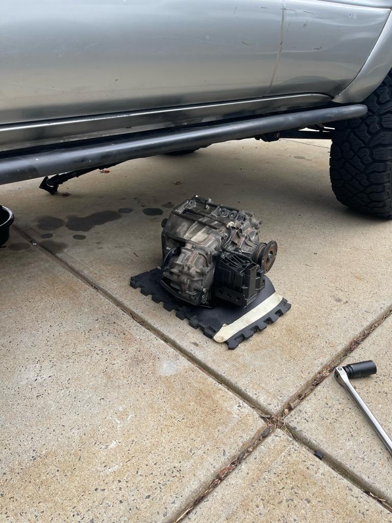

I've heard and read of various (incorrect) methods of trying to get these things apart to replace the seal, but obviously the only correct way is to drop the case, split it, remove the clips and pull the actuator off. The information that I thought was going to be hard to find was the seal part number since toyota doesn't actually sell these separately. Well.. looks like it's been a pain point long enough to have people actually throwing small seal kits together for these things, and it's actually local to me even though it's sold on Ebay.

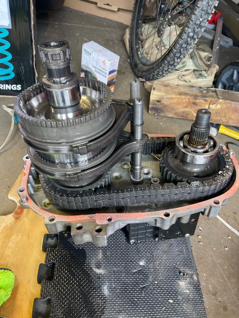

Getting freakishly good and quick at pulling the case. This time was probably somewhere in the 40 min range lol. Already cracked open and ready to pull the actuator before the seals arrive tomorrow.

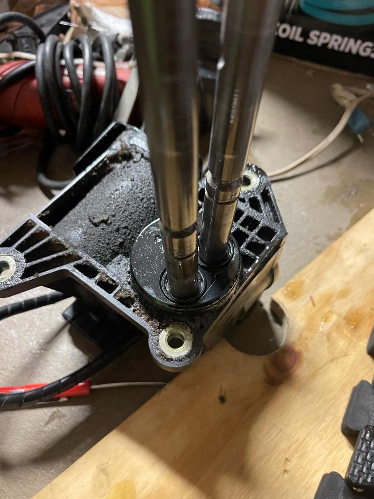

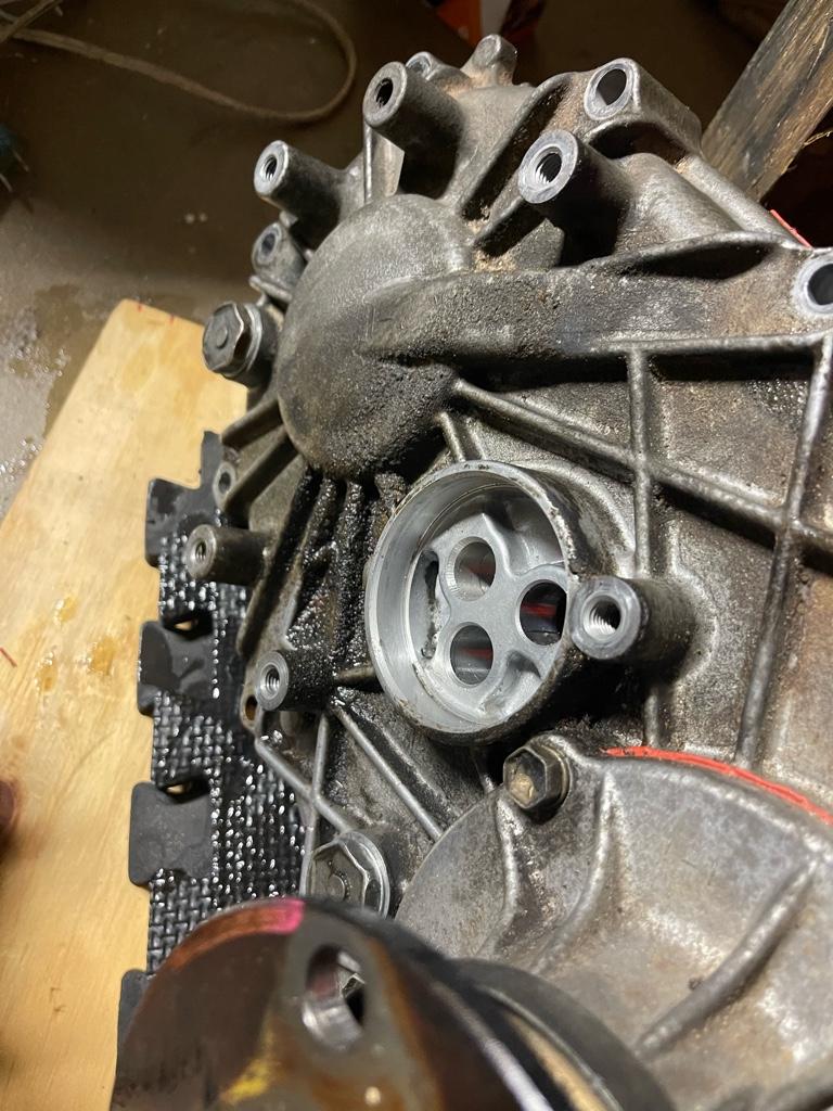

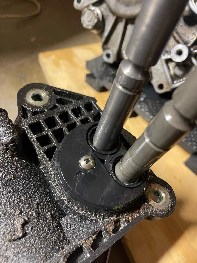

I will say, the snap rings holding the shift rods in were an absolute *****. But everything is apart and ready to be cleaned up ahead of the seals arriving. Now I just need to figure out where the seal ends and the housing starts so I don’t break anything .. also, judging by the build up of gunk .. I’d say it’s been seeping a while ..
But also after taking a look .. I think the outer leak comes from the larger o ring that around that housing , the smaller ring failures cause oil to get into the housing itself and kill the actuator .. I think ..

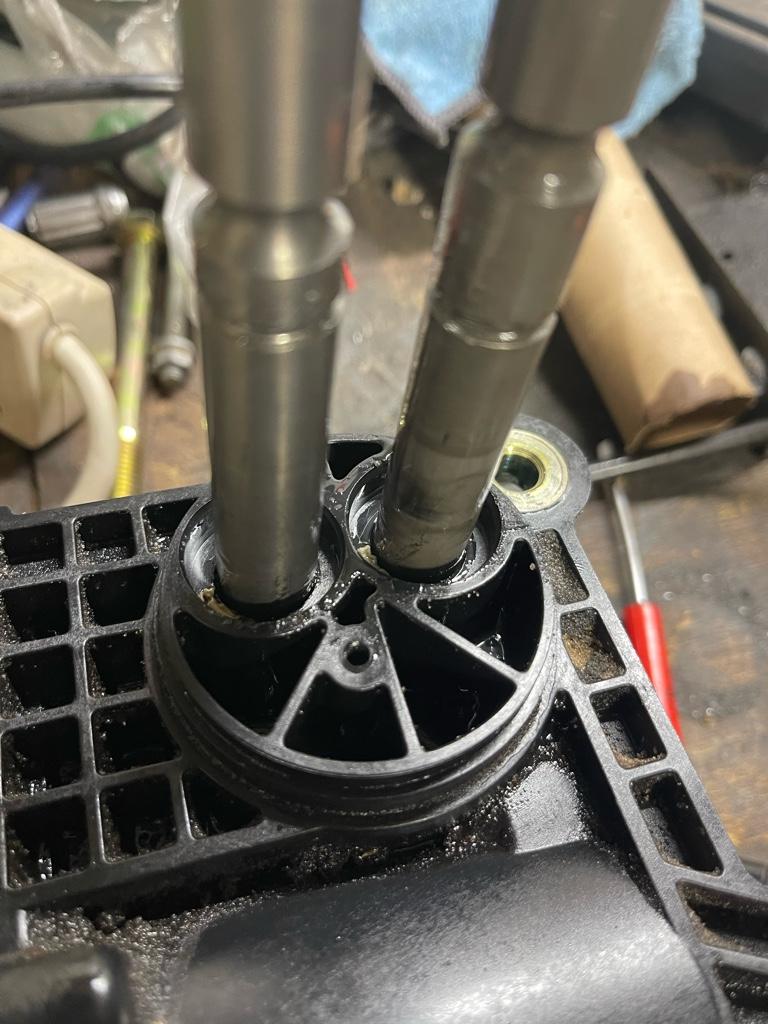

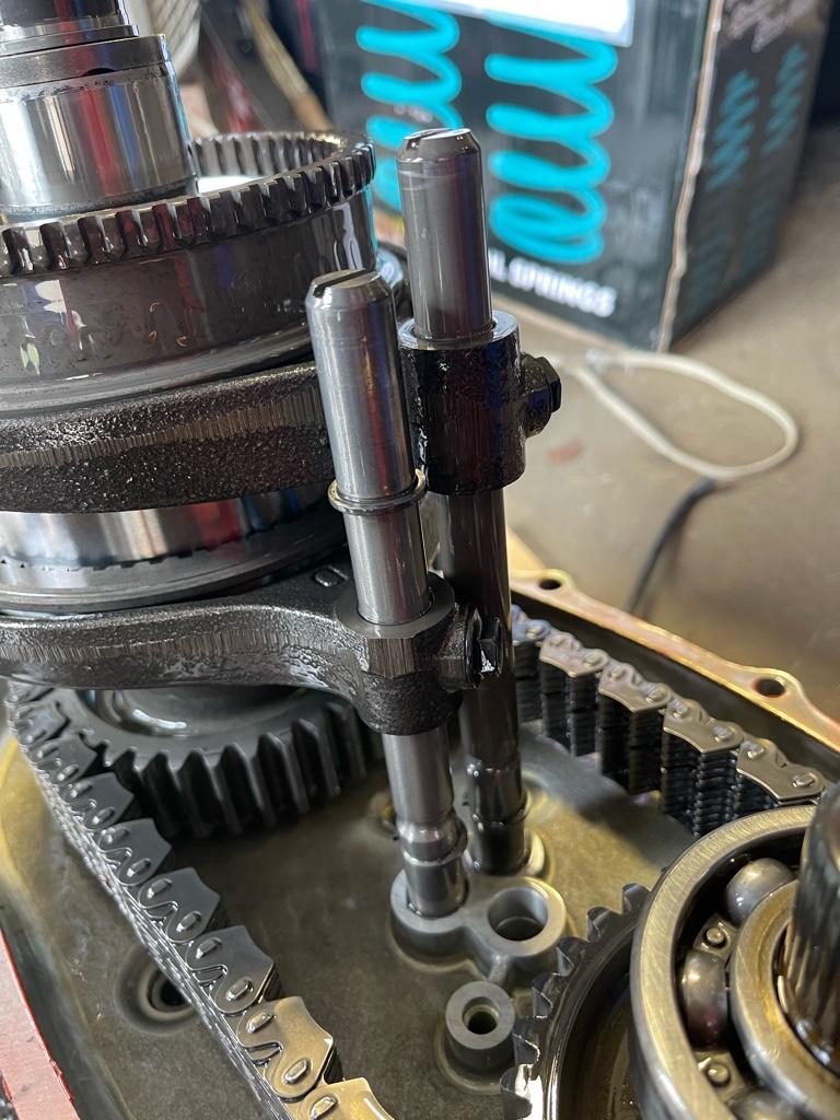

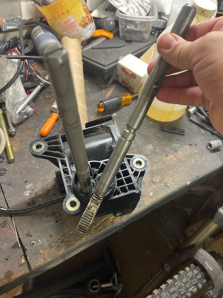

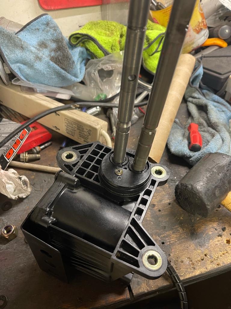

Well then … this isn’t supposed to..uh .. come out …

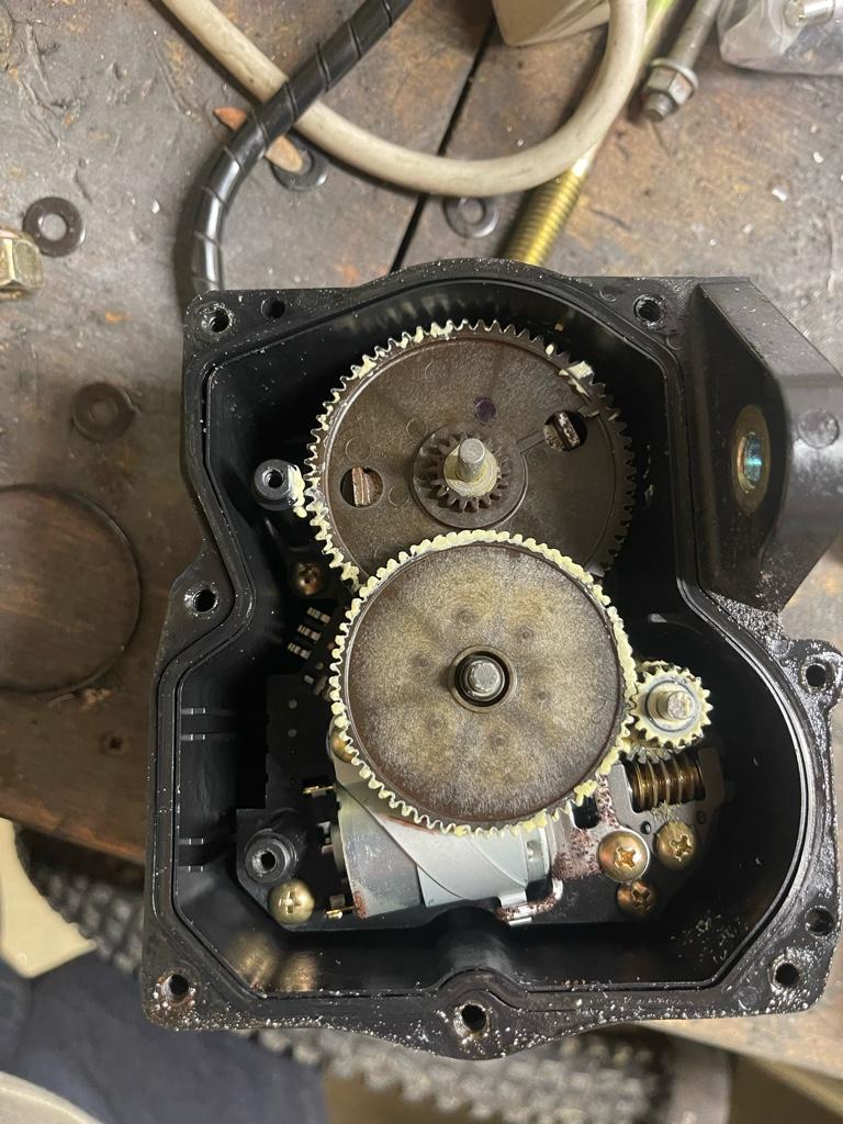

Went to flip over the housing and one of the fork shafts plopped right out. Don’t know why or how .. so part comes the housing .. good news is the inside is completely dry .. not a drop of oil. So the 2 small seals haven’t failed yet .. so my suspicion that it’s the larger o ring that causes the outer leak around the actuator.

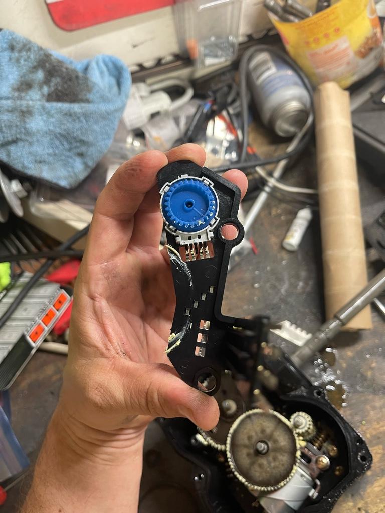

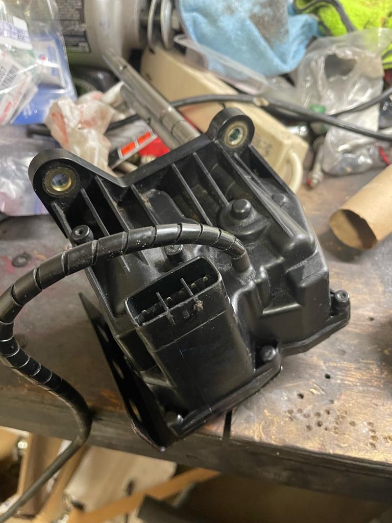

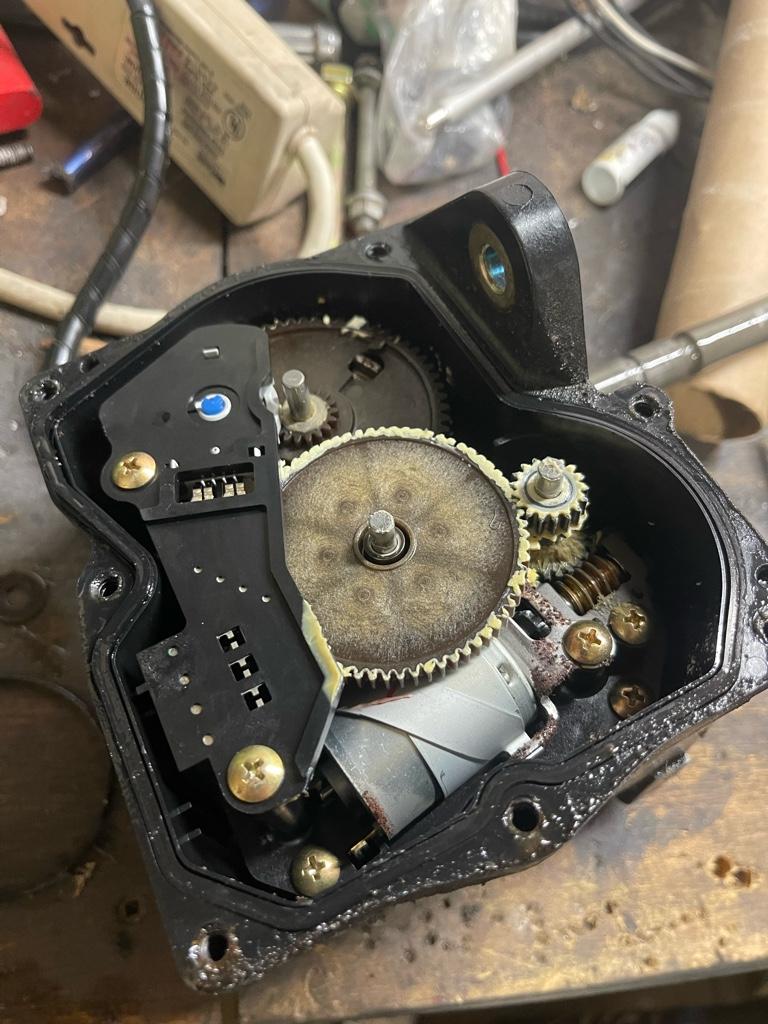

Took apart the housing and did my best to guess as to how it goes together … a quick test plugging into the car and hitting both 4lo and center diff lock actuated both forks and both lights came on as needed .. time will tell if they’ll actually move as needed connected to the forks but time will tell. I’ll do a dry run when I get the actuator back on before I close up the case.

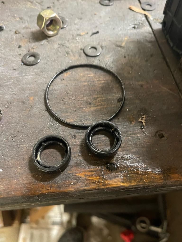

The small seals are off and ready for the shipment to arrive.

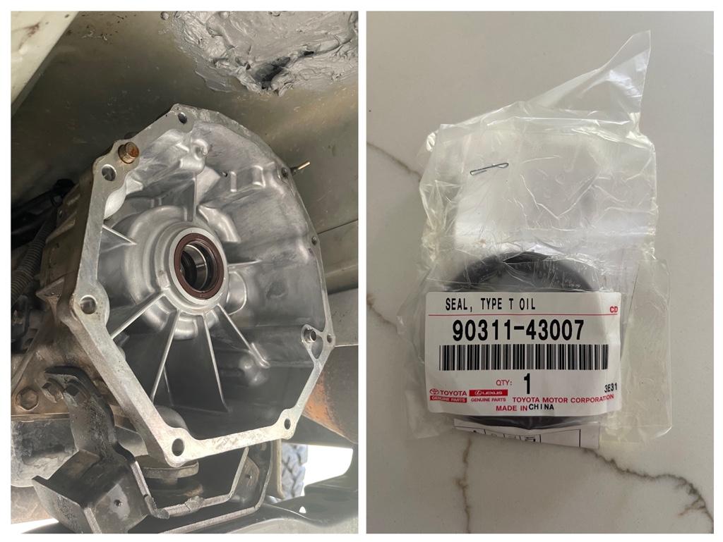

Dropping here for future reference. This confirmed to be the transmission outpushaft seal part number I have on hand.
We’ll.. got the deals on everything cleaned up . Actuator looks almost new again. Again, bc it was bone dry inside I would wager just about anyone that has an external leak has a failed o ring that’s the larger of the 2 and actually IS available from Toyota. It’s the 2 small ones a part of the housing that are not. You could easily crack open the outer cover to the actuator on the rig and see if you have oil or moisture. Either way, it’s gonna come off to replace .. but yea .. I think the failure mode is the o ring that leaks outside and possibly let’s moisture inside eventually killing the electronics (and I would be it’s the encoder or limit switch , not the actuating motors ).

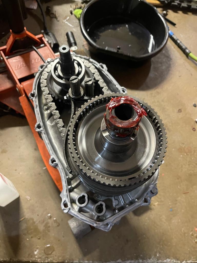

Waiting for all residual oil to leak out of the front half of the case so it doesn’t get on the fipg when I go to seal it. Also need to plug this in as it sits and see if it still actuated since my rod came out .. seems exactly as it was but time will tell ..
Well.. may have dodge a bullet. Plugged it in half taken apart and both forks actuate as needed and don’t fault out. Time to clean everything up and get ready to seal things up.

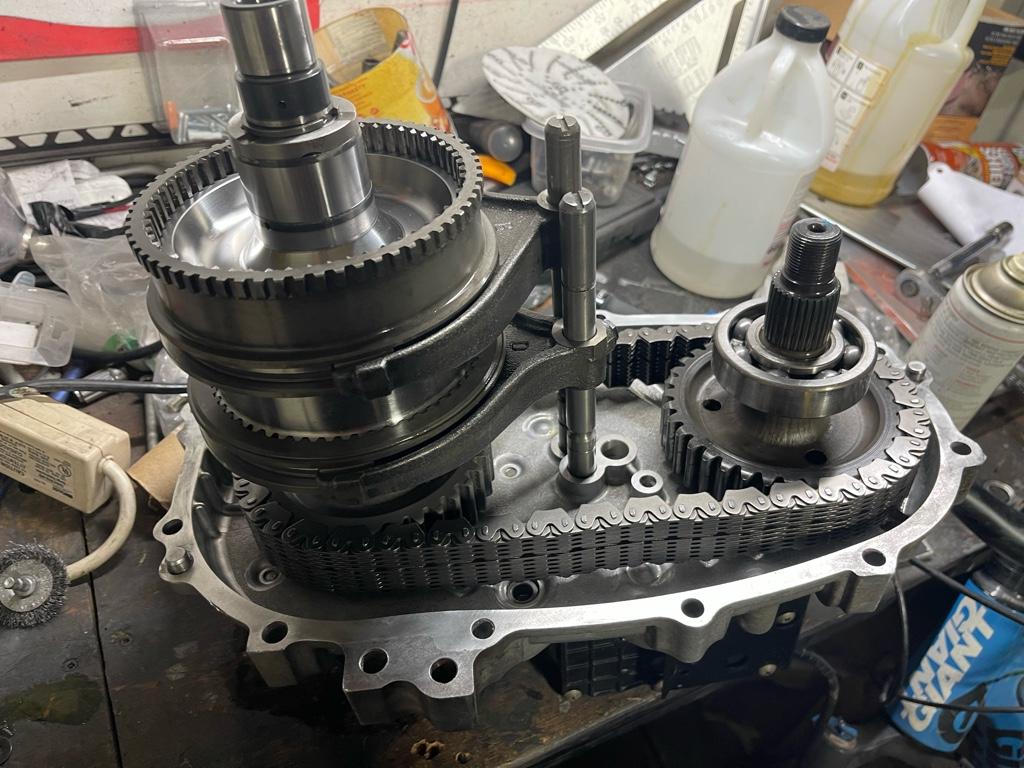

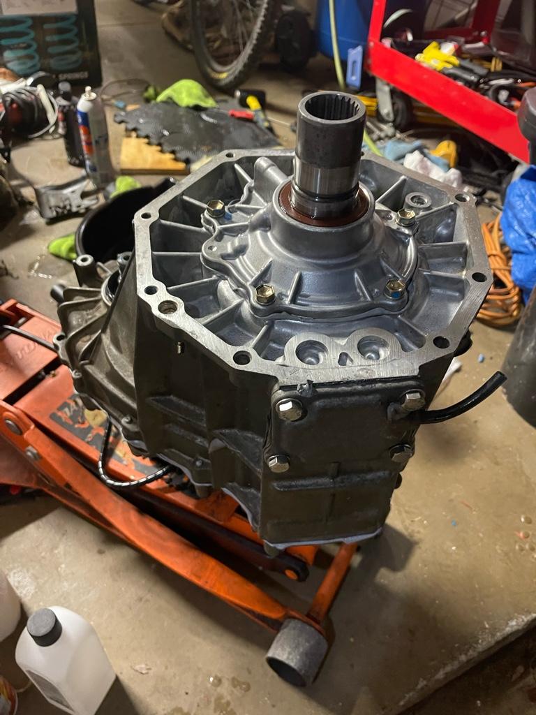

This next part went together way quicker than anticipated. The input shaft has a split bearing that I for sure thought would fall off two or three times .. a little assembly grease kept it together and I got the case on in one shot.
Now fingers crossed it still actuates once it cures and is back in the car [emoji1787]

The case wasn’t as terrible as it looked.. still need to throw it in today but if nothing leaks and still actuates it’s really just a weekend job.

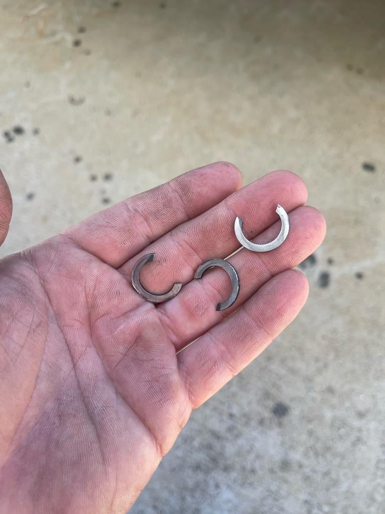

These are the c clips to prevent the shift rods from coming out of the case. I’m sending it without them. They literally cannot go anywhere since on end is pinned with the shift fork and the other in the actuator. Might revisit this wise decision down the road but I really don’t feel like cracking the case open again and putting off a running car another 2 days. Maybe I’m wrong , but I can’t imagine these going anywhere without the clips.
Be sure and put them in a little plastic bag and hang on your workshop peg board for future retrieval, just in case!
yup.. that's a great idea. Considering the fact I forgot them 2 days into the build, no telling what will happen to them in the next few months/years lol.
