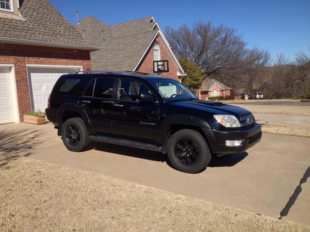

Stock sport wheels powder coated matte black $35 each.

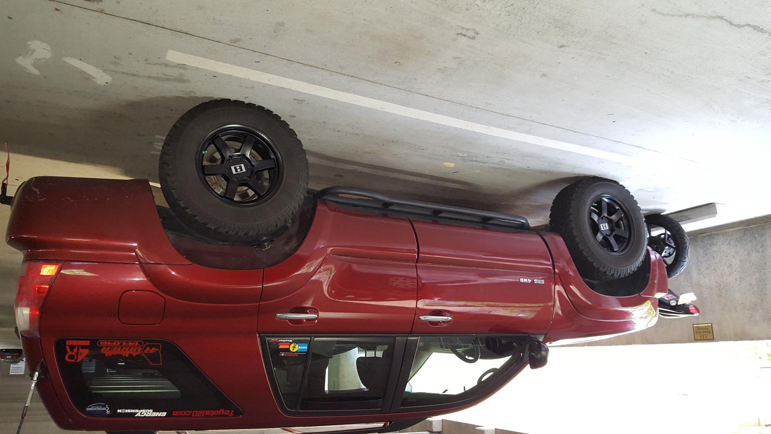

Looking at the MK6.
I just got the Level 8 MK6, and am diggin the look.
Nirv_IEajsc9JGstLQ7V2P1KWpGWiVnSvciAIj7Raq2ZAA-ykkr4nNfZfG86UwoL4V-pHZmJW2dYAa5Erxk7nw0cYHHq6Tz-3y_ONZJFCDR0lFDuaE-Cb7JsDFaWQ3t4Tv63y2ik0l-eYyzPdee07yjHX8ExkkMLyQ6kl_IxUymPaJF7xeKQC574R_pFS9_b2NpMAGX79p4E-8GcxFHEwubcgahcqw9_GRgv7GooN6TDDo3bgQ0ifDiNq2iClVEB4iv54xBuqzCYnr2VFtQSv7VKk9ePwVIJmeyZRmZN6C-tvvkwwyNhHlp9Oo-m0c5p3qWBnMiAUZ5LuKOwu0-HZQoISU1UX29nWnkoKOHCNdtAZY3GVwwhzYgYVyyEuwwfDw8ethsghepGGpRpagfjWL7xdkyiVlXqGSb60tUERhODWt2R8o3FCWmIubscnnZGoub_bfWD4Sh49tBAFQQ-kO16OA4kvTL1cUfX-ctjtvk0cxp-atqfjpIamCHifyLLoDKIm5DrKa1L1ogNsw3MZoVzuSnxVAq5WZz_qQZY9X3o=w1065-h599-no
