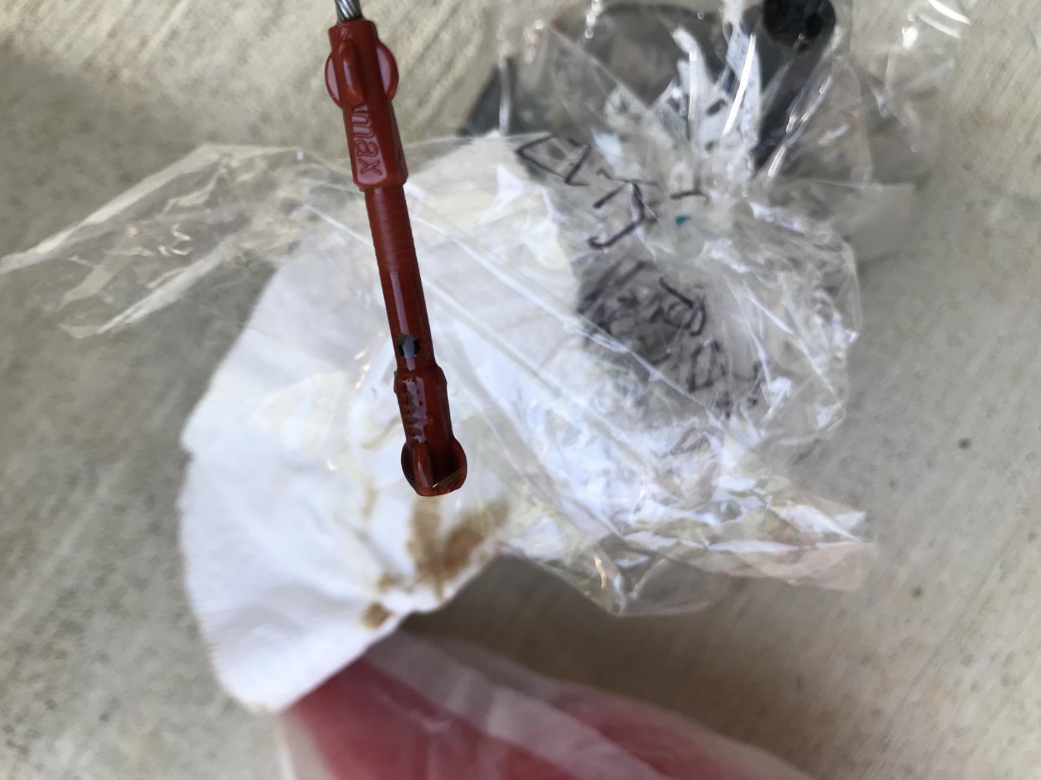

Are there any aftermarket dipsticks available? 4Runner’s dipstick is so poor designed that every time I check the oil level, I have to pull it out and wait for at least 10 minutes then insert it into the tube to get the correct level. Really annoying. My MB ‘s dipstick is so much better even with synthetic oil.

Yes, I know how to check the oil level with a dipstick. It’s just the design that makes it very difficult to check. You have to pull it out and let it sit for at least 10min so the oil in the tube clears. Otherwise it’s everywhere on the wall and you can’t tell where is the line. The picture I posted is a MB dipstick that has a thick and brown plastic tip that prevents it from rubbering the wall. It works much better than Toyota’s.
