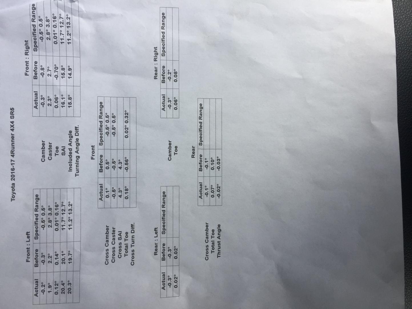

Here the alignment details below. If anyone can make sense of this let me know thank you.
Can anyone make sense of this? I have no idea what the numbers mean and I don't want my truck to break or anything lol. Just want an explaintion of what could be causing this?

Like I said, the tech seems to barely comprehend what they are doing, which would make me very nervous. I'd highly suggest taking it into an independent specialist for a second opinion if you're really concerned.
The one thing they did get right is that it shouldn't shred your tires, but out of spec caster can impact your steering negatively.
