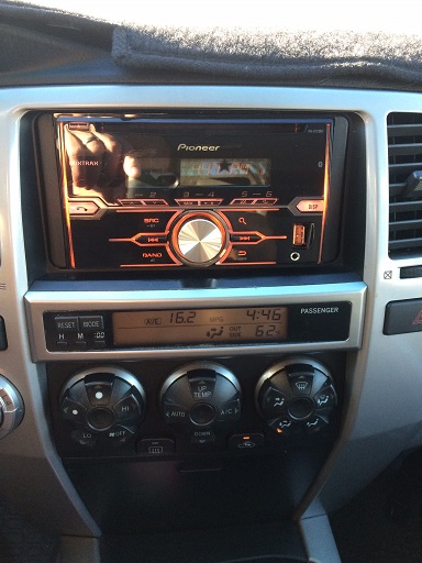

I have a 2003, and installed this radio a few weeks ago.
Pioneer FH-X720BT - Custom Sounds
Bluetooth, USB, and Aux. It is a Double-Din, so it fills in the dash nicely. The wiring harness and mounting kit was about $30 total for both. The radio is about $150. I originally got this one because I could change the lighting color to match my gauges. I am pretty happy with it. I have since added an amp and a 10" sub.

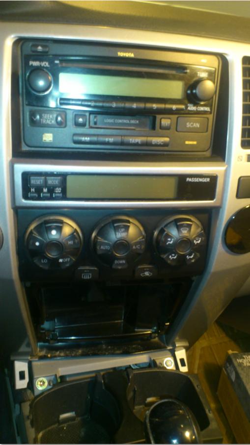

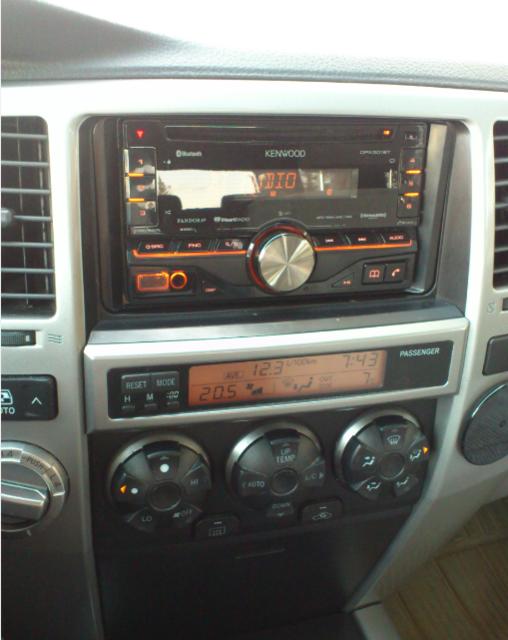

Well I finally installed my Kenwood DPX501BT. Overall a solid deck that's very easy to use and looks very flashy. The best part is the colors are totally customizable to match the interior which I didn't think would be a big deal but once you have it you appreciate it.
Overall the install was pretty straight forward. The hardest part was sawing off the unnecessary parts from the mounting kit (Metra 99-8300). One issue I found was that the car itself has 2 antennas; AM and FM. The new head unit only has 1 input so I ended up plugging in the FM port so I don't have any AM radio right now. Going to look for an adapter.
