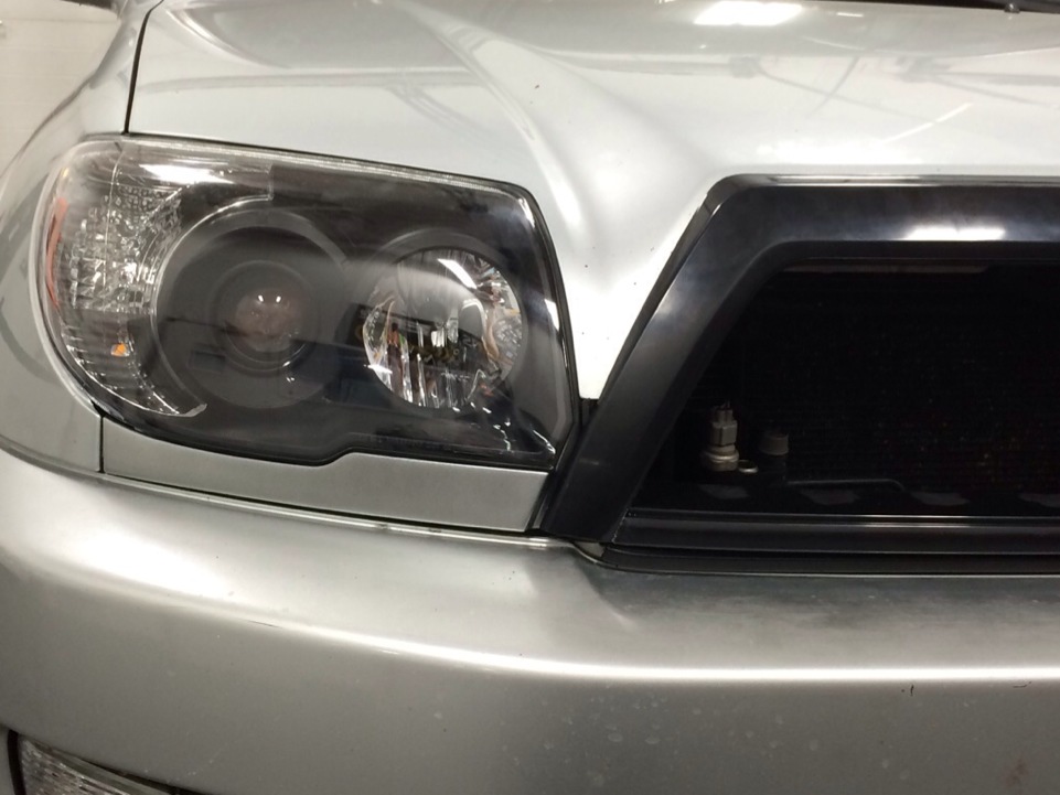

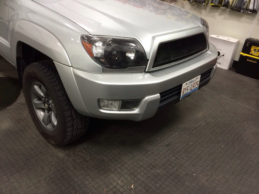

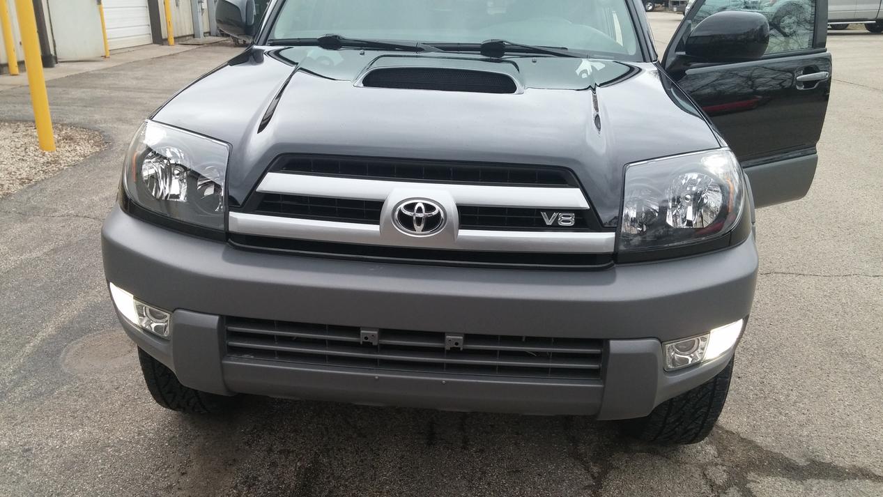

Two pics of my new lights.

Still digging mine. I even took a hard rock strike from a cement truck on the highway, and the lens didn't even scratch. Lots of rain with no moisture in the lenses. Very happy so far.

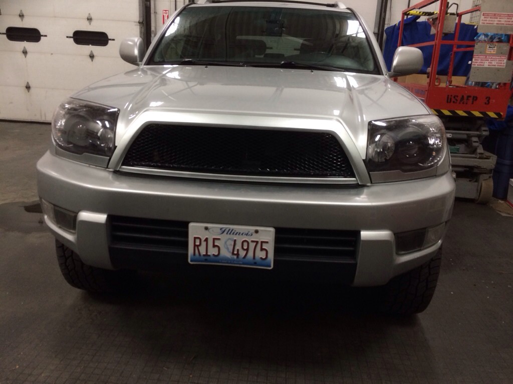

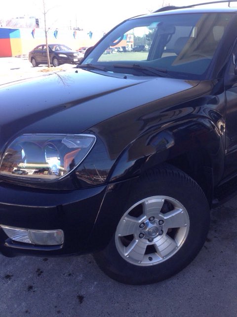

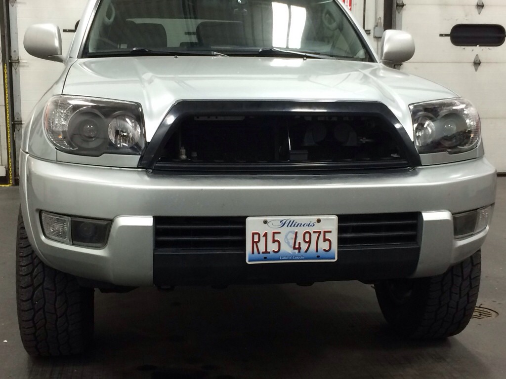

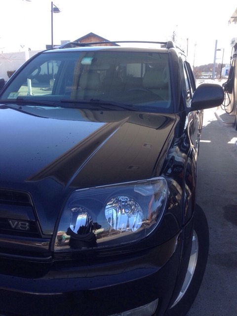

I have these headlights also.

Those are all the pics I have of the grill project. Thanks for the kind words. Wasn't too bad at all. I started with a eBay special. Cut everything out with a body saw. Glassed the sides and body filler to smooth everything out. I wanted to keep the trim on the bumper for a cleaner look. Trimmed the grill down to fit height wise, then did the same to the metal bracket. Glassed everything together. Had to fab a rod for the secondary release. Used a rod from a dei door lock actuator. Customcargrilles for the mesh xl diamond mesh I painted satin black w/ etching primer. I can snap some more pics if you need. Shoot me a pm with any ?'s
