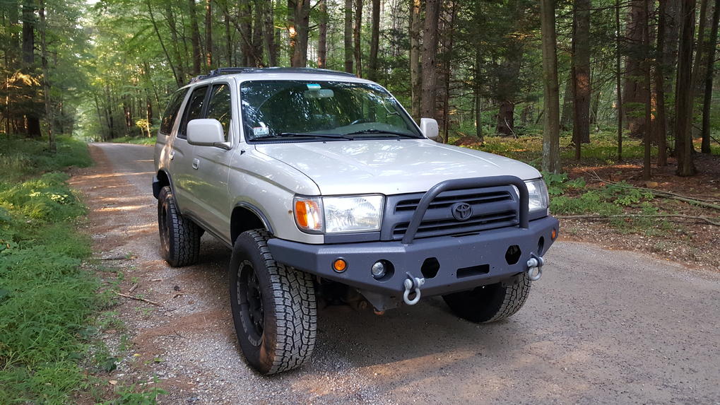

I have that bumper, and it didn't take any modifications to mount it. However, it bolts directly to the end of the frame so now it will transfer any impact into the frame. ARB is the only one who includes some kind of crumple protection, but I believe it also involves chopping off the end of the frame rails to fit those parts.
I do have a 1" body lift, so that gap isn't normally there. I also need to touch up the paint on it a bit.
I have that one also. Here's a pic of mine before body lift. 4x4Innovations fit was perfect. Real easy to install. I coated mine with Monstaliner.

Stock has a little give to it with the brackets and all that. I do run it with a grill, I was just adjusting the headlights or repositioning the tranny cooler or something, I don't recall.

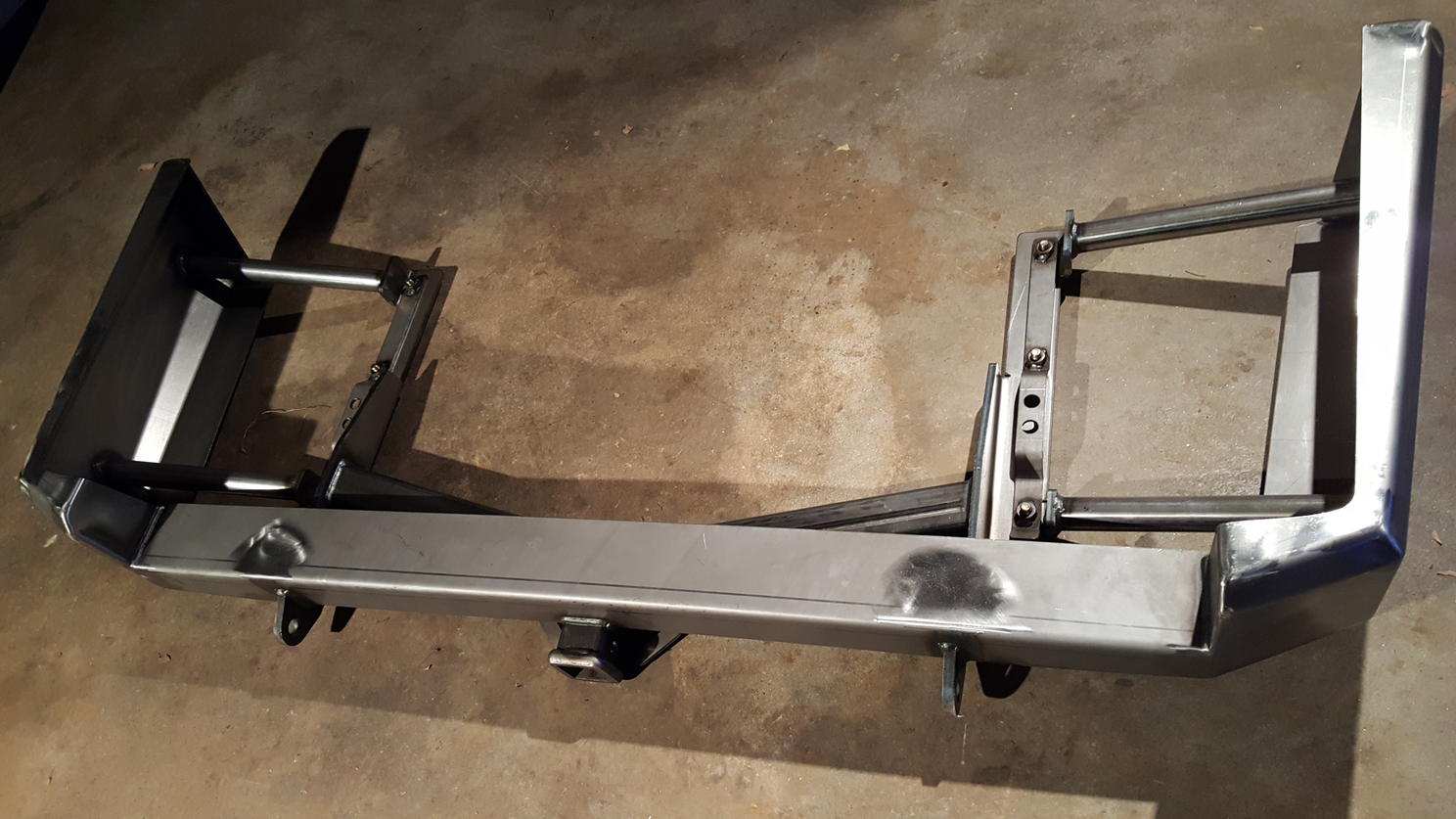

I just wanted the one hoop, no reason really. You can go none, one or 3 on that one. I have the rear 4x4Innovations also, I like it. Here is is on my garage floor before painting. Solid heavy duty, well constructed.
