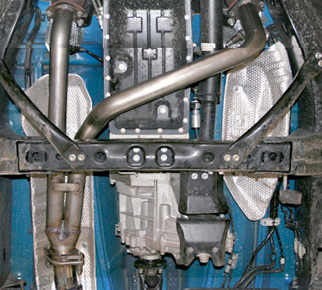

I have the URD Off Road Y-Pipe on my 17' TRD Pro. It removes the rear catalytic converters and eliminates the dreaded "crimp" on the stock Y-Pipe. I also have a TRD Intake.
With 10,000 miles on the motor with full steel RCI skids plus the gas tank skid, Gobi Stealth Rack and Shrockworks sliders, I'm averaging 16.5 mpg with 50% city and 50% highway driving on pavement only.
