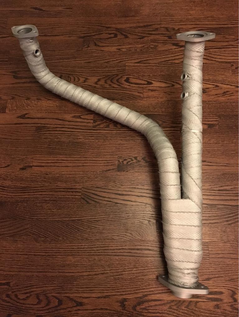

I had my Y-Pipe wrapped and spray coated with DEI after your experiences with the additional heat.

For the heat I would fab simple heat reflector plates like the ones above the OEM back cats. SS thin gauge metal would work and be easy to fab. The plates get hot but dissipate the heat faster in the rushing air, a bit like a radiator fin.

This is better than nothing brudda...
down side to wrapping is moisture ( especially when you do water crossing or drive in the snow) ... DEI is really just a coating...
I did the research and inconel shielding was the best way for me to go ... I have experience with what inconel shield did for my old turbo cars. And it lowered engine bay temps greatly without attracting moisture to rust my pipes out. Plus Ive been known to submarine my 4runner or go to the snow alot. So inconel heat shielding was worth every penny
