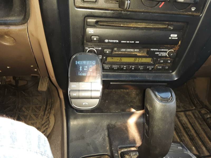

I no longer pull the OEM out as they have a good am/FM cassette and CD player. A just use a less then $20 bluetooth adapter which can be bought at walmart or Amazon and get bluetooth. Then my phone just plays my tunes and can answers calls. :) img.jpg
Sent from my SM-J337V using Tapatalk
