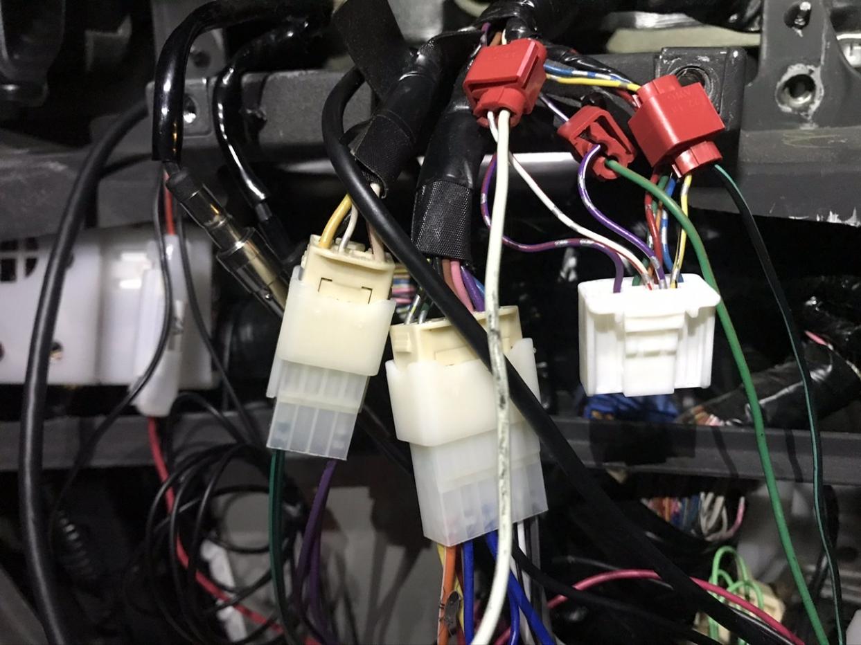

Guess it depends how it was wired in. Mine for instance has the patch cable I got from Crutchfield which I wired the radio to. Then that plugs into the factory harness. If that’s the case, unplug the harness and use your multimeter to check for power. If you have power there then you know it’s the connections. If no power then you have issues before it.

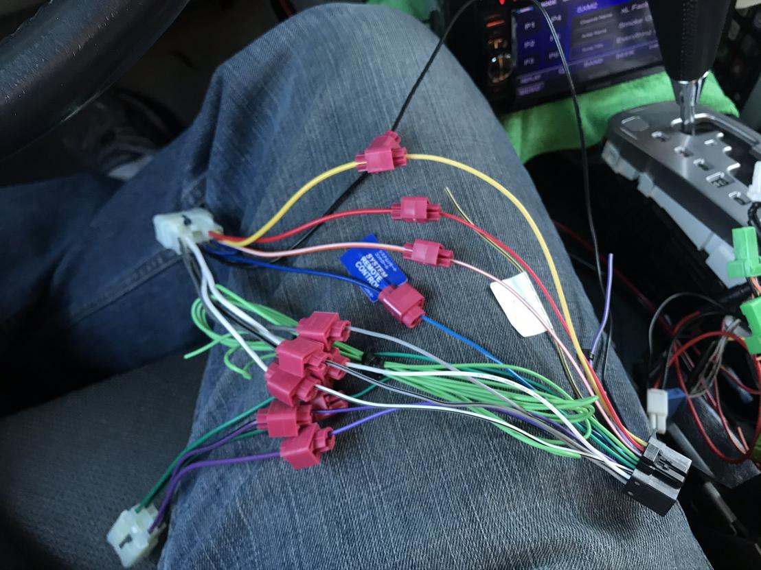

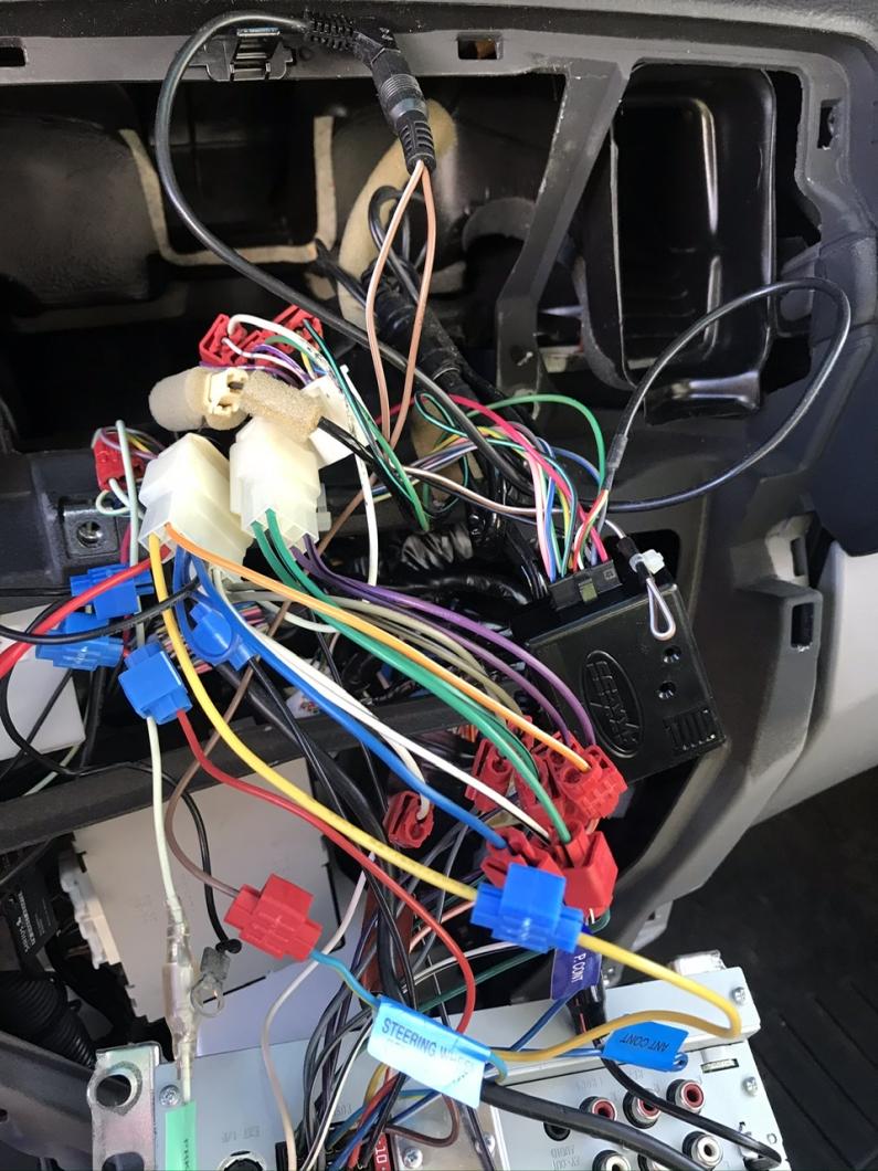

whatever you do, don't use those connectors like in the post above. Solder the wires together. If you don't know how to solder, please learn and practice. You will save yourself so much headache not dealing with t taps or butt connectors.

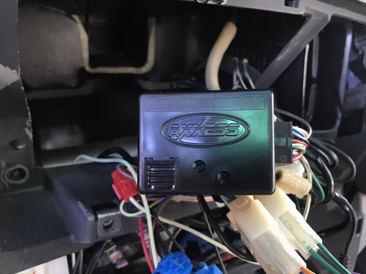

Can you send the link to the harness that you bought? Looks like you only utilized 2 pigtails to splice into directly for the radio harness, where does the 3rd pigtail splice to with the green, black, and white wires on the right of the last picture?
Here you go Metra 70-1761 Receiver Wiring Harness Connect a new car stereo to the factory wiring in select 1987-up Toyota, Lexus, Scion, Subaru, and Geo vehicles at Crutchfield
The harness on the right that I tapped into is for my Axxess steering wheel controls.
