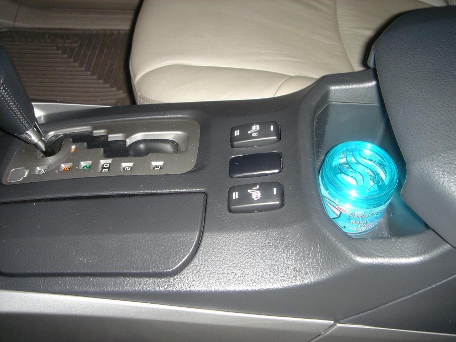

Hey everyone thought I'd share my newest install since I haven't seen anyone with the aftermarket seat heaters... Basically I installed them myself in about 2 hours taking my time and the install was a breeze... I re-used the hog rings instead of buying new ones since there were a whole 6 rings to re-attach.
My first impressions are they are pretty good. The kit itself was 219 + shipping. One of the seat switches was stuck when i first opened the package but the company I bought it from quickly sent out another switch and had me mail back the bad one (free of charge). Oh yeah, they also have a 3yr warranty which is great. Now I'm ready for Tahoe... that was my excuse for getting them and living in cali :p .
Here's the link to them... http://www.mnrelectronics.com/20to4rfasehe.html

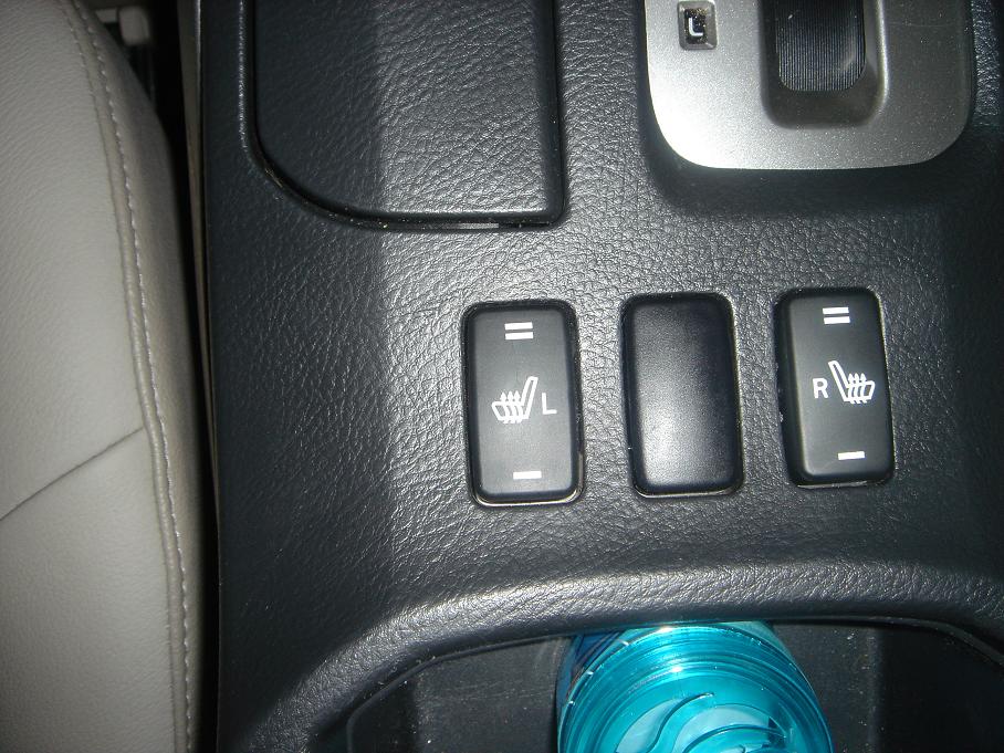

another pic....
Oh yeah, the swithces DO NOT light up.... I asked if they will ever come out with them and they said they didn't plan on it... However, they also said if they do ever come out with them all I have to do is pull mine out and they'll send me the new ones...
two settings... the default one is the click it up and that turns on the back warmer.. click it down and it turns on the butt & back warmers.
2nd setting (and the one I picked) is click it up and it is on HI (both pads) and click it down its set on LO. The two temp setting are I believe 135 for low and 145 for HI. There was a small box I installed under the each seat and then I ran the other wire to the power source in the left kick panel (t-taps) and the two switches up to where you see em'.
