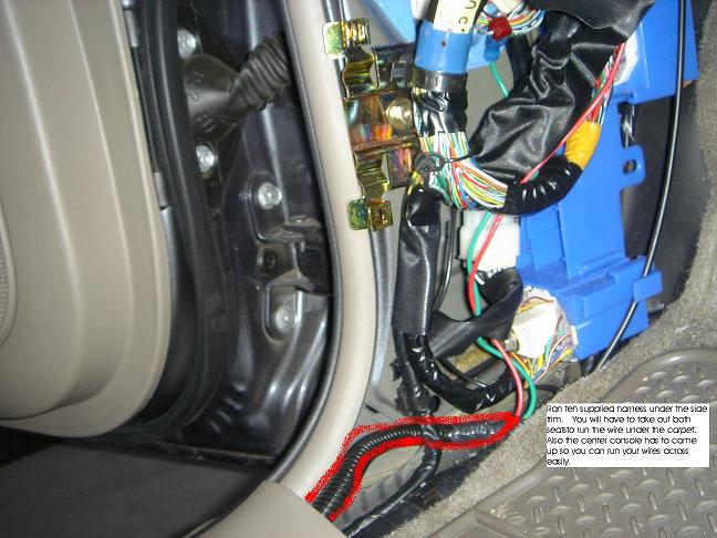

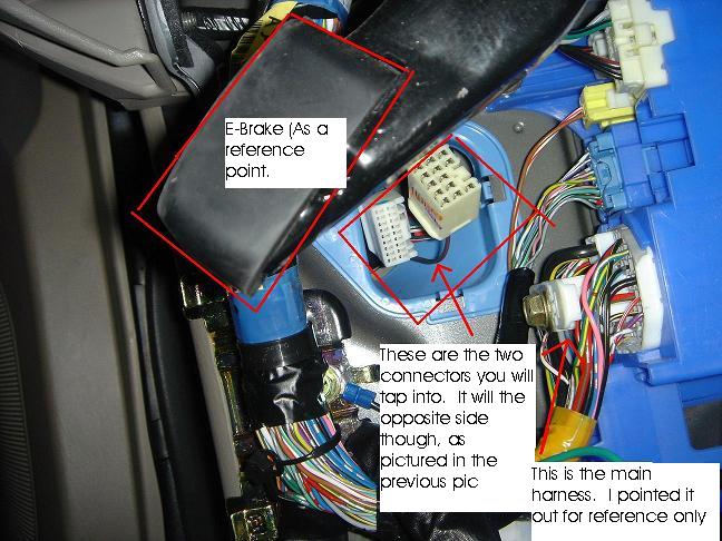

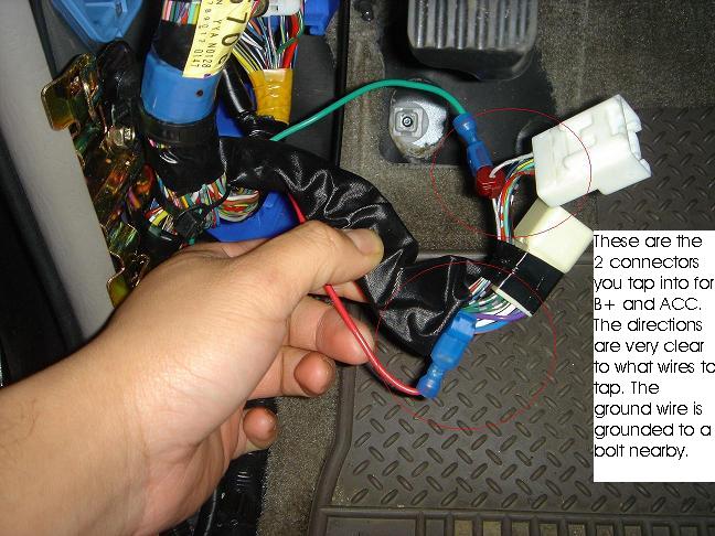

Here are some pics... I assume this is what most you guys are requesting. The rest of the install is pretty self explanatory as you have to pull the seats, run your wires... pop out the blanks and pop in the controls.. the heater unit controllers themselves I placed under each seat and secured them with zip ties.
