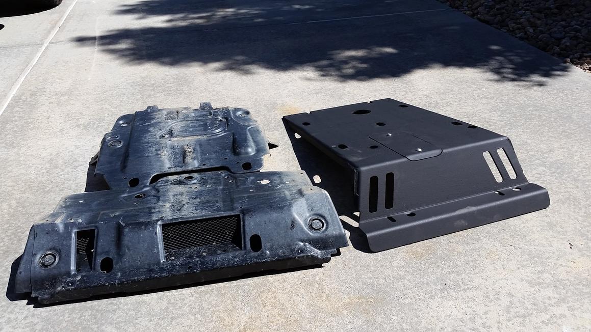

In mounting this new skid plate, I was expecting to use the factory mounting holes. The new plate just came with four long bolts and oversized washers. There weren't any instructions, but wasn't expecting any as this should be simple.
In performing the test fit, it looks like I can only use two of the factory front mount holes, then I have to remove two existing bolts from brackets that had nothing to do with the factory plates for the middle, and then the rears don't line up with anything other than two large holes as the rear mount holes are too far away.

On the front end, there are 4 holes, only 2 of them would align with anything. On the rear, it looks like it would bolt in to existing bolt holes.

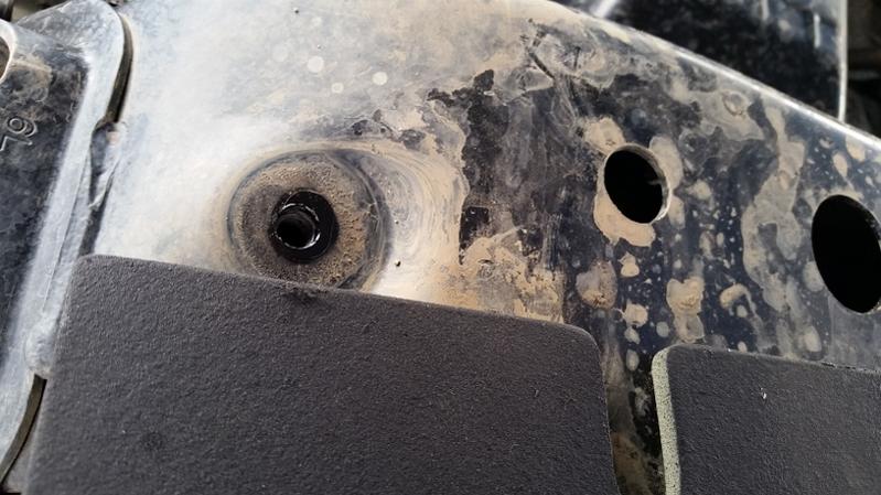

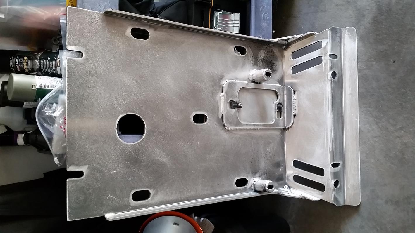

I thought it would bolt right in as well...expected to use factory mounts. Does include 4 new bolts/washers that are much longer than originals....they seem too long for the fronts/middle.
Up front, it seems fine and could use the factory holes.
In the middle, there are two longer standoffs. They are slotted which indicates they should be used, instead of just enlarged for the existing bracket bolts to just fit inside.

At the back, you can see where the factory holes don't line up with the slotted opening on the skid. It looks like I need to use long bolt with nut to insert into the existing hole....that does make it a two handed job to insert/tighten which would be a pain when you are under the vehicle trying to hold it up.

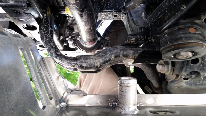

Please post what their response is, as well as some pictures. Especially one of the clearance between the skid and the tube brackets under the KDSS swaybar.

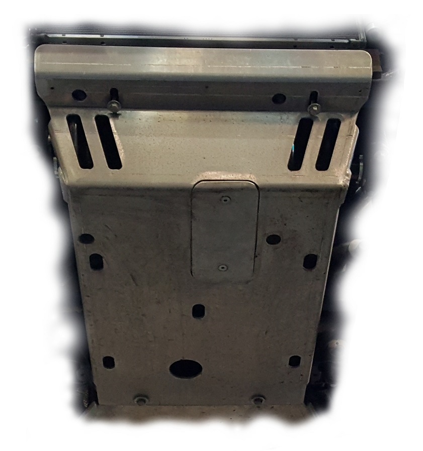

I have these skids on two of my trucks. Perhaps I can help. In the am I will take pictures for you if that will help.
Thanks....post #4 illustrates my install issue. Front seems to line up with factory holes, but the middle holes hit up against factory bracket bolts, and the rear slots don't line up with factory mounts but do to existing holes..

Do you think you're supposed to remove the tube brackets under the KDSS swaybar and use the non-threaded hole in the crossmember at the rear?
You might be on to something. Looking at your pics again, I can see where the slots in the standoffs would work, Once you have the fronts bolted up, the rear might extend back far enough to be able to utilize those non-threaded holes.

With the way it was setup, it looks like I have to remove the bolts from the tube brackets and then use new bolts via the standoffs to those holes.
Then I have to use the holes at the back instead of the factory mounts...the included hardware package didn't provide any hardware/nuts to make that work, which is why I questioned it.

Doesn't look like I need I need remove tubes, just back bolt for potential reuse with the standoff.

This is correct, the rear uses the supplied long bolts and nuts and goes through the un-threaded holes in the cross member. The stand offs go in place of the short bolt at the radiator support. the support stays in place.

Jeff, it sounds like perhaps you are missing some hardware. The new skids cannot mount like the OEM because they are designed differently for more protection. It sounds like you are missing the two 4.5 inch bolts with nuts for the rear of the skid. Something Chris can amend when he calls you.
[MENTION=64685]TOY2G[/MENTION], can you post some pictures of the skids as mounted? It sounds like the tubes stay in place, but the back bolt that attaches the tube to the crossmember gets threaded through the round standoff on the skid plate and then back through the tube and screwed into the crossmember. I'd like to see how much clearance (if any) is between the tubes and the inside of the plate. I know BudBuilt's plate sits right on the tube, which is good, as it's good to maintain as much ground clearance as possible. Thanks.
