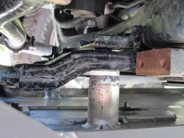

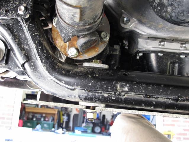

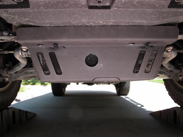

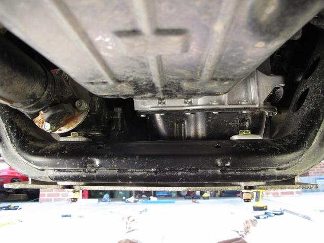

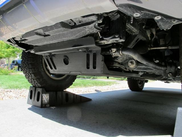

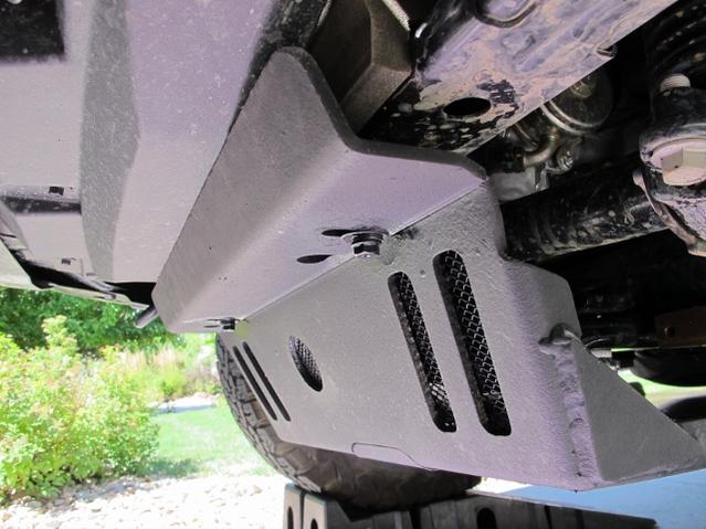

Was able to find time to install the front skid. I did add the screen behind the holes in the front. The only stock mounting holes uses are the fronts. Otherwise, they use the bracket mounts for the tubes in the middle and the large holes in the back via the cross member.
My only change I want to make is to reverse the bolts in the back so they don't stick down so far and find a button head type of bolt instead so it is less likely to catch on a rock. I notice the RCI skids have a welded on bolt protector I wish these had. I did have to trim the plastic piece between the radiator and skid. Otherwise, the skids look sturdy.

Excellent...thanks. Just remembered my bolts are 1/2" diameter and these washers only go up to 7/16...the bolt head would probably be too big as well. Guess I could step down in diameter for bolts with a grade 8.
Reverse those bolts so the heads are on the bottom. I think you have them upside down. Then get one of these:
If you drag those bolts on rocks in their current configuration you'll damage them so bad you'll have to cut them off.
If I have to take any skids off after wheeling and the bolt heads are damaged, these sockets get them off no problem. Those protector washers are expensive as hell and I've heard they can get packed with ground up rock and grit and then you'll never get those bolts off. Same with button head bolts. The allen key socket gets damaged and you're SOL. Also, get on McMaster Carr and buy quantities of 25 of so of the bolts you need in Class 10.9. Cheep, and you can throw out the damaged ones if you need to take them off.
I put the back ones upside down on purpose...mainly because the bolt on the drivers side was pretty close to the driveshaft flange.
Thanks for the info.
You're welcome. I would still turn them around. The front driveshaft on our vehicles won't move while driving so the bolt shouldn't be in danger of hitting it.
