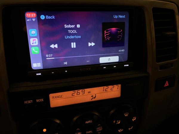

I recently installed the Sony XAV-AX5000, is this what you are looking for?
