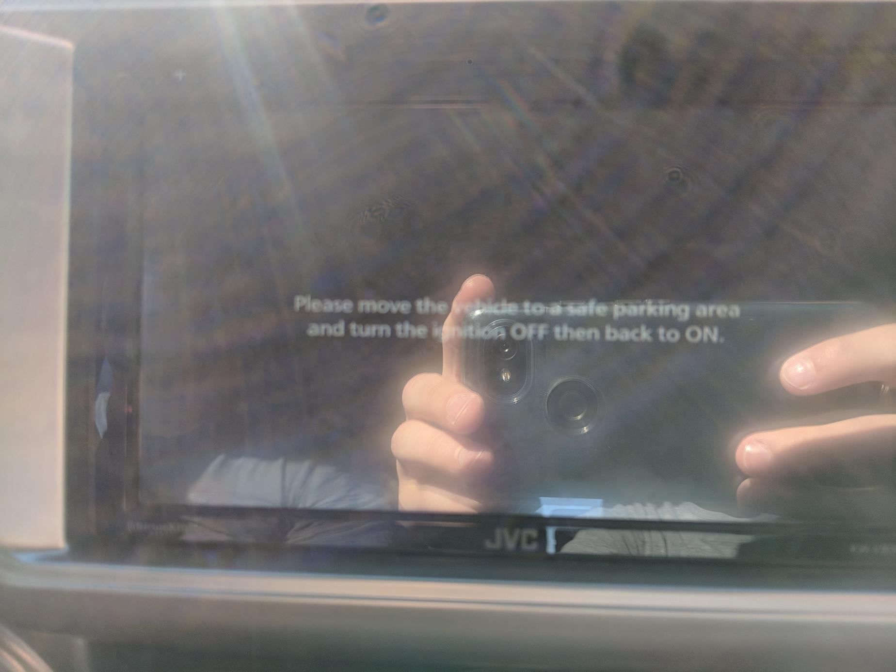

Has anyone had an issue with a aftermarket deck randomly power cycling. I just upgrade to a JVC KW-V830BT, I've gotten everything else working, steering wheel controls back up camera. I am thinking a better power source then the factory harness might be needed. Any help would be appreciated.

The OEM power source is just fine. You try updating firmware?

Loose connection?
I had the same deck in my 4runner for 3 months, no issue with a Maestro harness using stock wiring. I updated the firmware right after the install.

Yeah has the updated version on it already, even went and got a new deck thinking the first one was bad. Second one is doing the same.
Is your wiring harness adapter soldered or put together with crimps? Most of the time I read about a problem like this, it's because of a bad crimp or use of quick splices.

Yeah we used crimps, was what I was thinking just had it rebooting again today. Got this screen, now I am wondering if it could have something to do with ground wenput in place to allow DVDs to play while driving. Sorry for the bad pic.

This is a pretty easy thing to troubleshoot. Pull the stereo out and with it on, give the harness a jiggle and see if it causes a reboot. Even if it doesn't, I might suggest soldering the power and ground wires.
