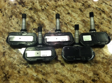

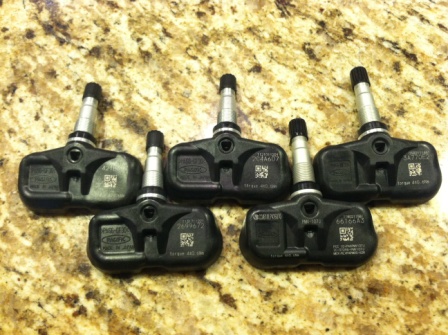

Well, I took the plunge after posting a few days ago about this.
Ordered 5 sensors from americantpms.com
I think they were $40 a pc, free shipping. They are the Pacific branded(OEM) sensors. The 7 digit apha-numeric code is printed visably on each sensor. I fired up Techstream and put them right in with no problems. They are not in the wheels yet tho:) I plan on having that done in the next few days. The interesting thing is.....of the 5 I ordered, there are 3 different variations....all Pacific, all Made in Japan. One actually came wrapped up in bubble wrap w the red n white toyota part number and barcode on it. Just thought I'd share for anyone else in same situation as me.
