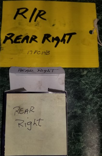

It's not the weak battery causing the problem. I had all 5 tires off the T4R and I had given the tire store instructions on which sensor went in which tire. The tires were labeled with a tag; location on vehicle and sensor ID. The boxes with the sensors were labeled with tire location.
