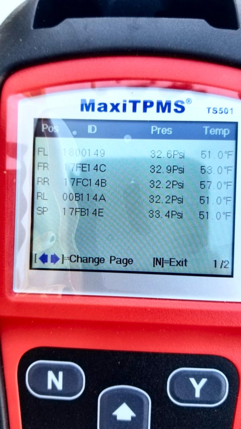

I have the Autel Maxi TS501 and it will scan the DENSO sensors and give you the ID numbers as part of the output. Are you sure your Foxwell won't do that for you?

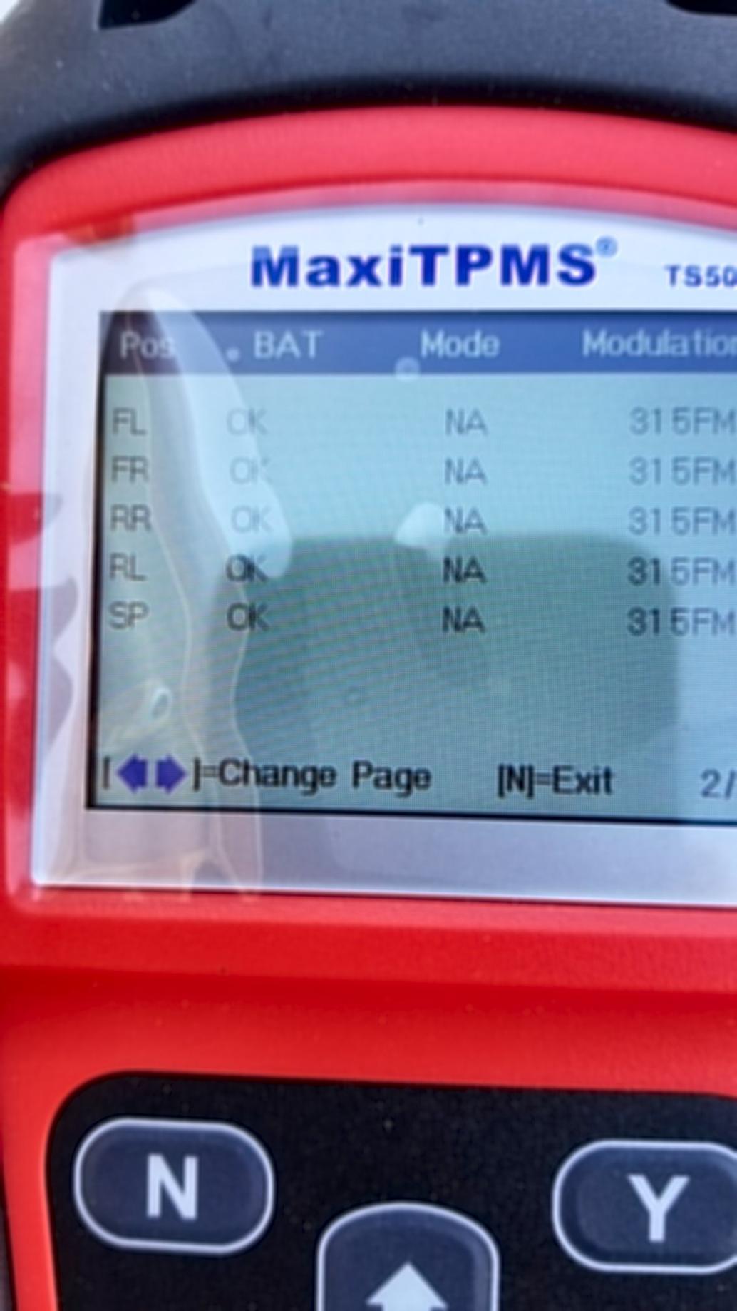

Here's what the scan looks like for my T4R.
