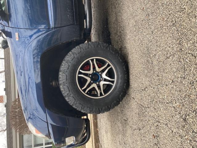

I have also purchased a set of American Racing AR893 rims, 17x8, for my recently purchased MT tires. I got them at Walmart for $160 each, and I saved another 5% via a credit card promotion.
Here’s a pic of the American Racing rims. I have since installed the center caps:

I was in the same boat as you, with OEM rims in bad shape.
I bought two different sets of 5th gen rims on eBay, both around $500-$550 for 5 rims. The 7-spoke rims are in my signature line photo.
(The pic got rotated 90° for some reason)

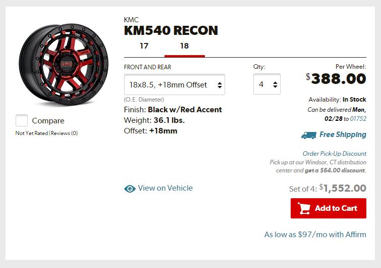

I am considering these. It is difficult to find 18" rims, 7.5 or 8" width, +15 to +20mm offset, 139.7, 6 lug 137.7 bolt pattern. Most wheel websites don't know the 08 Limited has 18" tires.
Anyone know about KMC quality?
A friend of mine has a set of KMC wheels on his Tundra, for as long as I've known him; atleast 10 years or more of winters in Calgary, Alberta, and the finish still looks good.
It's probably reasonable to expect they are at least as good as the average of the market.
