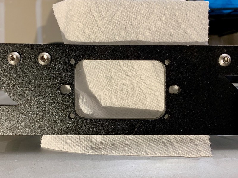

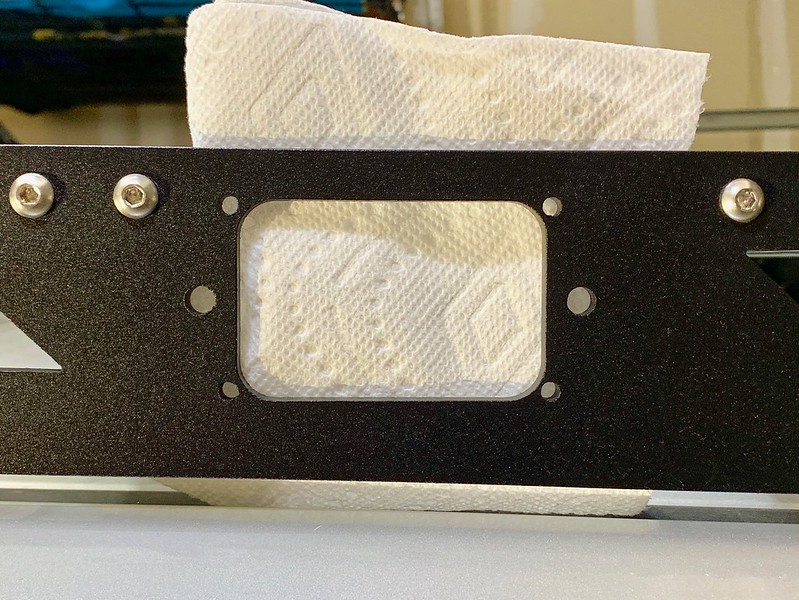

I got the passenger side lights wired up the same way as the driver's side so nothing really new to post about that but I took some pics fo the side rails modified for the Aurora lights.
Before and after (the paint was freshly applied and still wet in the after picture.

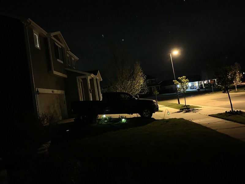

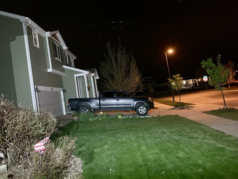

If possible, can you upload a photo of the rack lights in use at night?... to see how much srea lighting you are getting?
I've been out of town for 3 weeks. I finally was able to grab a couple pics of the camping lights. Both pics are via iphone Xr with the camera resting on the door panel against the driver window. They put out a lot more light than necessary.
Yep thats a lot of light!!

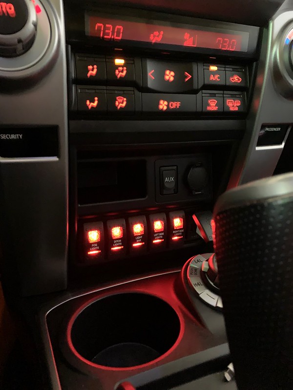

I don't think I ever posted this, but here's the color match on the switches in the interior.
The top light goes on when the switch is activated and the bottom light goes on anytime the ignition is activated.

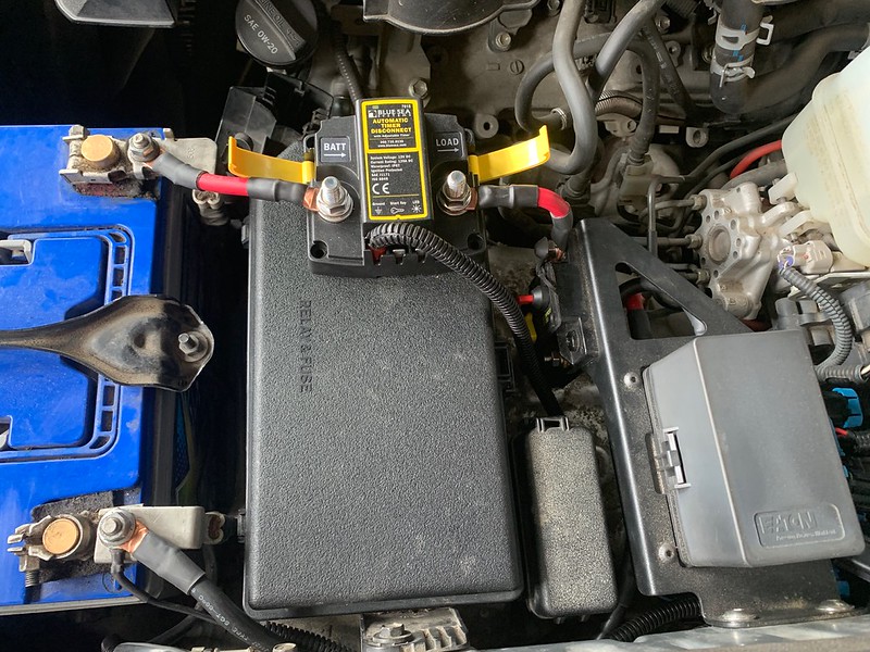

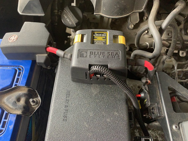

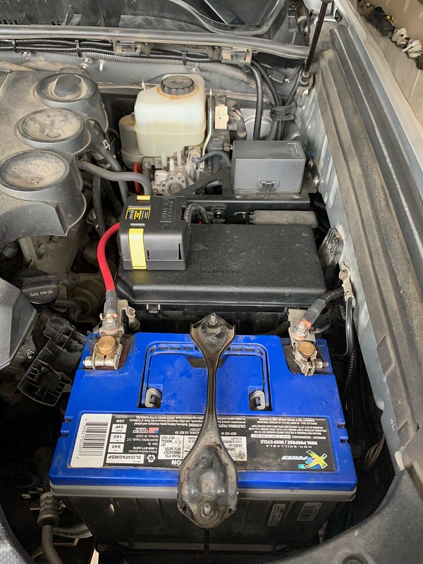

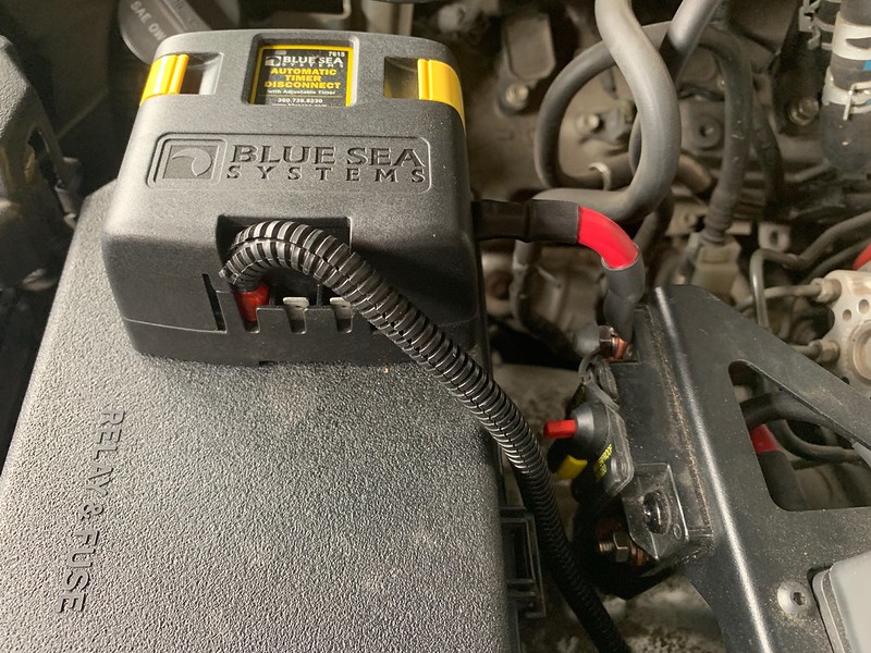

This is where I mounted the low voltage disconnect.

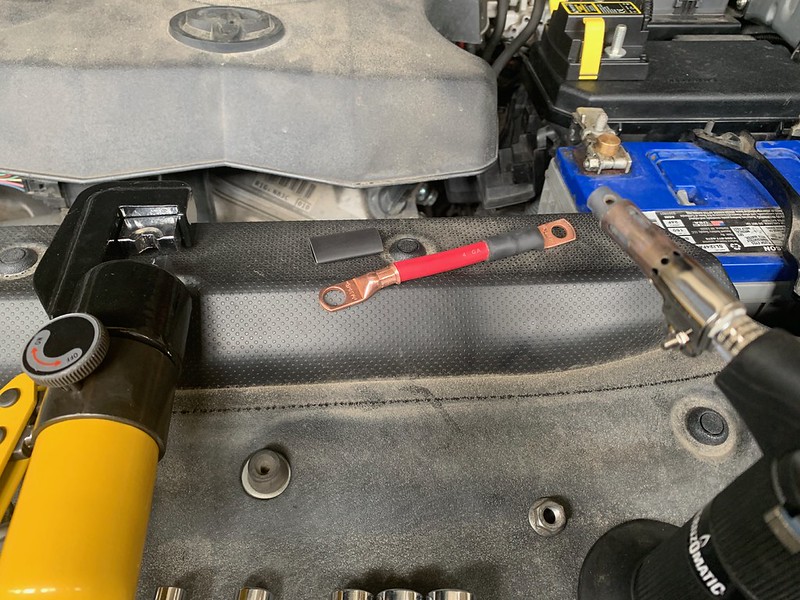

I gave it a ground connection and cut the existing power wire from the battery to the breaker and ran the disconnect inline. Like before I used closed-ended terminals and marine grade dual wall adhesive lined heat shrink. Heres the load side to the breaker finished.
A 10 ton hydraulic crimper with the proper dies makes for some very secure connections.
Cables are done.
I notched the positive protective cap for the wire off the battery and it's finished.

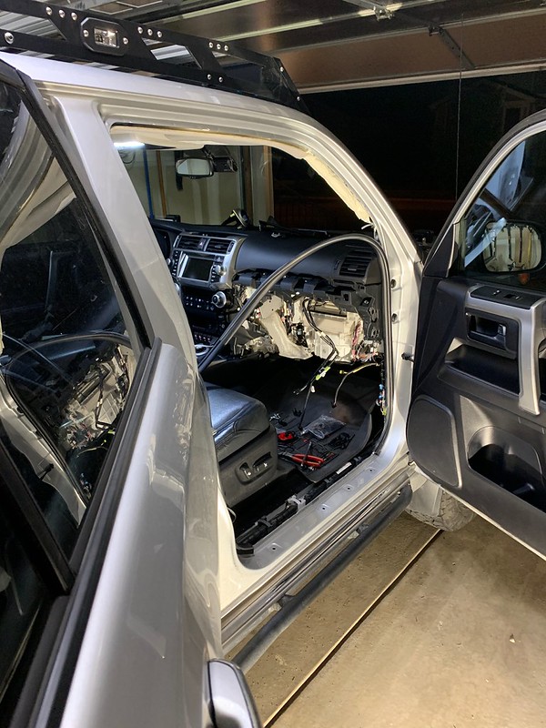

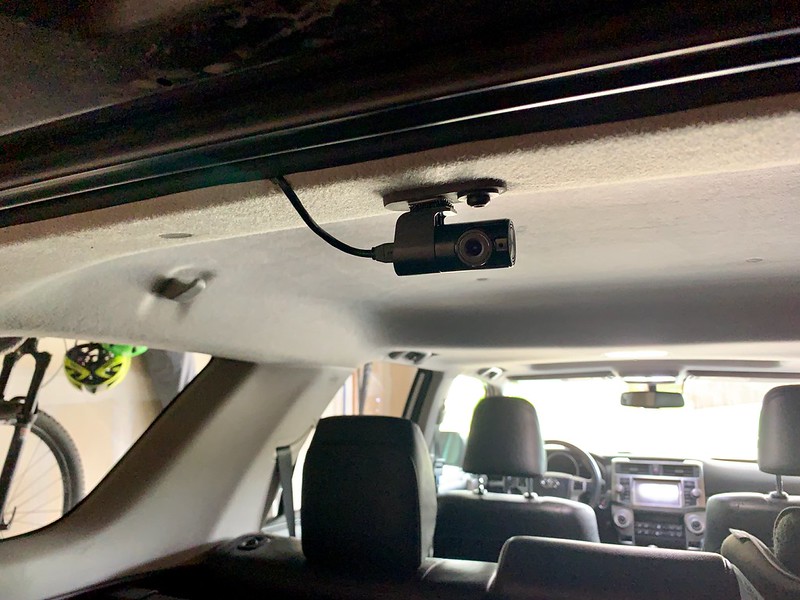

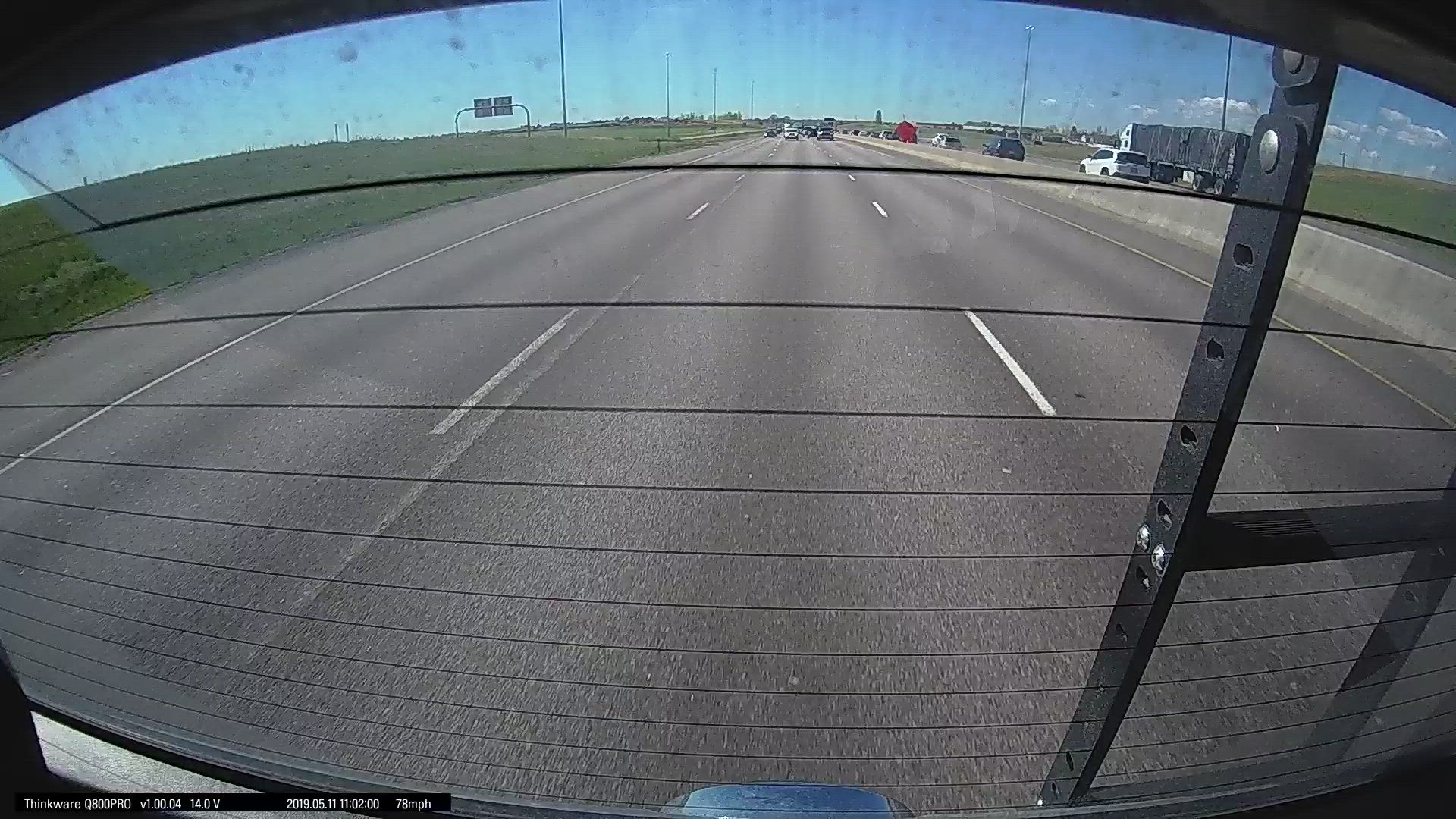

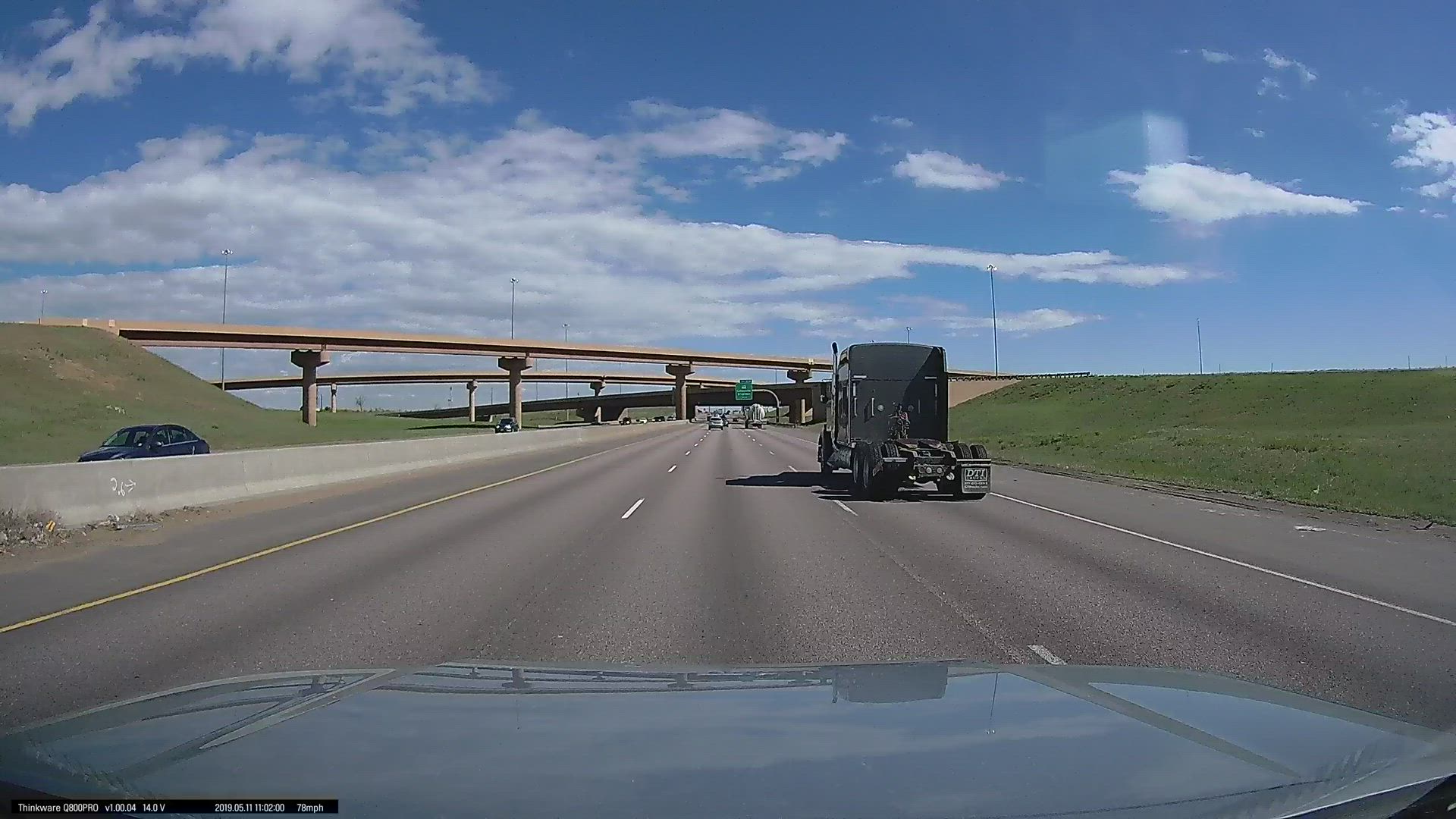

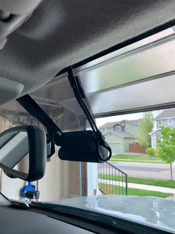

Thinkware Q800-Pro 2 channel dash cam with a hardwire kit for parking mode. 1440p front cam and 1080 rear cam with more bells and whistles than are really needed.
Making sure it’s a neat clean install, one thing often overlooked is to make sure cables are ran BEHIND the side curtain airbags, just poking the wire up under the edge of the headliner is not good enough.
Front
Rear with a custom mount I made.

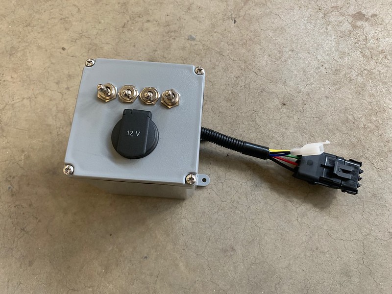

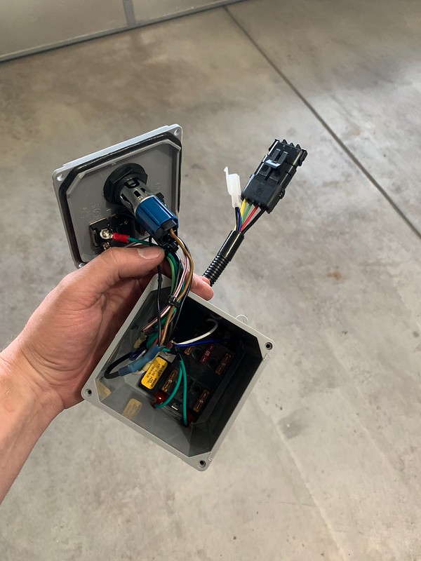

Yesterday I built the rooftop tent box. I still have to make the harnesses to connect it to the truck though. I changed up my plan a little bit. The circuit up to the roof rack is built to handle 35 amps. I’m going to use the drivers side camping light circuit as the power and ground for the whole box. Power goes in, it’s split by into 5 circuits with a small fuse block. The switches laid out left to right is left side camping lights, red tent interior lights, white tent interior lights, then right side camping lights, plus an always hot 12v power outlet.
[MENTION=196768]Agent_Outside[/MENTION] that box is pretty cool. I was thinking about doing something similar for camping lights as well. are you planning to install double relays so nothing happens if you somehow flip that in tent switch as well as your dash switch?
I want to make it as simple as possible so you have to switch both switches.
I put connectors at the front of the roof rack on both sides, without the tent box hooked up the dash switch’s control the lights. I can disconnect that connector and plug in my tent box in series. So at that point with the dash switch on power will go to the tent box, and then the tent switch will power up the lights. With the box installed both switches have to be on to have light, with the box removed the dash switches alone control the lights.
