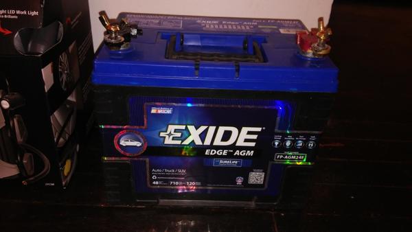

There are two that I've used, "see below":
433f6f5e749fe08c1f9f98383b37687e.jpg~original
...and...
I'm using the "Odyssey Extreme", and my wife's Camery has the "Exide Edge"! Both (IMHO) are just as capable! Here's a description of the Odyessy Extreme in my 4Runner: https://www.toyota-4runner.org/2012950-post1.html Best to you,
